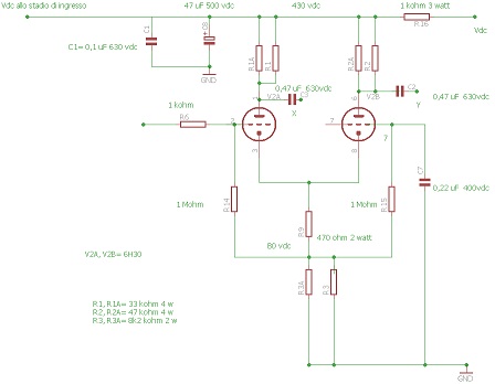

6H30 as a driver by far the best of the crop if works as it should. It has more grunt than needed. At 175V/16mA can swing 200V peak-to-peak into 12-15K with low distortion (mostly 2nd harmonic).

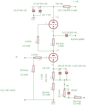

I suggest the e88cc in srpp as gain stage then a long tail with 6h30 to drive the grid of power tubes
Good swing and low thd

The problem with the 6H30П (6n30p) is lowish μ. 🙁 The type makes a superior LTP, in a Mullard circuit, given its high gm. A Mullard circuit employing a 12BH7, with the sections in cascode, as voltage amplifier and 6H30П as LTP should be tuneable to yield a satisfactory small signal gain structure.

Regarding the splitter the use of ecc88 and 6H30 is fine
In attach the schemas; they are working very good also on lab test.
