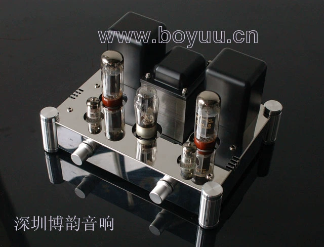

DF96 you are right, I have amp B (got it as a kit ) and only half the rectifier is used. So It is cosmetics.
here the schematics :
12AX7 / EL34 SE amp kit | SarALeila
Regards
Alex
Regards
Alex
No, if the circuit given in your link is correct then the vacuum rectifier is doing a proper job. It forms half of a bridge, with the other half using silicon. This is a standard technique, as it avoids having to have a secondary CT as they did in the old days.
The circuit is fairly basic, but nothing too much wrong with it. It is an improved version of a 1950s radio set audio stage. I would add a coupling capacitor between the volume pot and the first grid stopper resistor, to keep any grid current away from the pot. At least they have included a grid leak resistor too; some people omit this.

A failing rectifier will cause a drooping supply rail, which you might not notice at first. Eventually you will get less power and possibly more distortion.
The coupling cap depends on what bass rolloff you want. 0.1uF might be OK.

I own the SE EL34, GDAP-01, for 1 year now it has been playing on a regular basis during that time. I replace the EL34 tube with KT88, the combo works quite well except you have to replace the EL34 cathode resistors( 4 units) with higher power ratings at least 4 watts.
THe GDAP with KT88(std. version) sounded quite good, you can get about 10watts per channel. With efficient speakers, the sound stage is very wide and sound very open. I fully recommend this amplifier. BTW I am not associated with the company or the product.
You can buy it from this site:
Shuguang,Shuguang treasure,Fullmusic,Guiguang tubes,amplifier chassis,tube sockets,capacitor,resistors,coil meters,toggle switches,tag boards,transformer covers,various parts for tube guitar amps diy <meta name="keywords" content="tube sockets,shugua
for only US$200 plus postage
very cheap, you cannot buy all the components alone for that amount.
Inside the amplifier is very well made go to this site for some photos, scroll down to see the images.
