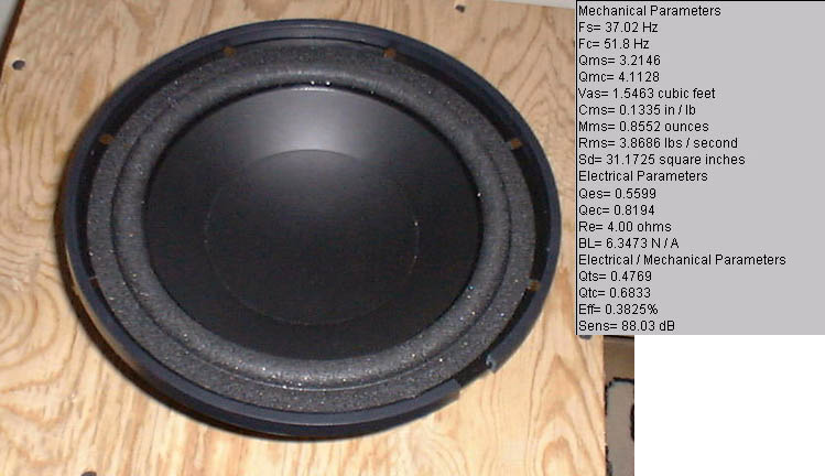

these are the 8" drivers i got, and i would like to use for something...
