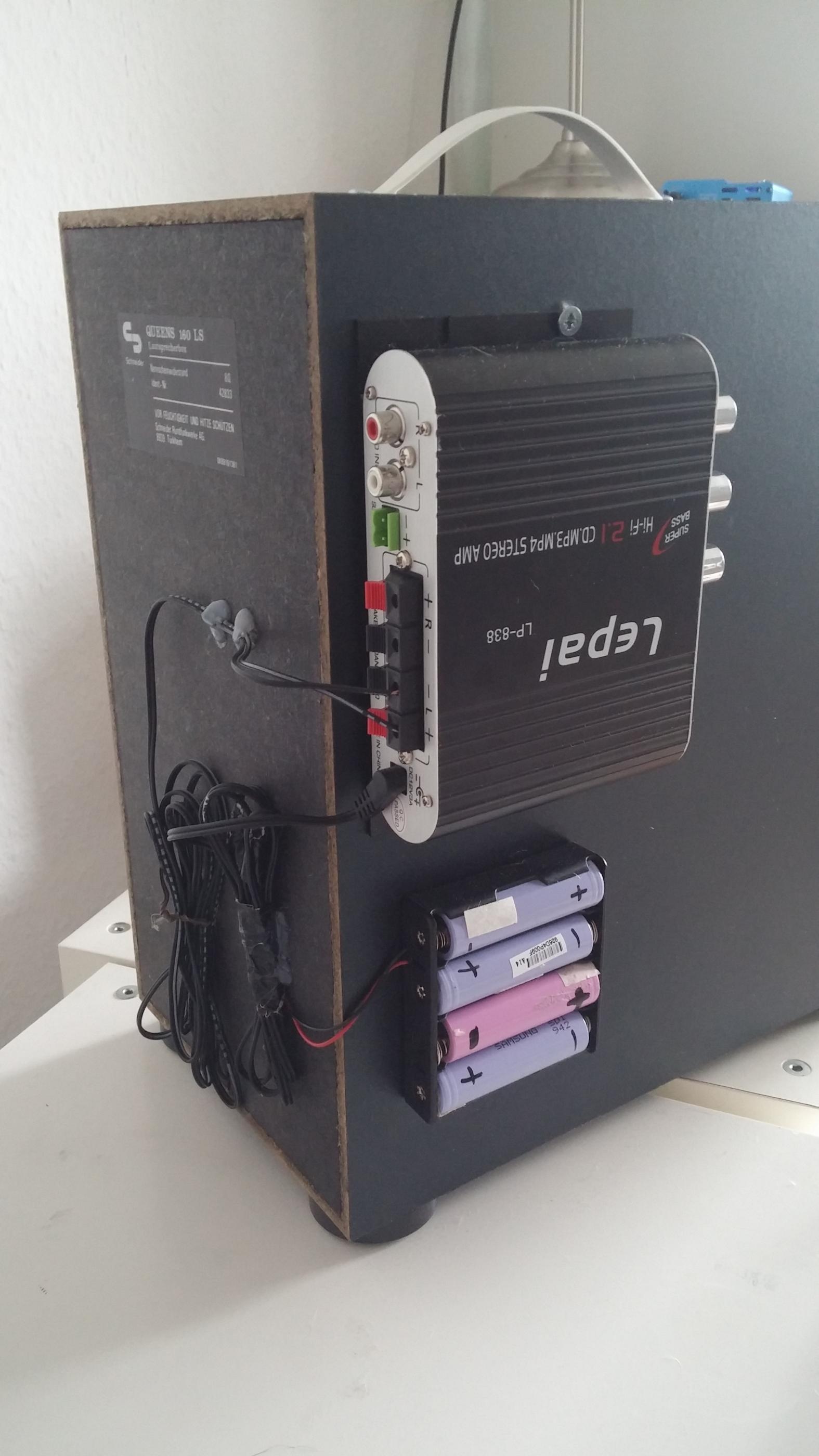

USB Powerbanks are generally LiPo-Cell based. If it has 3-4 cells (usually all 6.000mAh+ Systems) you could open it and remove the cells (they usually contain 18650 battery cells with 3,7V each) and put them in a row instead of parallel- you would get 11,1V (with 3 cells) or 14,8V (with 4 cells) from it directly which is enough voltage for a nice output. See Attatchment picture! 18650 battery holders for 3- and 4- in a row are available on Ebay.

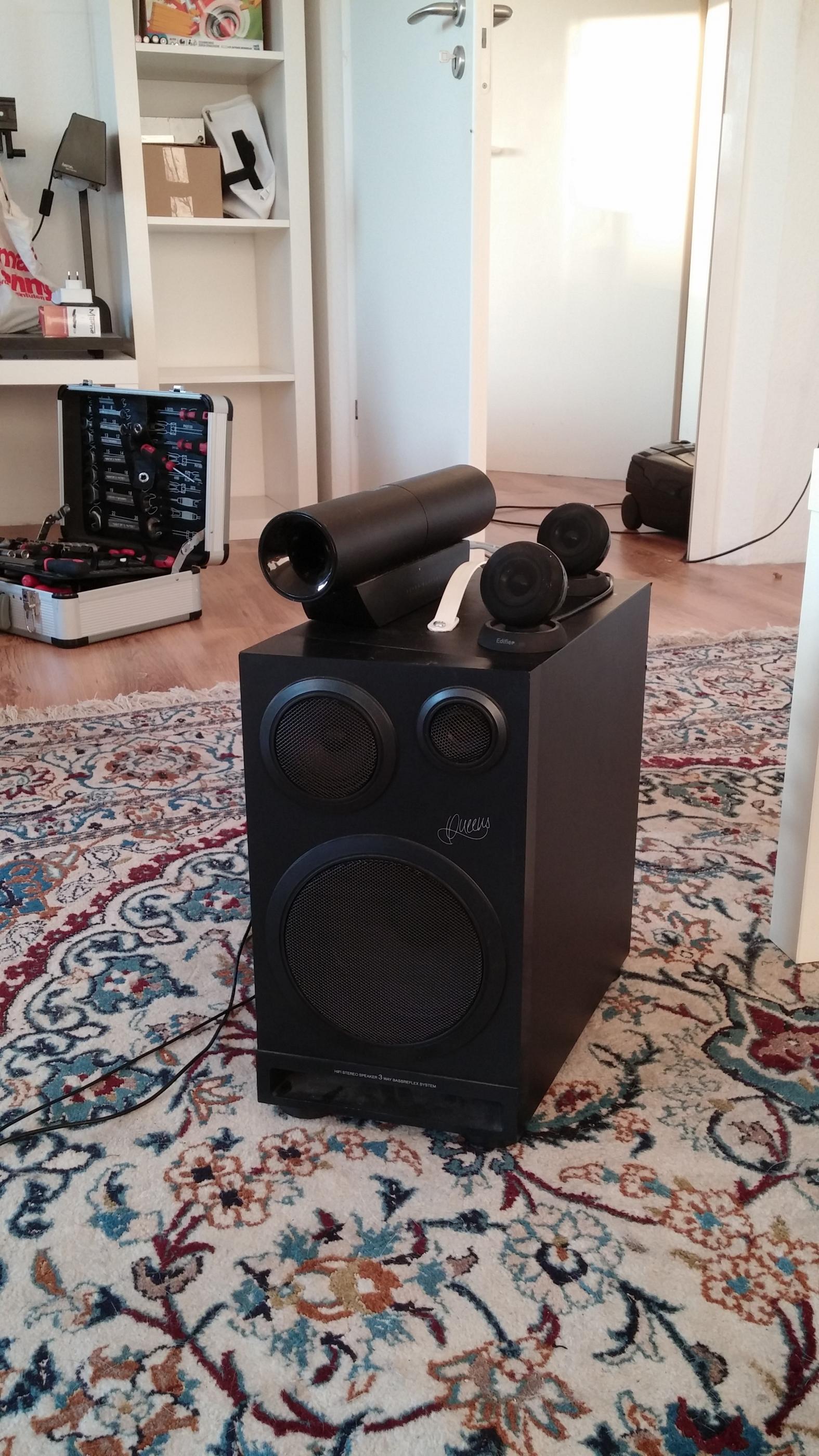

If you do that, you could keep your powerbank as a charger for your cells - i've done that as you can see in the picture - worked nice, depending on loudness and speaker impedance&effectivity 3-9 hours. You can get easily more than 2x10W clean RMS output with them without any need of step up booster or capcitors.

Another option for battery powered systems and very easy and cheap would be Lepai 808 - it doesn't sound as nice as the TK2020 or TK2050 boards boards but also not bad, better than bad designed TPA3116 boards, and it's dirt cheap (~10-15€), needs low idle power and can be used up to 18V if I remember correctly - so it does also work with 4 18650 cells in a row and comes ready in a case.
