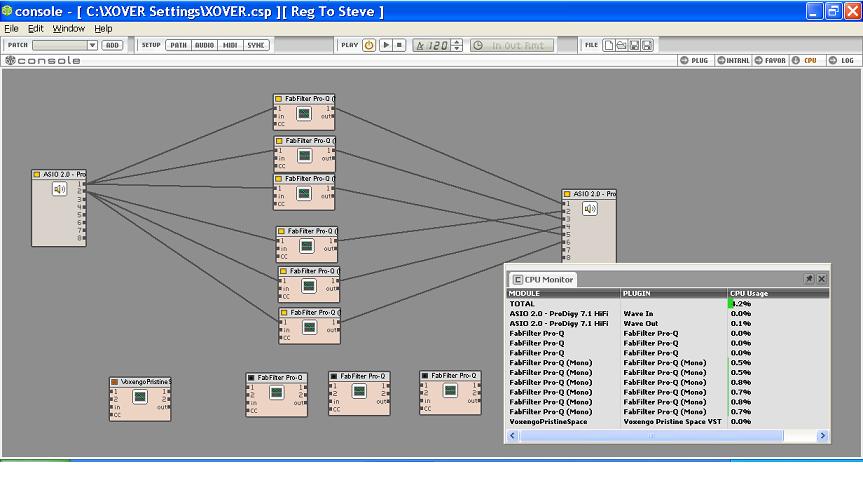

audiotrak prodigy 7.1 hifi - great card only works well with xp though

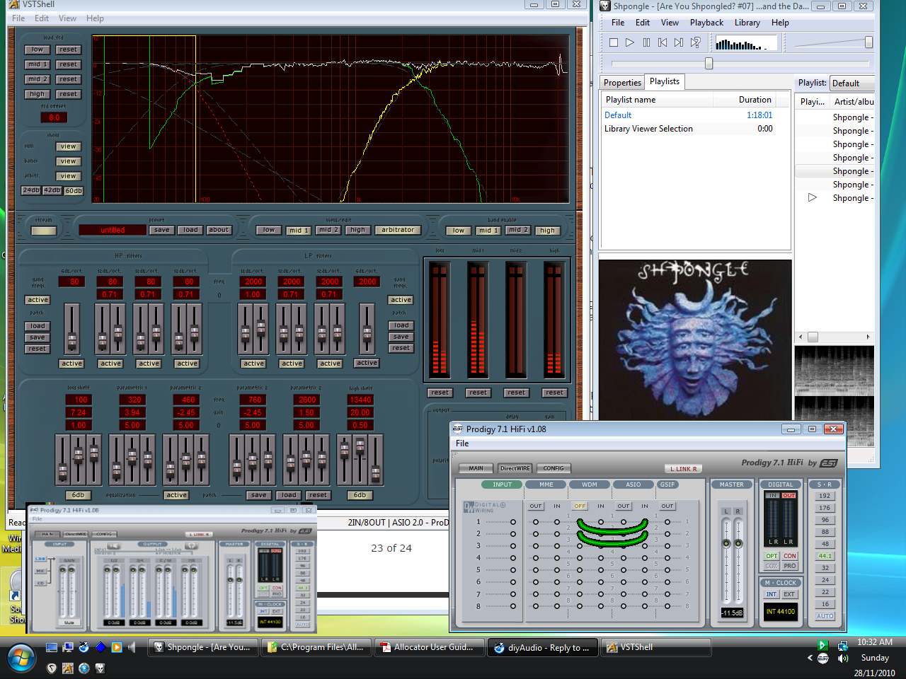

I now have a working setup based on an ESI Prodigy 7.1 Hifi (formerly Audiotrak).
Crossover = Allocator.
Player = Foobar.
Allocator uses the Prodigy ASIO drivers.
Foobar uses ASIO4ALL or KS/WASAPI.
Internal Routing on the Prodigy card is used to send the sound coming in from Foobar (WDM) out to the Prodigy ASIO drivers where Allocator intercepts it. All sounds from the PC will go through the crossover.
I should be able to record impulse files (based on sine sweeps) using Rec_Imp as that uses ASIO4ALL and that is treated the same was as KS/WASAPI, coming in on the WDM line in the Prodigy routing.
In the routing the WDM OUT is turned OFF and wired to the ASIO IN. This means all sounds go through the crossver, unless set to use the Prodigy ASIO drivers, so only Allocator will use those drivers - quite simple really.
I wish my Xonar had internal routing.
Pros:
- It just works...when it works. Which is does once you have it all setup and don't fiddle.
- No need for external routing software such as console/VAC/Reaper.
Cons:
- 96khz doesn't work. 44.1khz and 48khz work, at up to 32 bit (24bit padded).
At 96khz the audio is all scratchy, I think the Prodigy ASIO drivers are faulty, they don't seem to buffer enough samples. This is not an Allocator issue, it happens when playing directly from Foobar or JRMC to the Prodigy ASIO drivers at 96khz.
- The Prodigy Hifi drivers are wickedly unstable. I must have gone through 50 BSODs in the last two days. Once you have it working it's fine, but changing sample rates, or bit depths usually results in a BSOD.
I can't comment on the sound quality yet, so far I am testing with 3 pairs of PC speakers. I'm ready to transfer over to proper speakers now (focal driver MTM with 4 x 15" Tempest IB sub).
It does work, and it was actually pretty easy...apart from the BSODs.
I've bitched to the ESI support e-mail about the ASIO 96khz issue and the severe instability of the drivers....I'm not holding my breath for a response..
