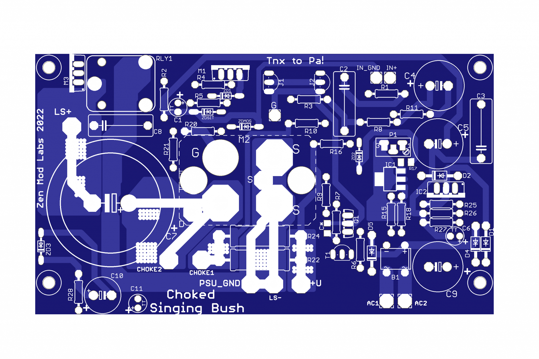

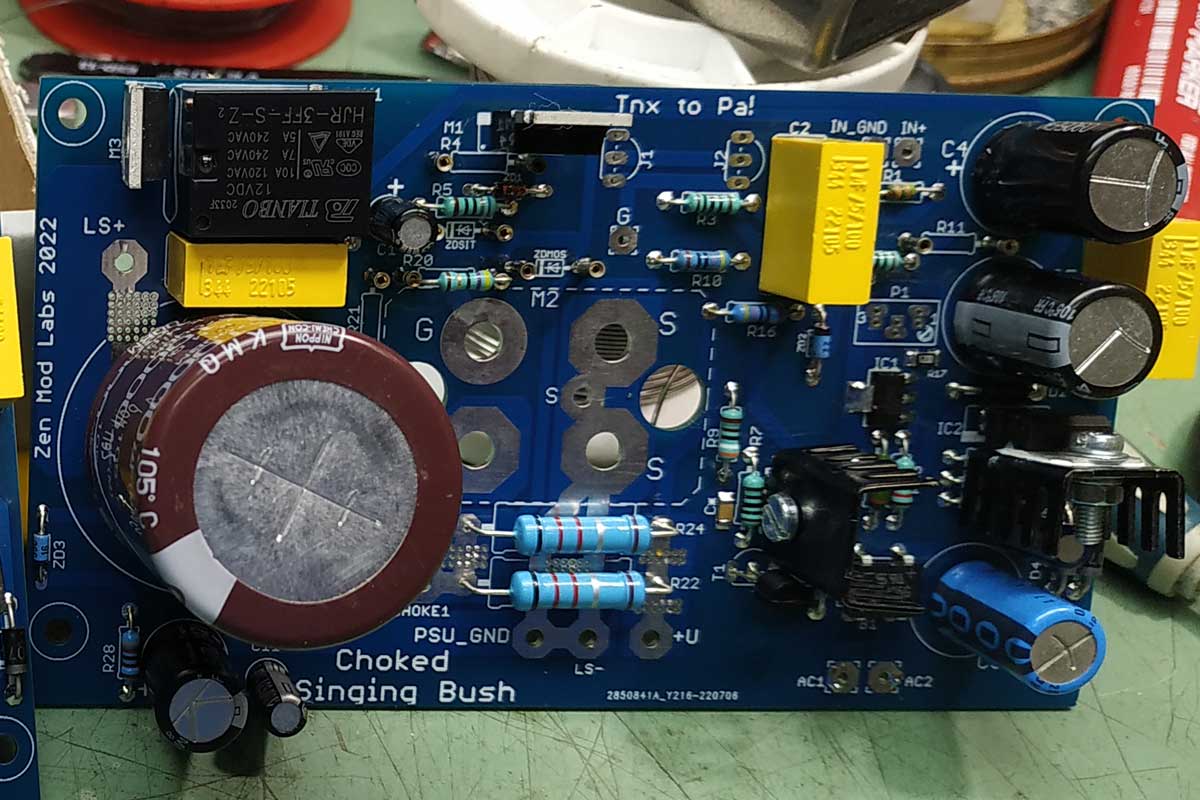

OK, this one long in making

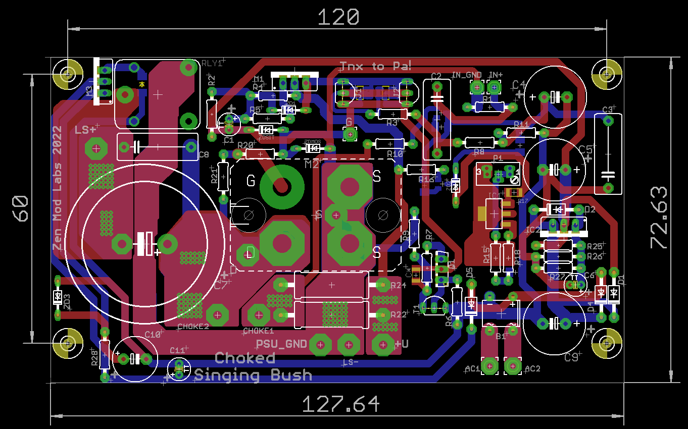

I mean - have pcb files and everything for some time, basic functions confirmed but - as is my nature - never working by plan

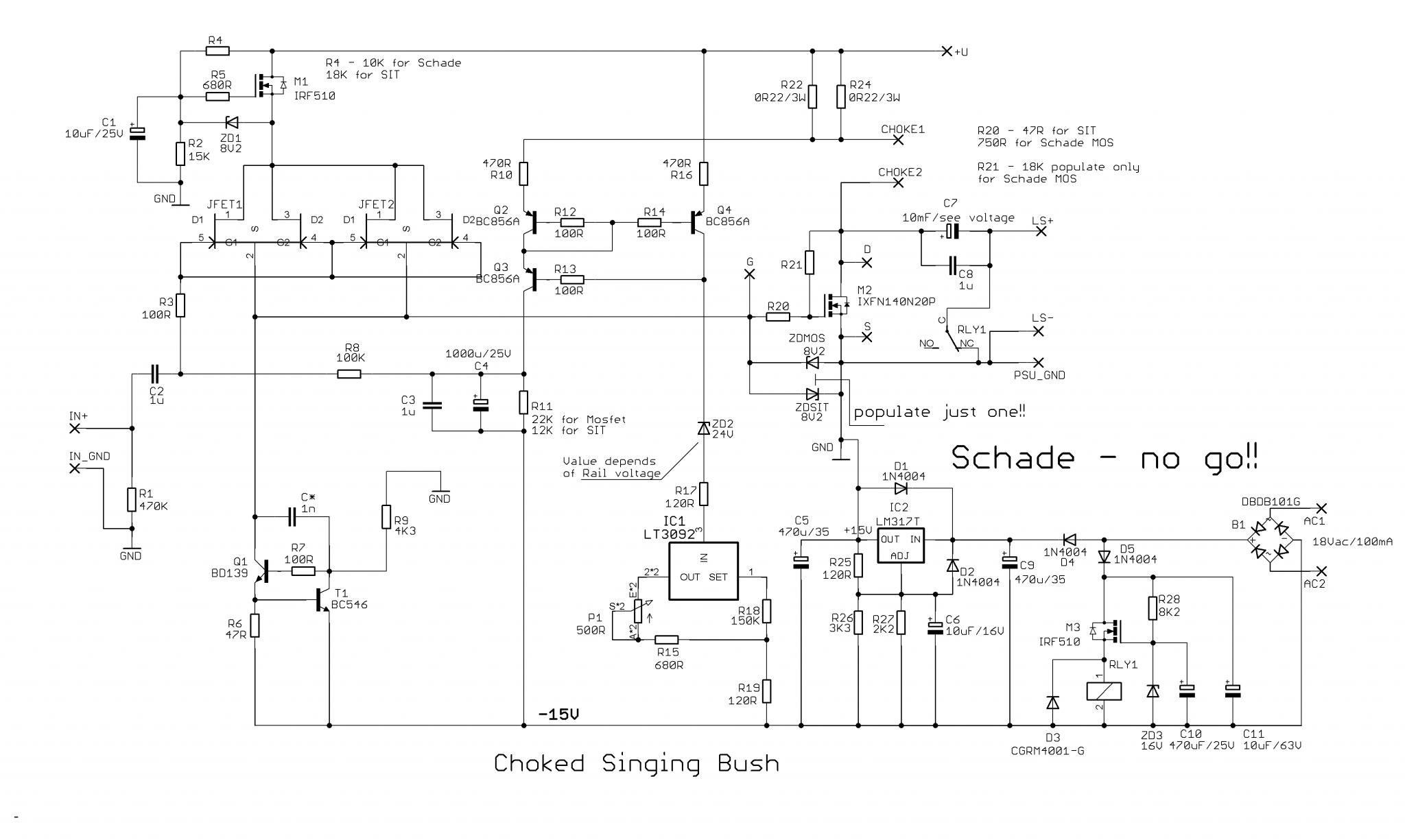

Anyway - why Purists and Masochists?
List of reasons:
1. you really need properly made high quality choke; 100mH, no more than 0R5 winding resistance, declared for 3A5dc (big Tokin) or 2A5dc (small Tokin)
2. PSU - bummer - heavy filtration; CLC, or C then cap multiplier followed with heacy C cell, or fat switcher ..... most likely also followed (by choice or necessity) with some sort of high-pass filter and followed with fat C cell
3. this time ( even if evidently intended as option) - no Schade Mos Puck; simply too high Rout of part itself (even if normally or even heavy Schaded), resulting in uberfunny transfer function and THD way too high; now - with all my crummy chokes (yes, Plethora of them but all crummy) that's the situation; there is a possibility that Schaded option is viable and worthy if adequate quality choke is used, but that I can't confirm, nor I intend to purchase it, in any way or arrangement
4. looking at all above - simply - cost; you gain something with lesser volts involved (vs. say "regular" Singing Bush) thus lesser heat and lesser Donut and lesser voltage caps and lesser Aluminum in sinks...... but then main choke, PSU choke, yadayada....
5. yes, OPT is an option, for both shown iteration ( Big Tokin, small Tokin), don't have it, easy to try if you have one; same conditions as with choke - do not even try with cheaply made Iron
there are few more reasons, worthy of this list, but I'm lazy to think now .....
Anyway, usual set of introductory eye-pleasing files:

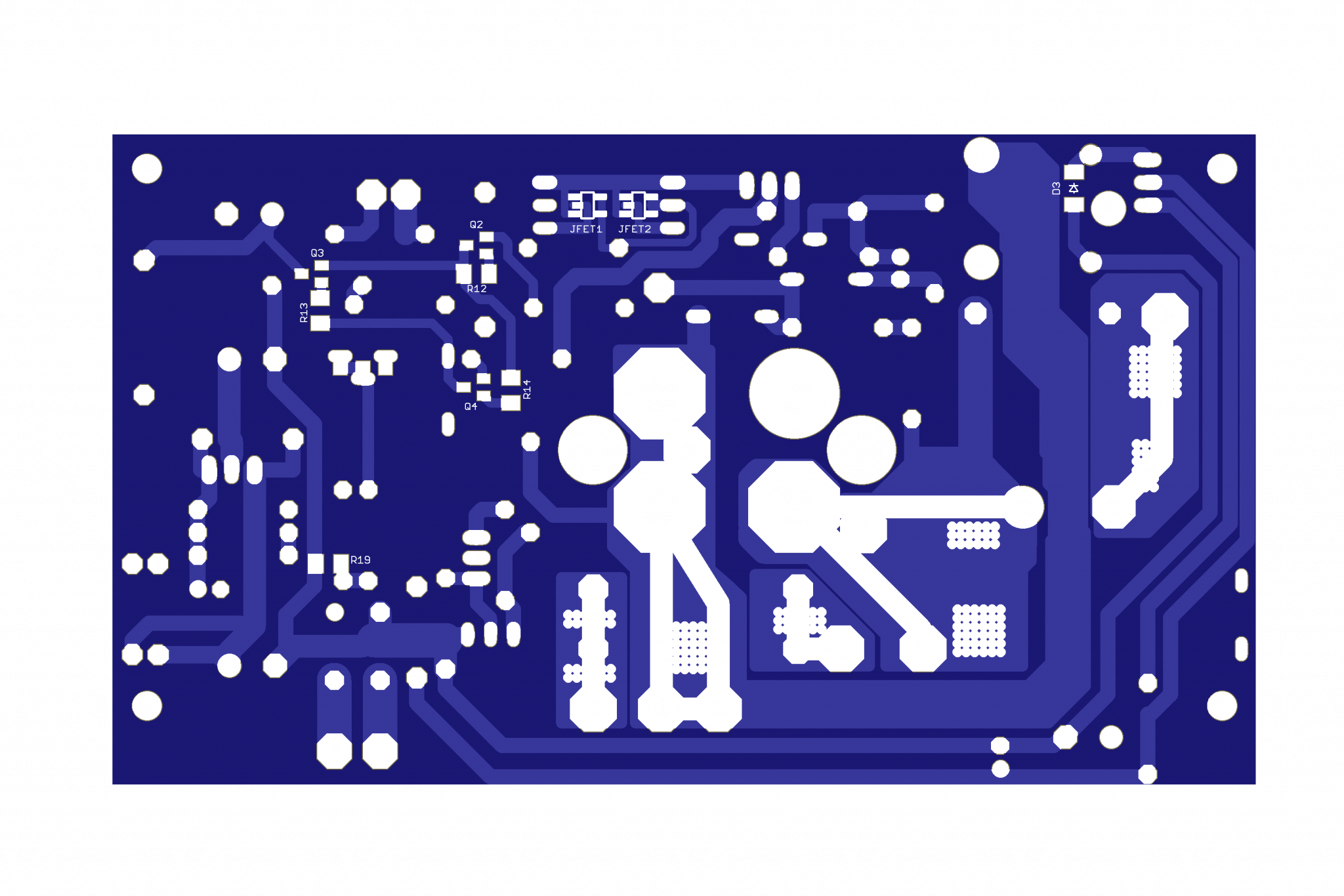

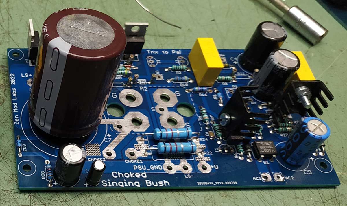

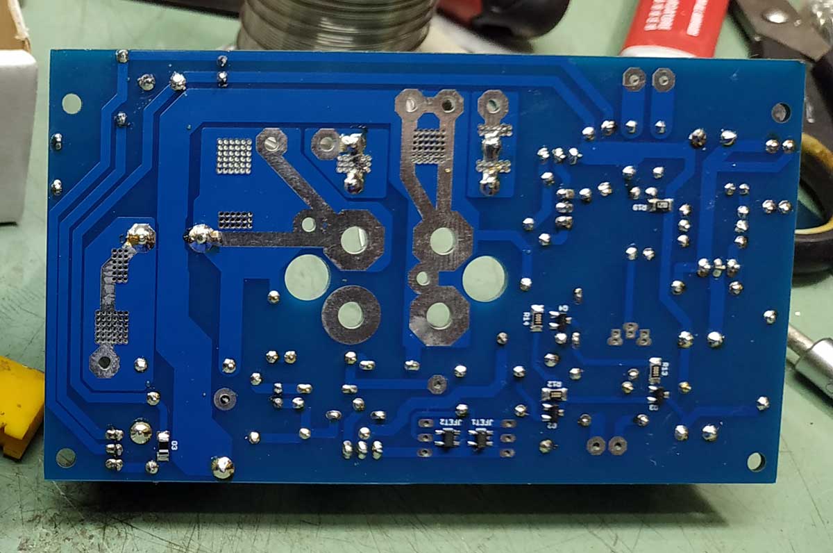

dunno is that age or what, but in last time I'm often forgetting to take phone (cam) with me in workshop, so again no proof is in da pooding pics; meaning - No Porn, No Glory for Mighty ZM, but whatever
at least these few pics I have from assembling pcbs, few days ago
will take few pics of small version tomorrow and post

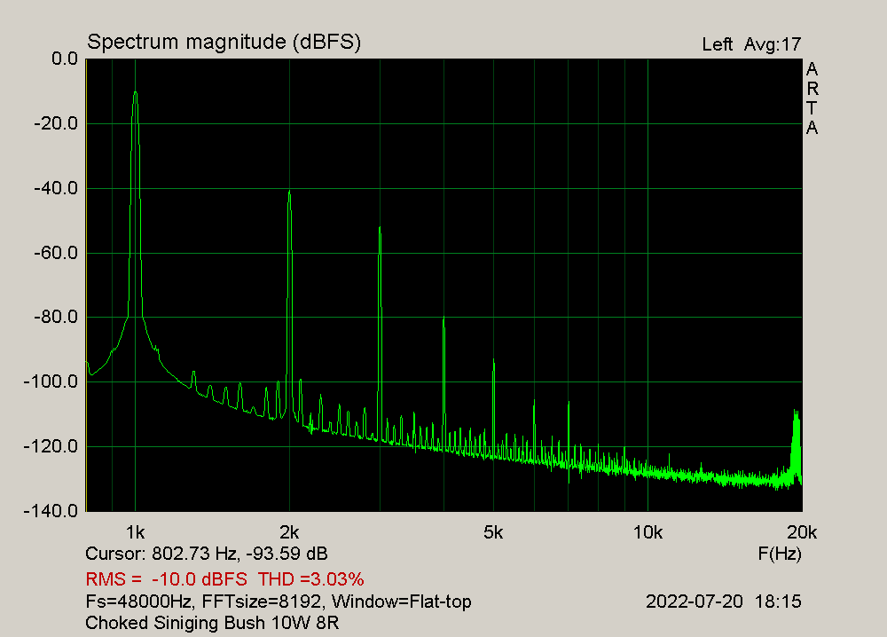

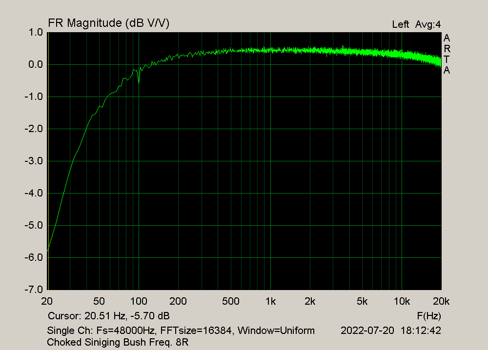

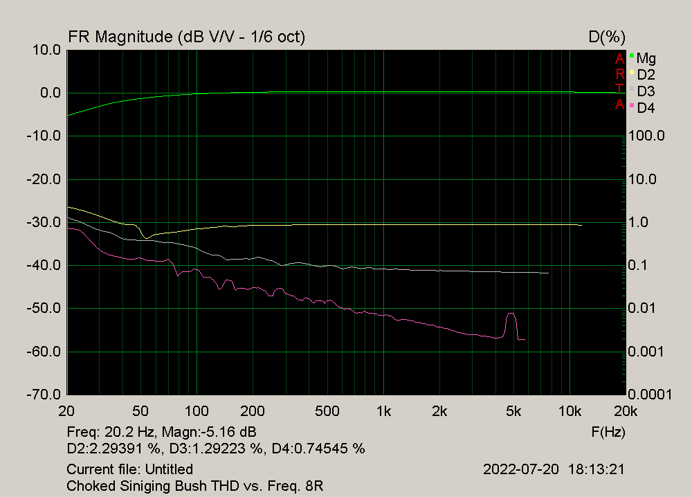

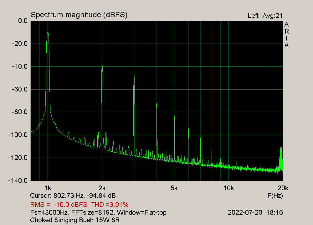

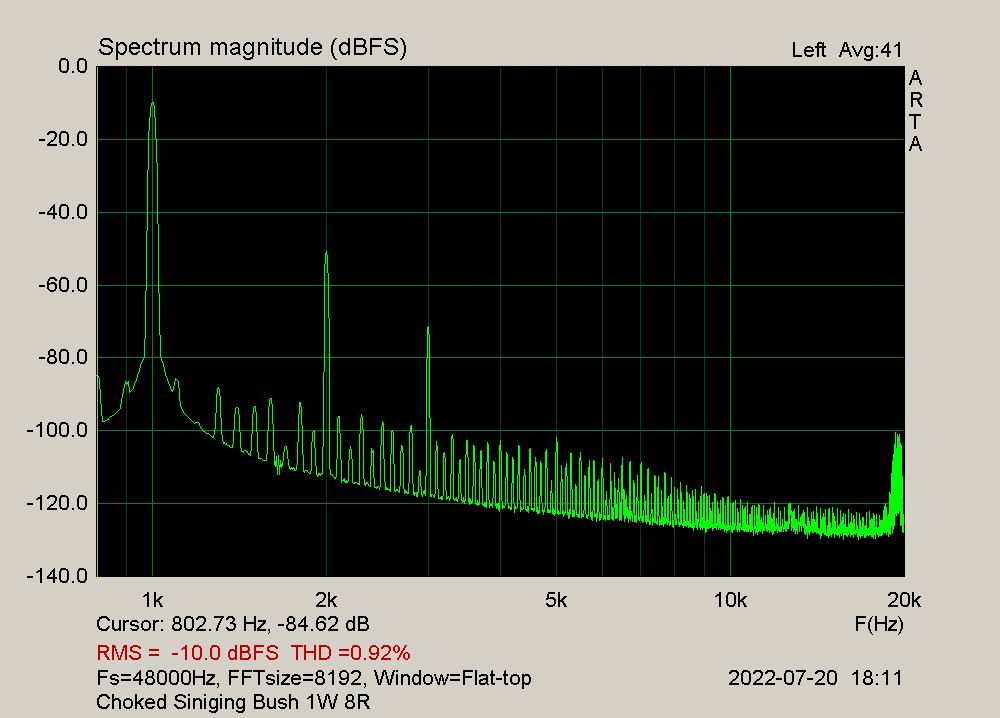

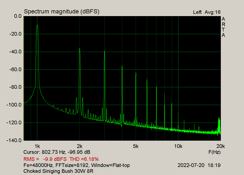

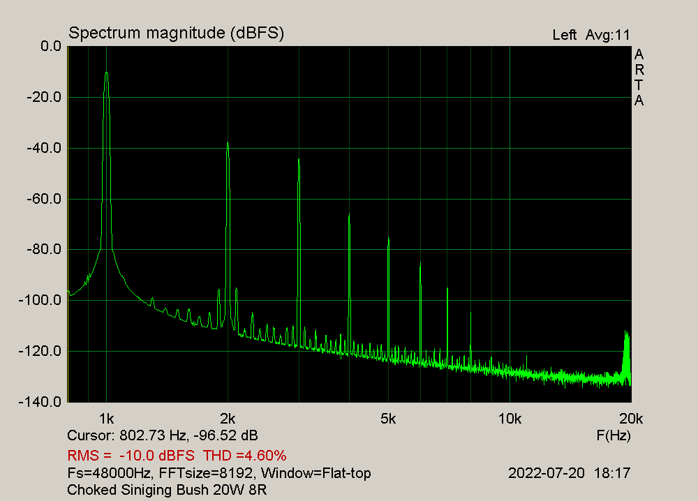

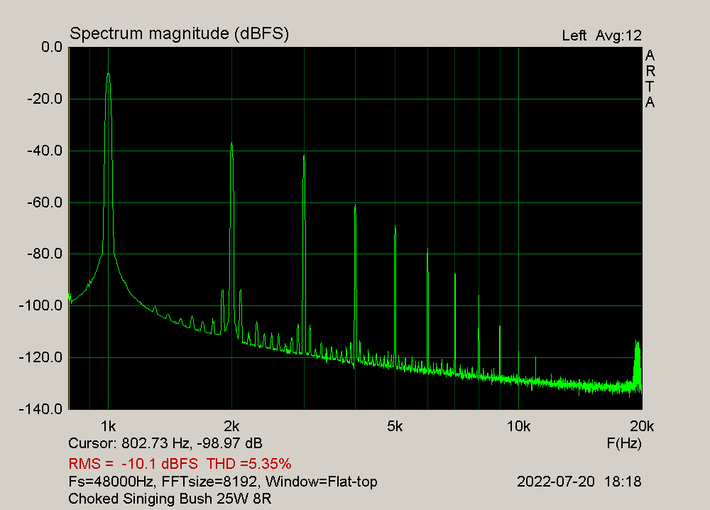

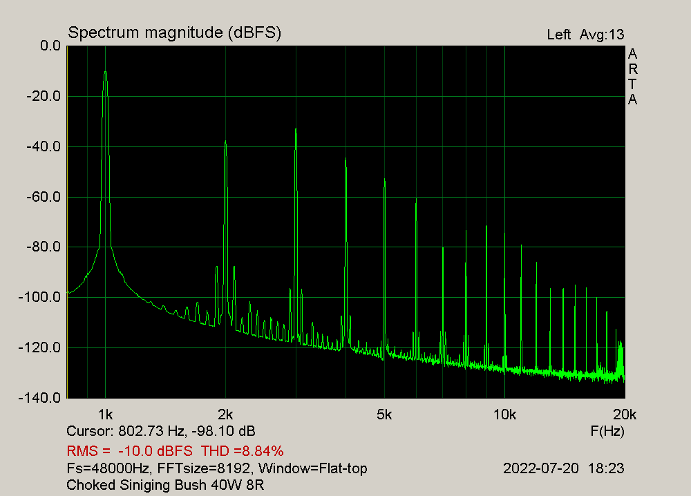

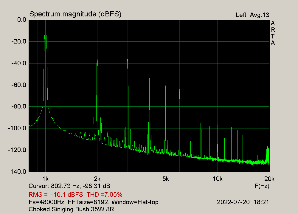

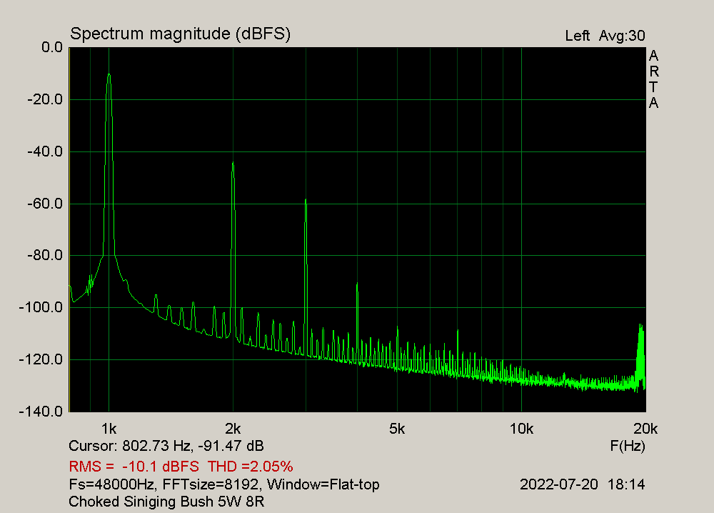

now, graphs
Big Tokin iteration, THF 51S used
rail 32Vdc-ish
Iq 3A2, rock-ooking-stable in entire power range; current mirror approach works as charm
crummy choke - 80mH, Rdc is 0R75, biiiig chunk of EI Iron, but there is no gap in core; few microwave xformers I have butchered to choke duty are even worse, by measurements
for 1W@8R, means 2V83rms, input signal is 285mV; thus gain is roughly 10V/V, 20db
load is 8R, didn't even tried 4R load, no go with this choke
again - weed down is due to used choke (no gap, lousy wound, even if thingie is originaly hospital grade mains autoformer (230 to 115, 1KW5)
anomaly around 20K is due to ...... well, really need to resort to proper connectors on in/outs of my interface box
conclusion - don't look too much on numbers - ignore weed, look at Spectra and compare different levels; if you follow list from post #1, both iterations of this amp are Full Bliss candidats - not FiFi realm, but Best Ganja Around realm
had one channel in listening today ...... heck - even if I find just one proper choke, will make one channel for Mono System :cown:

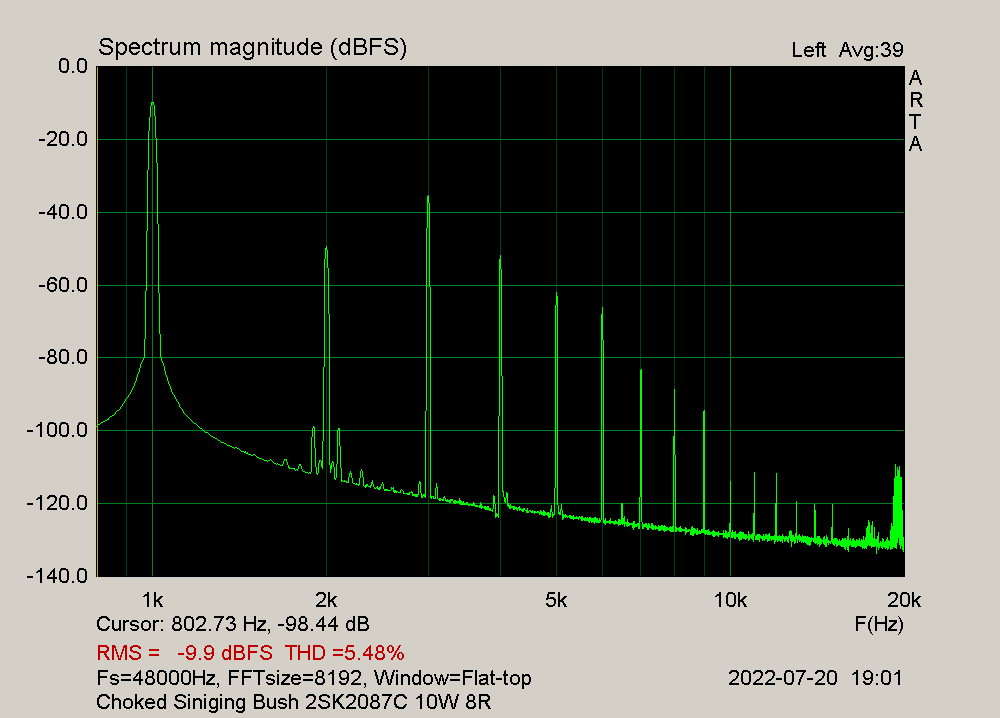

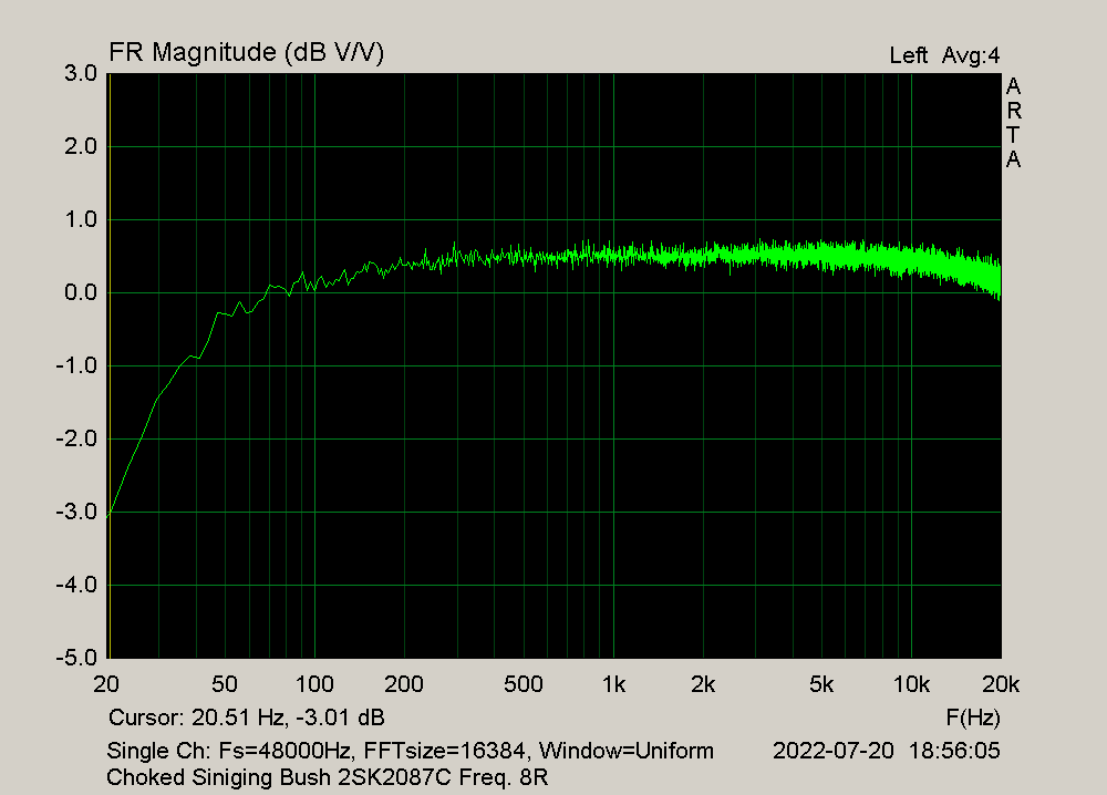

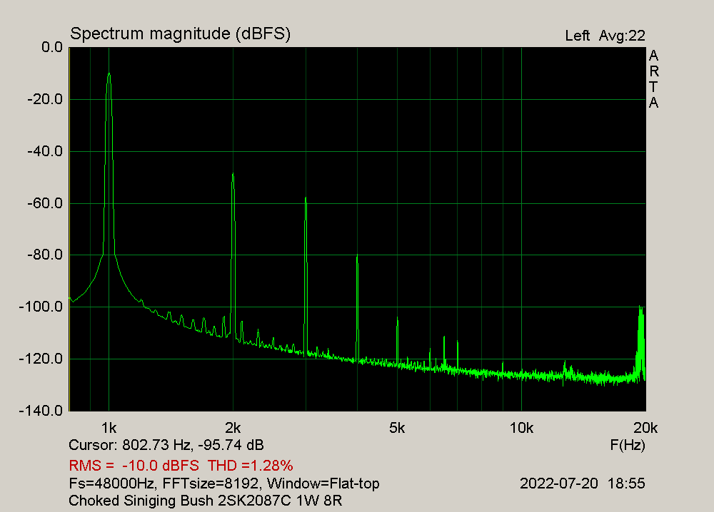

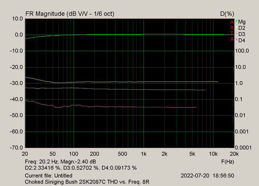

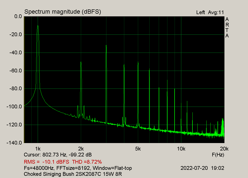

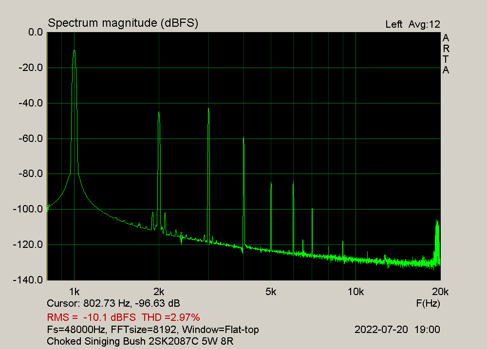

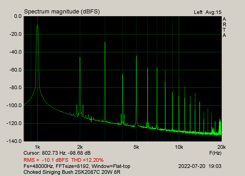

small Tokin iteration, 2SK2087C used
rail 26Vdc-ish
Iq 2A1, rock-ooking-stable in entire power range
same crummy choke
for 1W@8R, means 2V83rms, input signal is 244mV; thus gain is roughly 11.6V/V, 21.28db
same conclusion from post above applies
rail 26Vdc-ish
same crummy choke

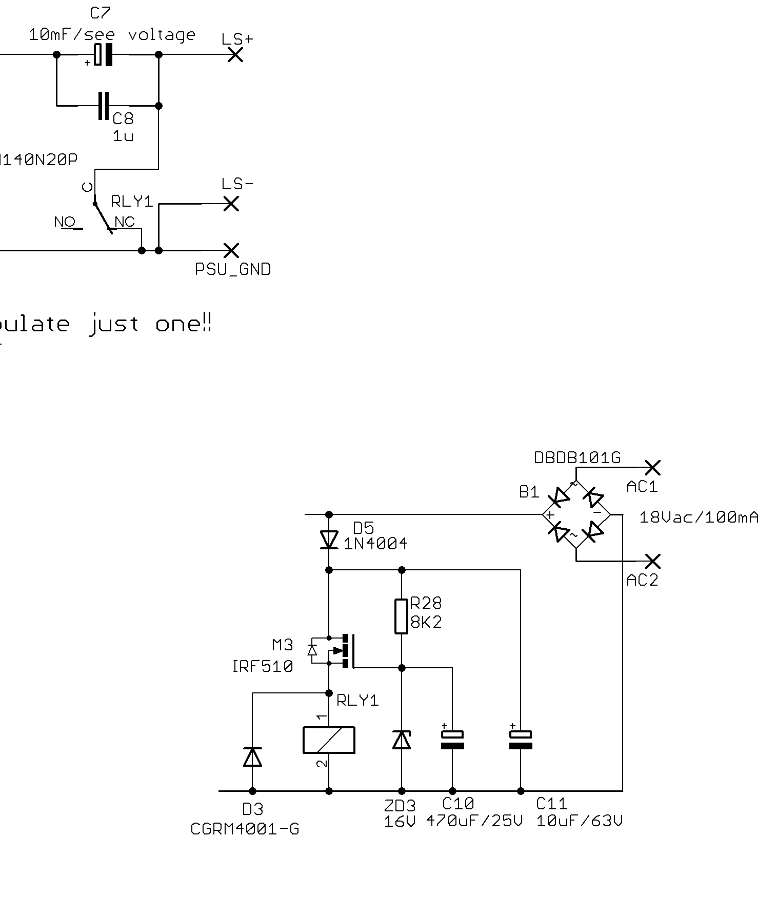

forgot to say - AntiBigBadaBoom relay circuit works as a charm - practically xeroxed approach from Papa's recent concoctions ( relay shorting speaker while output cap is charged or discharged)
during power up sequence relay is normally shorted and action is delayed by few secs; during power off sequence, relay is immediately closed
