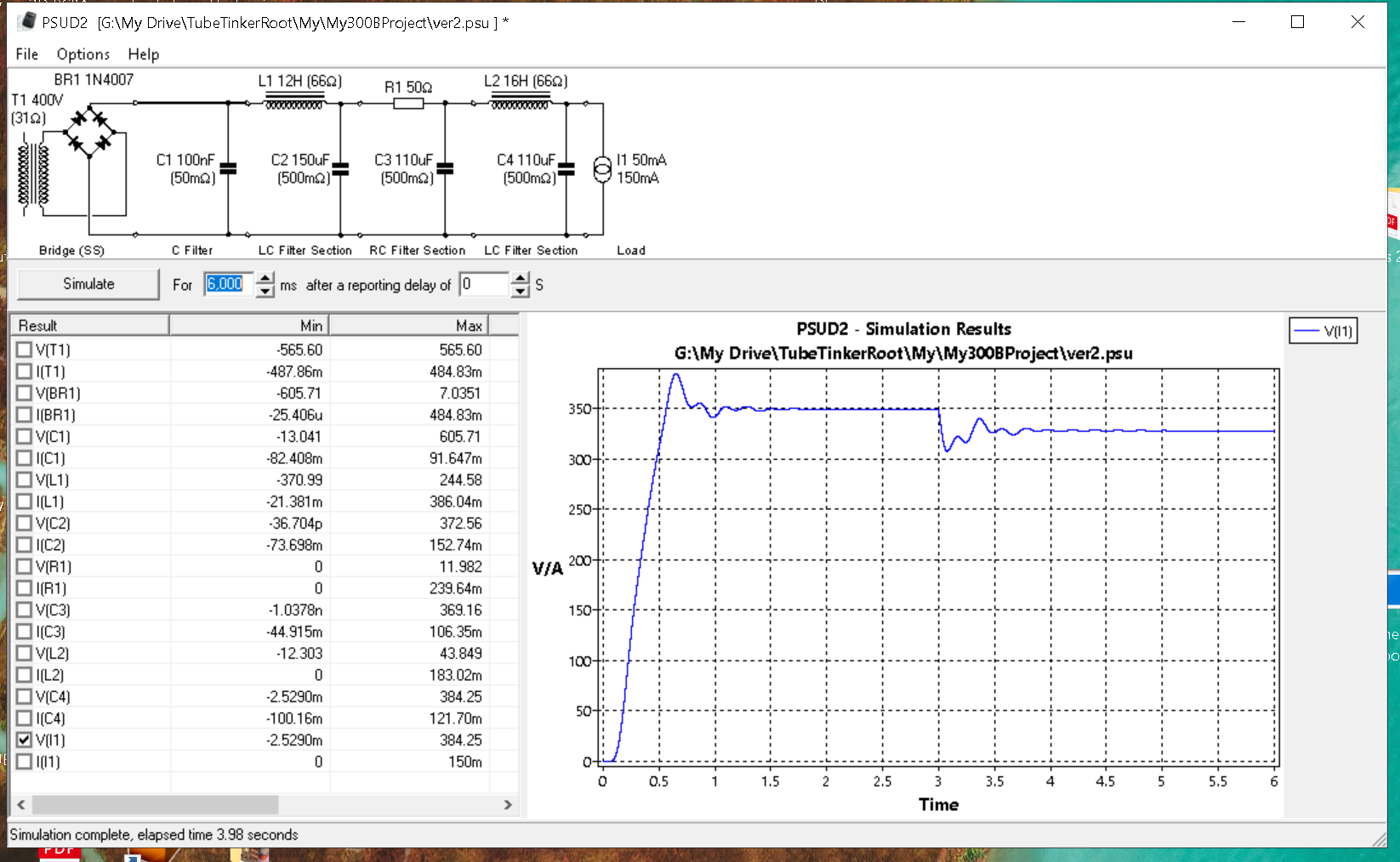

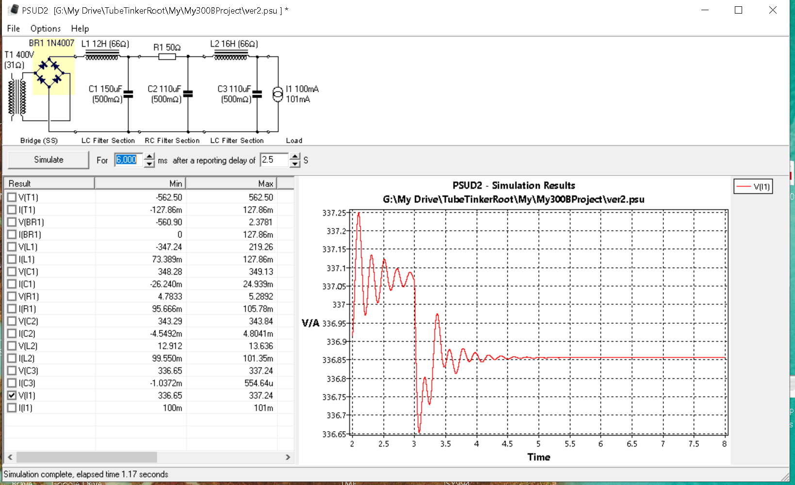

I've read here and there "get the most henrys you can fit in your chassis" when it comes to chokes. Lets say I want an LCRCLC filter, and I want the supply to be relatively stiff to around 300mA. I find a 16H 300mA choke that fits mechanically for L1, and great, I can also fit another 16H 300mA choke for L2. Why on earth would I buy a 5H or 9H 300mA choke when these 16H guys fit just fine? The Duncan PSU model shows significantly less ripple with 16H chokes. Am I missing something when it comes to compromising choke henrys against chassis restrictions? The larger chokes also don't need as large capacitors. I asked AI to compute an ideal reactance capacitor size for an LC filter at 120hZ with 16H choke, it came back with a nice 110uF, nice that is DC link territory size wise film caps. With a 5H choke it computed a capacitor size much larger which puts me into using electrolytics, which I am holding on the non-compromising side. Everything is a compromise at some point even against the mechanicals of the chassis. Should I buy these 16H chokes, or go back to the drawing board?

Use the "stepped load" feature in PSUD2 and check your supply for ringing. Most relevant part here is the last LC. Calculate values or DCR, L, and C to get as close as possible to a Q of 0.7.
