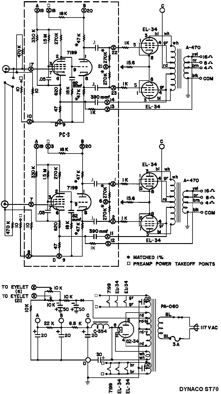

I am in need of some advice. In looking at various choices for rectifier, each tubes has specs for condenser input, or choke input. The choke inputs All require 4-10 Henry inductors, with a low value c1. My st70 has a one Henry inductor, does qualify as a choke input?
no, it is not...
this one is...
images
It's more accurate to talk about whether the circuit is "critical choke input" or not. This depends on the current, voltage and inductance. If the choke is of at least the critical inductance, you will have a critical choke input filter (lower voltage out, better regulation); if not, the filter will assume cap input properties (higher voltage out, poorer regulation).
Critical inductance (H) = Voltage (VDC)/Current (mA) is the Rule of thumb calculation.
(delete this part ->Well of course it's a choke input. There is no capacitor at the rectifier output, only the choke. It may not be a very good choke input power supply, but it's certainly of that type. Clearly, the design was intended to minimize space and cost. You can do better by installing a larger choke and filter capacitor, provided you have the room for it.)
(sorry, they drew the ST-70 schematic weird. It is a capacitor input after all.)
