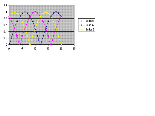

The average voltage factor is 0.954969. I couldn't find my little red book so I Armstrong-ed it in Excel... PM me if you want the spreadsheet.
Remeber, when you sum the 3 rectified phases the voltages don't add... they merely overlap... only the biggest voltage wins...
OH... this isn't RMS... multply by 1.414
