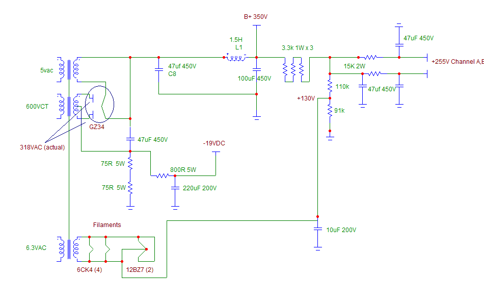

I had a choke that I ordered by mistake, so I thought I'd play with it in a cap input supply. When I modeled it in PSUD, it showed a big reduction in B+ ripple with only a loss of about 10V. So I plugged it in per the following schematics. When I did the various measurements, the voltages all checked out as predicted, but my output hum went from less than 1mv to about 4mv. At first I thought it was the clip leads strung around, so I just removed the choke and extra cap and completed the circuit with the leads. Hum dropped back to <1mv, even moving the leads around. Could the choke be influencing the power transformer?
Edit: Thinking about it, I didn't ground the choke chassis. Could this be a problem?

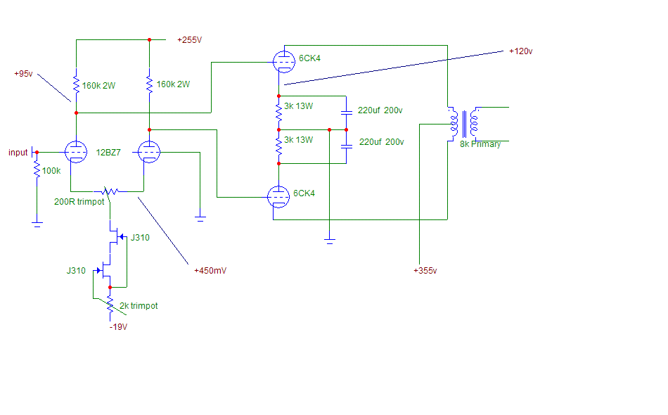

Amp:
With Choke
Choke and input cap:
Note that the only change other than cap and choke, is one less dropping resistor for the driver supply, to keep driver voltage the same. Taking this out did not affect the hum.

Hi Sheldon,
Was the supply loaded? Below a critical current the choke effect stops. At such low levels of ripple the core should be grounded and you may have to play with the choke orientation to prevent coupling with the power transformer.
-Chris

According to your schematic, it is not a Choke Input LC filter. It is just a C-L-C PI filter. The 350V B+ should be tapped after the choke.
If you don't have hum problem with the original circuit, the hum probably caused by the magnetic flux generated from the choke and coupled to the OPT.
Johnny
I noticed that the original power supply has a 100uF input capacitor. The second power supply has a 47uF input capacitor.
That would explain the higher hum level. I would move the B+ connection to the output side of the choke.
Also. 100uF is too much capacitance. Most tubes are rated for 40uF to 60uF maximum. 100uF will shorten the life of your rectifier tube.

My schematic drawing is wrong. The B+ is taken after the choke, I just forgot to change that. Sorry for the confusion.
The choke is rated for 200mA and I'm drawing about 160.
I don't think that coupling is the problem, as I just connected up the circuit with clip leads and the choke is located a fair distance from the OPT's - my first post said 10cm but it was probably more like 25cm. Also, both channels are affected the same way, even though one is further from the choke.
I know that the input cap is large. I just built this amp from a schematic in the Fi primer, by J.C. Morrison. He spec'd a 5U4GB, but I went with the GZ34 to get the proper voltage from my power transformer. So far no problems. We'll see what life I get from the tube. Actually, that part of the reason I wanted to try the choke, so I could use a smaller cap after the rectifier.

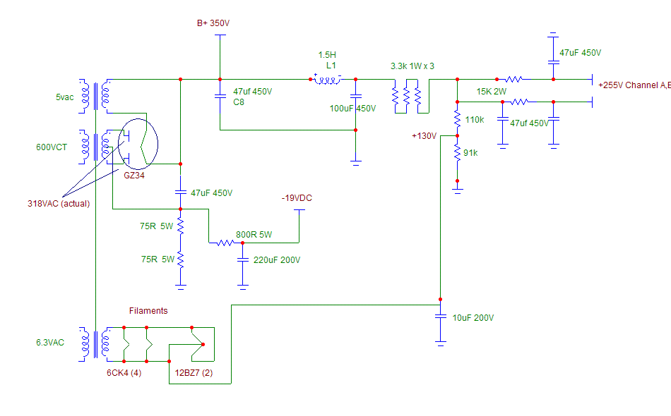

Correct Schematic:

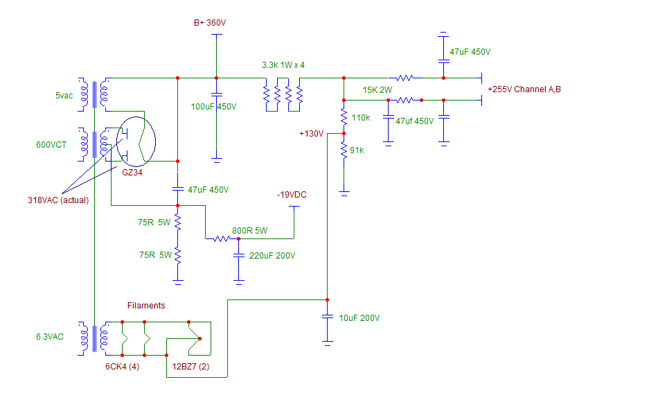

Hmm, so this is interesting. I went back and checked again, moving stuff around, etc. Same result. This time, I measured the ripple at several points. I did this by using my DMM and a 0.1uf cap in series with the probe.
With the original schematic, 100uf cap input, I get about 0.5v ripple.
With the choke in place, I get about 5v ripple and after the choke about 2.5v.
That could certainly explain the increase in residual AC. But why would the ripple be greater with the choke and extra cap in line? That's the opposite of what the PSUD simulation suggests, although the predicted voltage changes were spot on.

Ok,
If we ignore the 47uf cap in the ct circuit (cause I'm not sure how make a model equivalent in PSUD), the 150 ohms are simply in series with the input cap. And in PSUD that gives the correct voltages, but the ripple is about 5V. If I simply add the 47 to get a total of 147uf, the voltage is essentially the same (360) but the ripple drops to about 3v. If I put the 47uf in parallel (with a very low value resistor just to avoid illegal combinations) but make its internal resistance 150ohms (because PSUD won't let me put a resistor in series with the cap) I model about the actual measured ripple (approx. 0.5v), but the voltage is about 290, lower than actual.
So??? And I still don't understand why the choke would increase the ripple.
BTW, with the 150hms in series, I'm within all the current and voltage specs of the rectifier after a couple of cycles. Those first cycles in real life wouldn't be that high either due to the slow start-up. Don't know if that meets the above criterion.
Sheldon
Hi Sheldon,
There are only two ways a choke can increase the ripple that I know of.
Inductive coupling is one, resonance with the supply frequency is another. 120 Hz in your case. Your C-L-C is a low pass filter, it has a resonance.
-Chris
