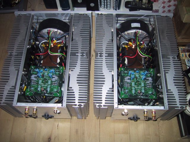

This is the sort of thing you could end up with, not cheap, a project for the dedicated builder. If you are a member of the fearless amp builders, go for it.
Pic is from the AX thread.
