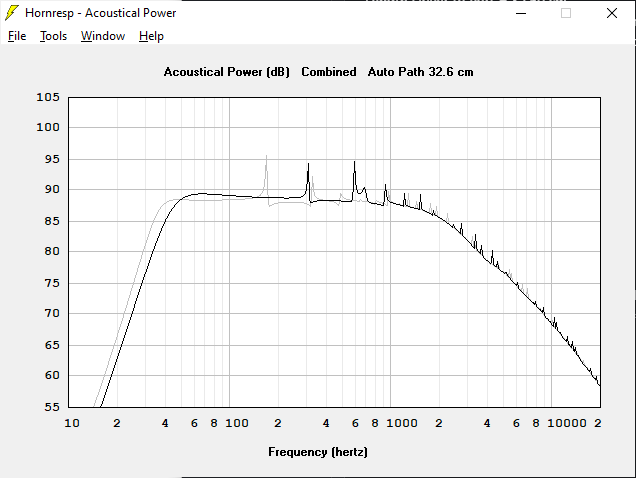

Not to speak for GM, so I will put it in a spoiler box. As a test of my understanding, I think that file describes a box with:
Horizontal cross section area = 503.95 cm2
Length Top to Driver = 19.56 cm
Length Driver to Port = 32.60 cm
Length Port to Bottom = 3.89 cm ... ~3" round port?
Area of Port = 50 cm2 ... if round ~3-1/4" or 80mm ?
Length of Port = 20 cm
Acoustic Path Length = 32.6
System Volume - 29.246 L
Driver parameters were:
Sd = 109.00
Bl = 5.85
Cms = 1.46E-03
Rms = 0.86
Mmd = 8.24
Le = 0.12
Re = 6.80
Should be the dark plot line.
And similarly, the Kewel in Hornresp would look like:
Horizontal cross section area = 452.12 cm2 = 17.8*25.4
Length Top to Driver = 37.10 cm
Length Driver to Port = 59.40 cm
Length Port to Bottom = 10.20 cm
Area of Port = 45.37 cm2 = π*(7.6/2)^2
Length of Port = 11.40 cm
Acoustic Path Length = 59.4
System volume = 48.759 L
Should be the grey plot line.
