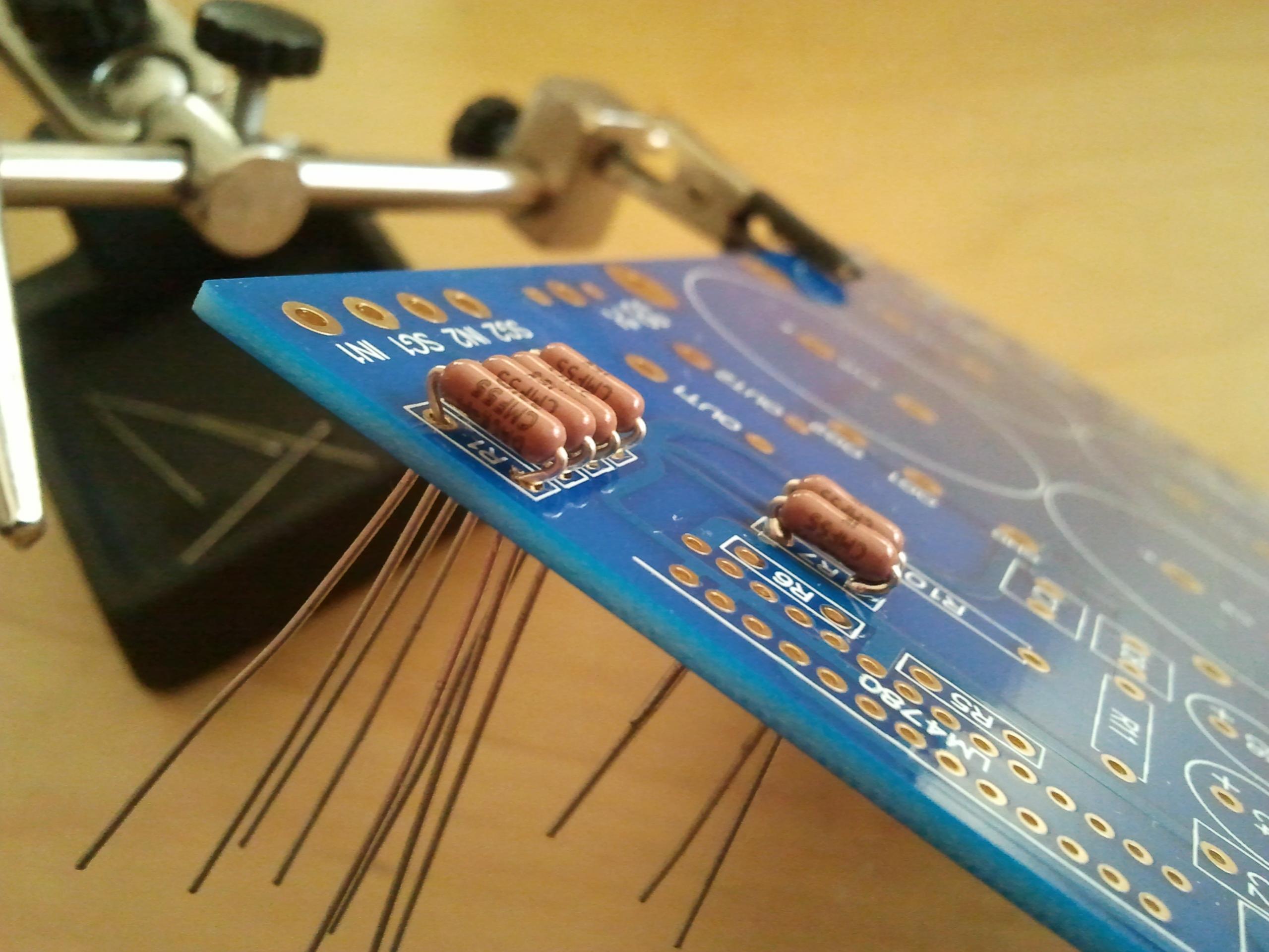

RN55D resistors can be used, but the leads have to be bent to make them fit. I can post pictures if wanted.

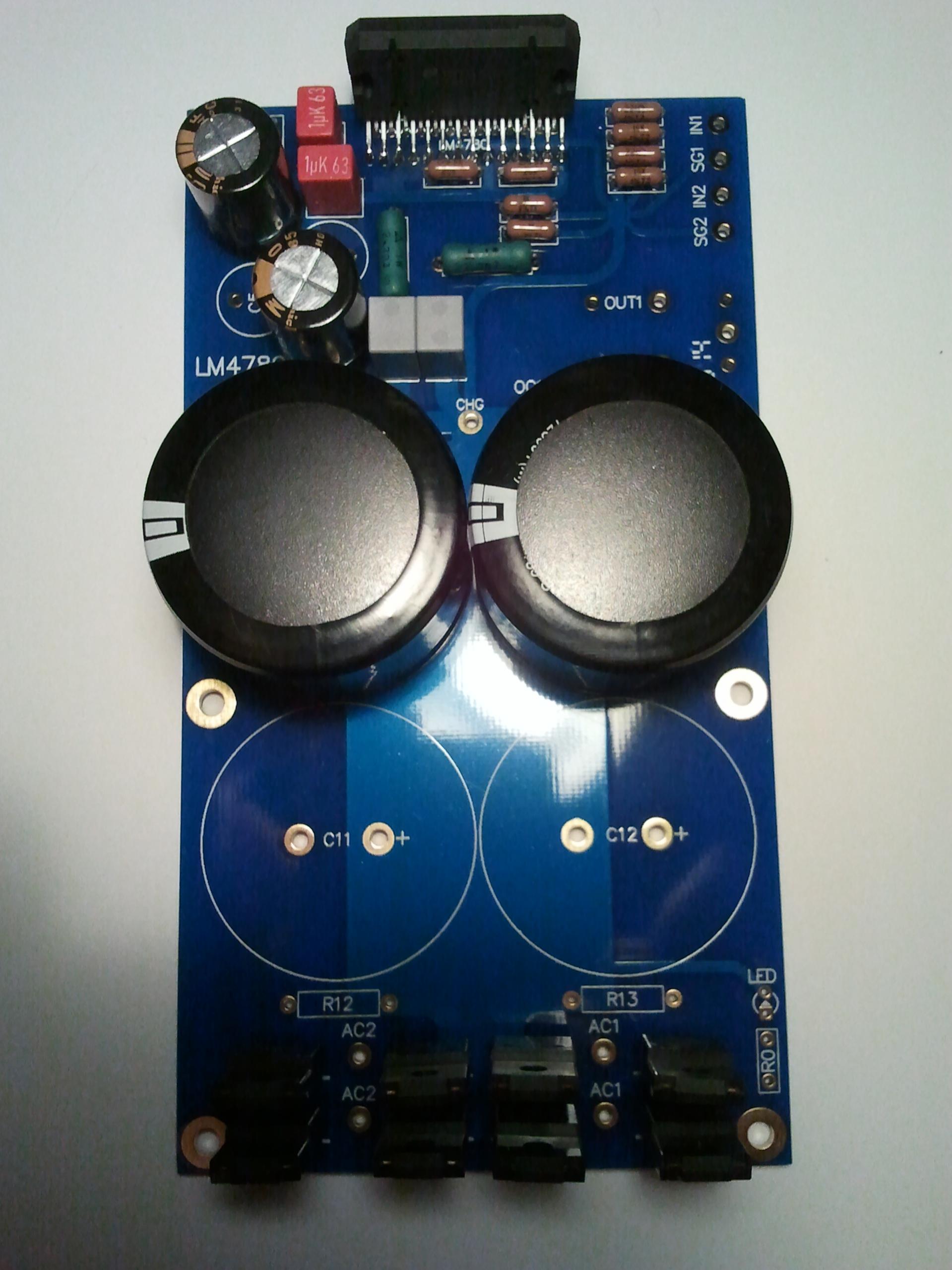

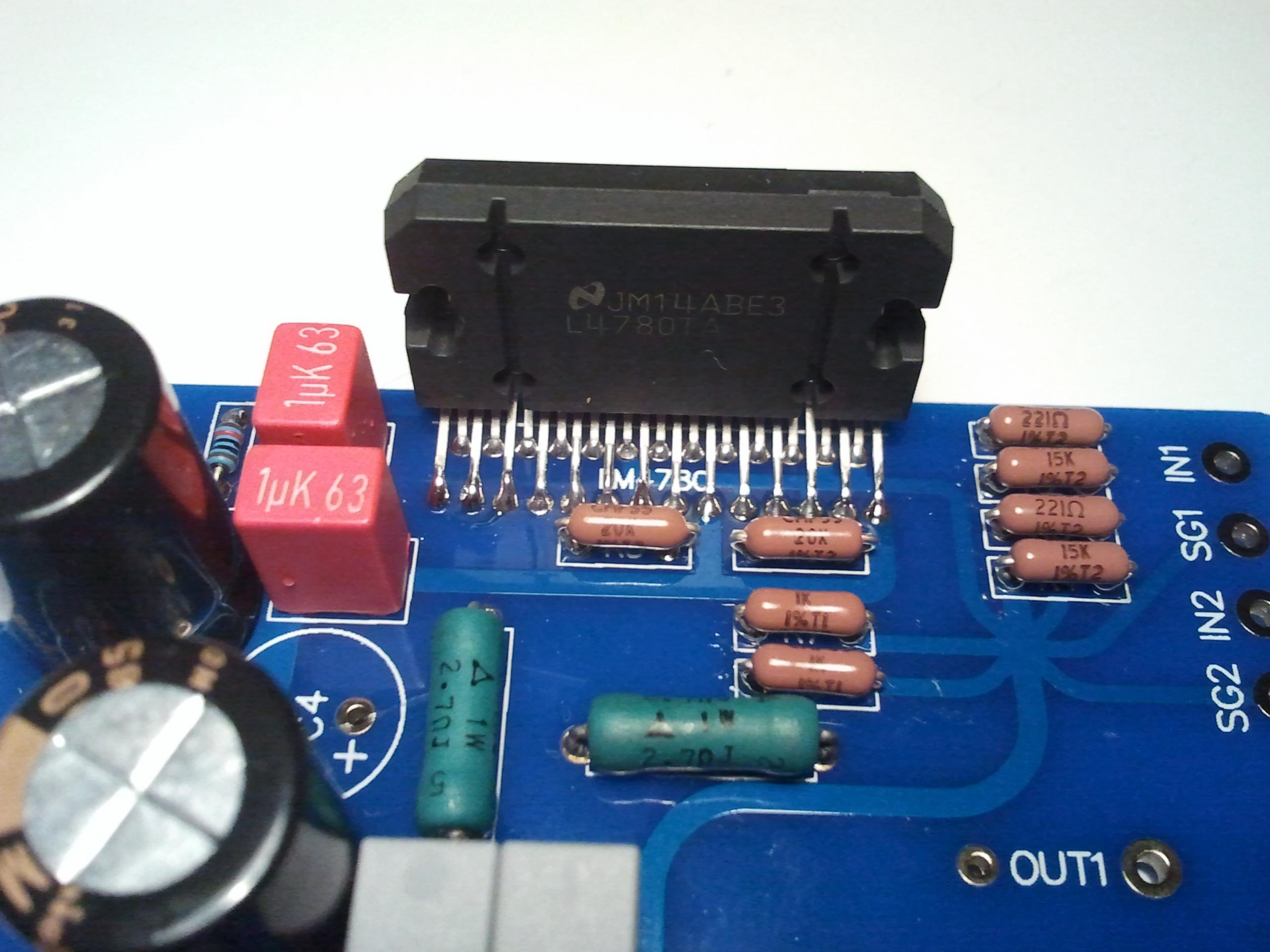

Here's a sneak-peek of my LM4780 stereo build.

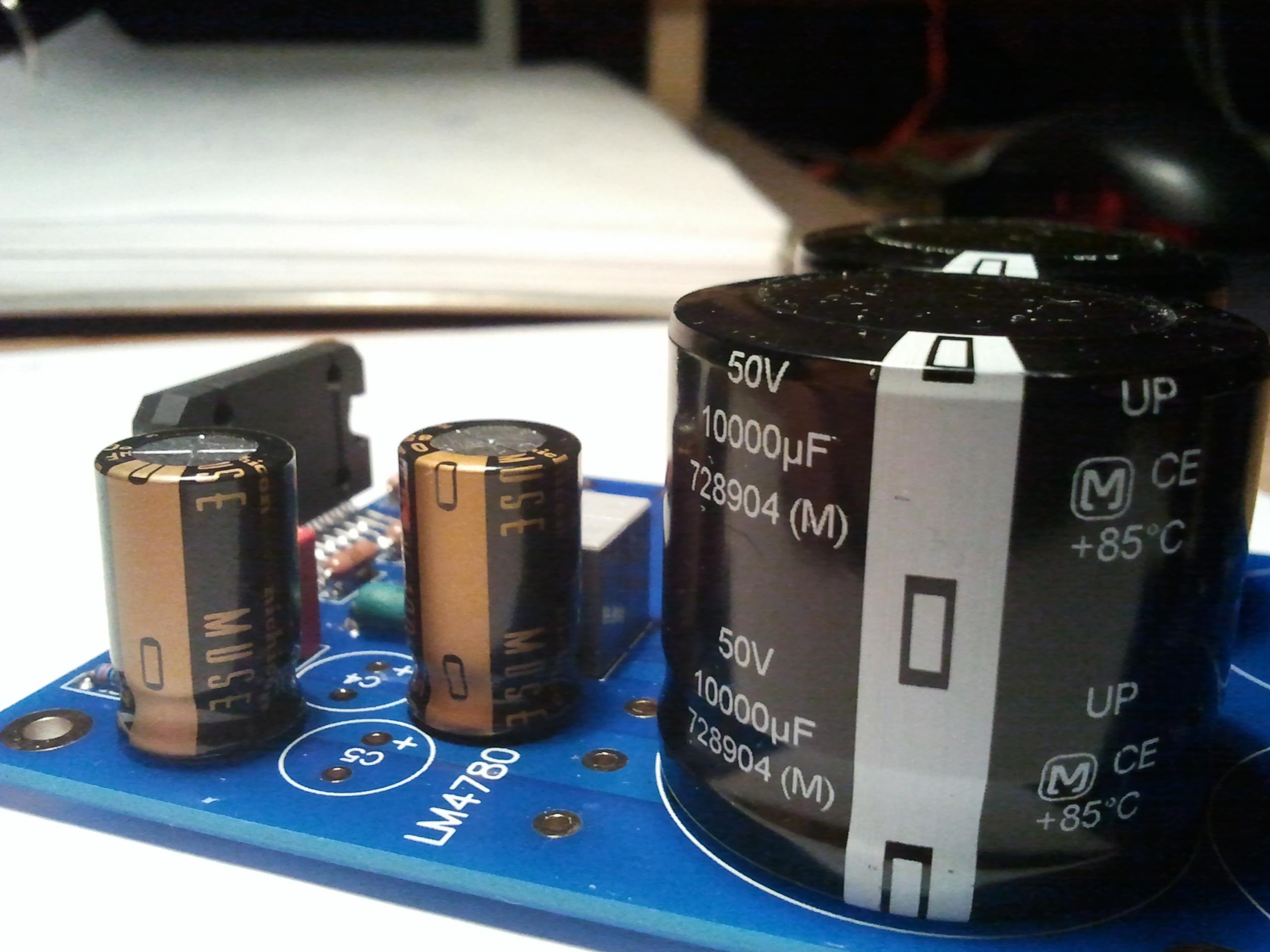

Diodes are BYV29-500, big caps are Panasonic TSUP 10000uF 50v, small caps are Nichicon Muse 100uF 50V, small bypass caps are 1uF 63V WIMA. The resistors are CMF55 1% MF, except for the 10k muting resistor which is a compact MF. The values are 15k to GND, 221R to the + input, 20k and 1k in the FB path. The snubber resistor is a 2R7 1W MF resistor, and the snubber caps are 100nF film caps.
Soldering was straight forward, and other than bending the resistors' legs so that they fit, there were no real issues. It's noteworthy that the through-holes of the pcb don't have that bridge/cross type eyelet (don't know the name), so a lot of heat is transferred away from the soldering iron. Thus a fairly strong iron is best, I have a basic 50W Weller and managed to have the solder flow nicely.
I'll likely fire it up tomorrow, we'll see how that goes...

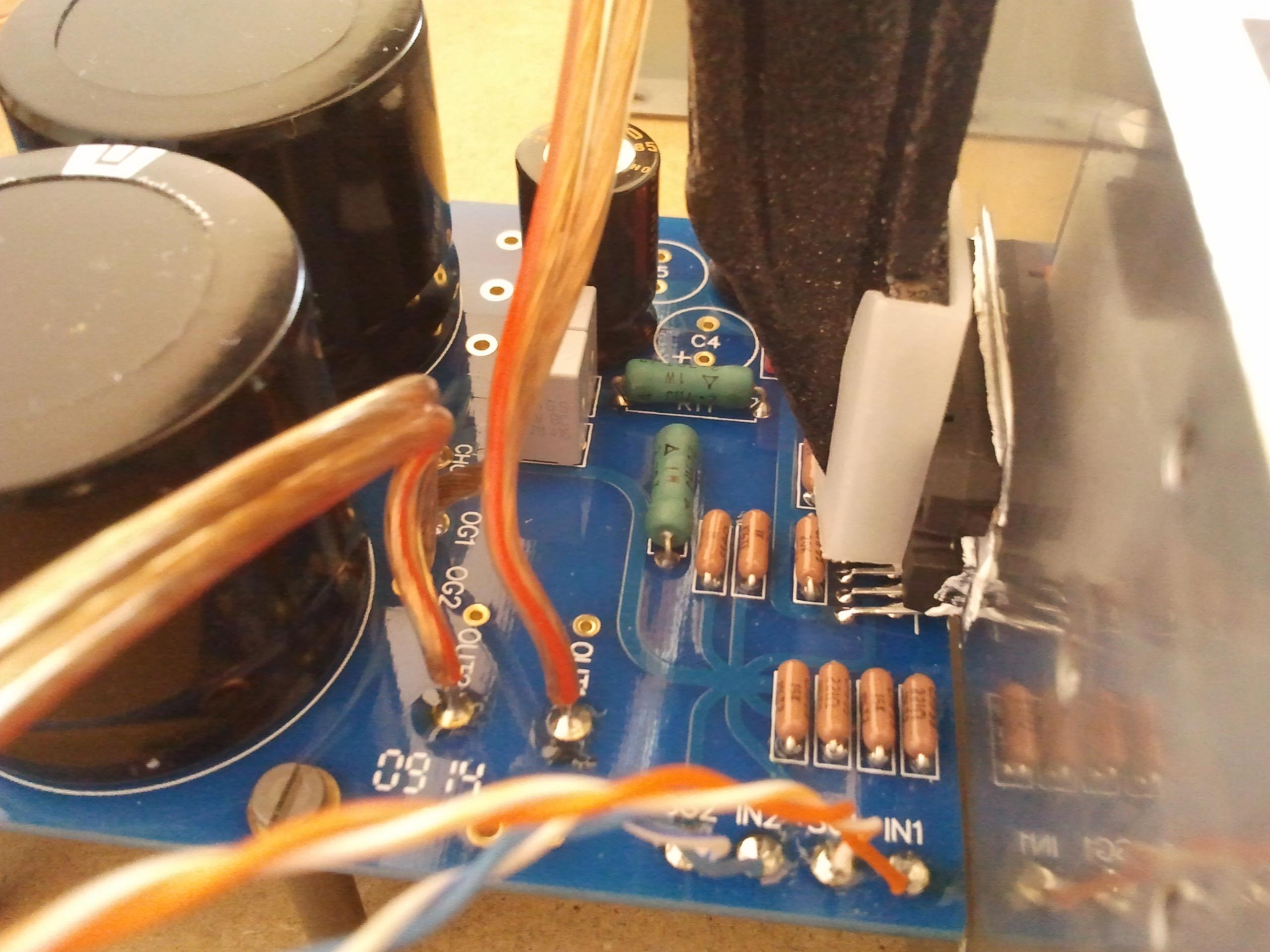

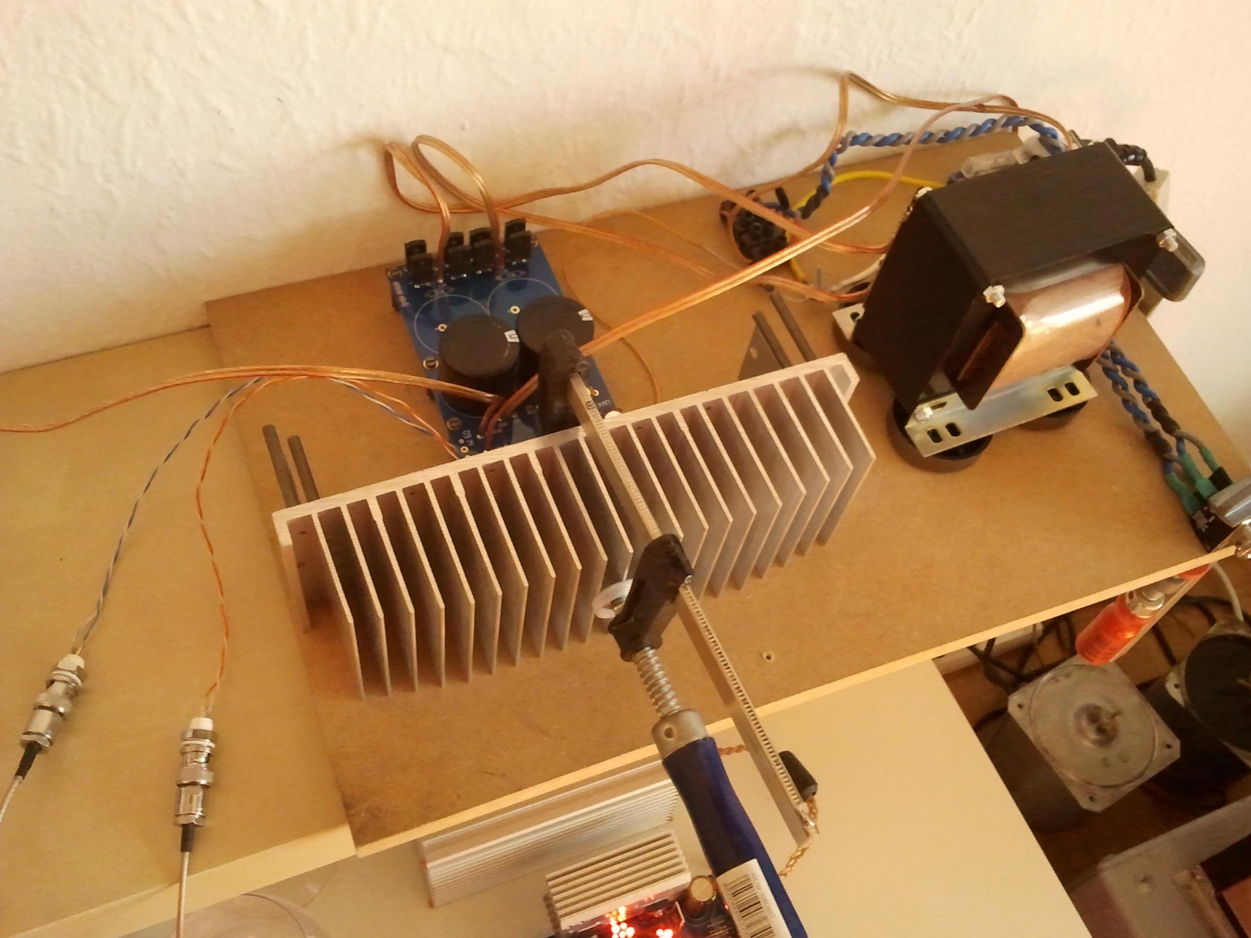

Alright, I just hooked the amp up to my speakers (nothing too special, Dual CL173 3-ways, rated 4 Ohm, rebuilt crossover), and it's sounding marvelous!
I'm looking forward to adding a second pair of 10mF caps to the PSU, maybe it will have an impact on the already good bass performance, we'll see.
The transformer is a (conservatively rated) 180VA EI-type with dual secondaries, and it puts out 22V AC for each secondary. After rectification and filtering I have pretty much exactly +/-28V DC. The amp is DC coupled for now, and both channels have a DC offset of 60mV, which is perfectly fine.
And yes, that's a clamp holding the chip against the heatsink...
