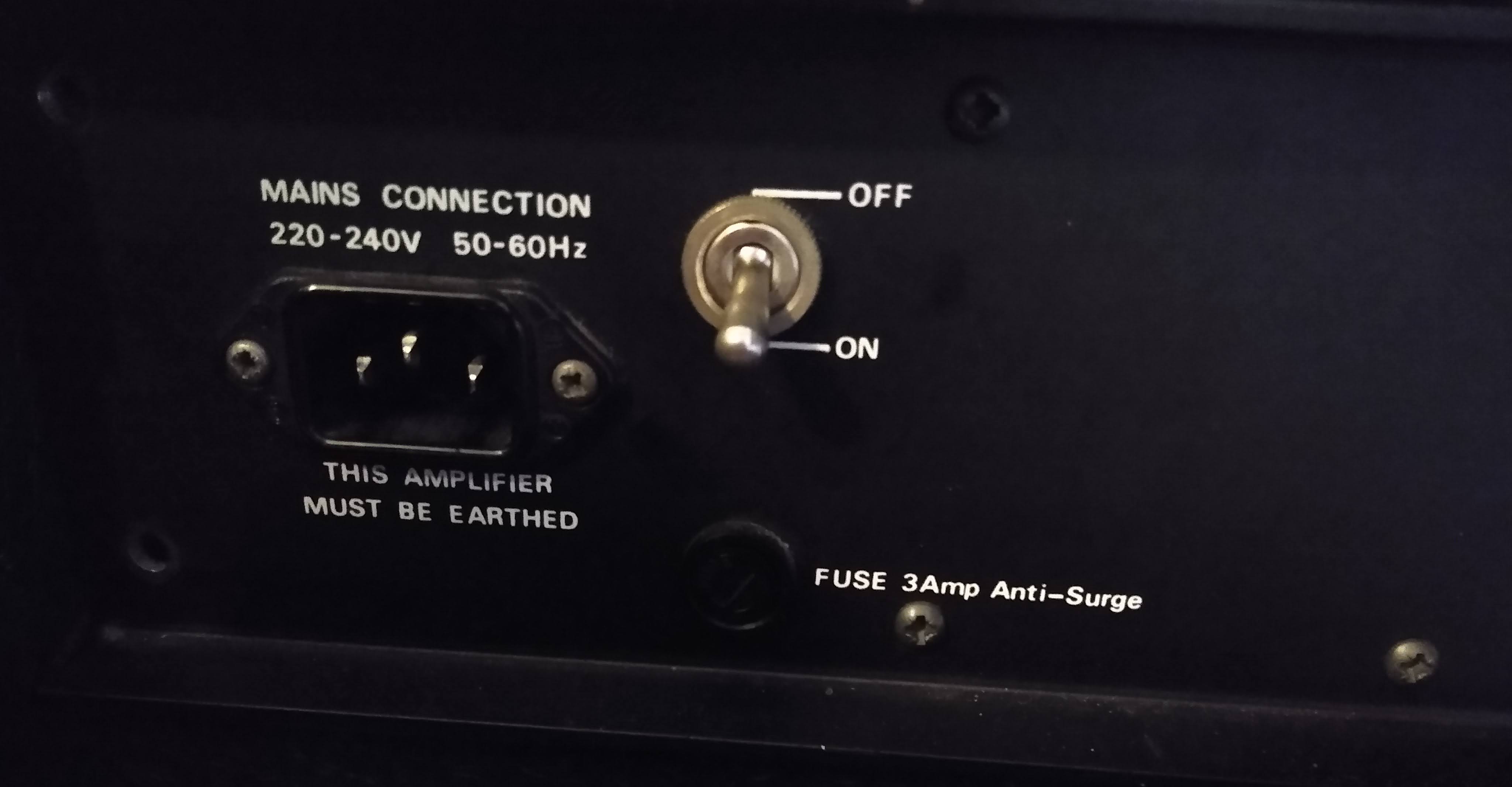

And your problems might be because you are feeding it 220 volts. instead of 110 <?> which it was designed for.

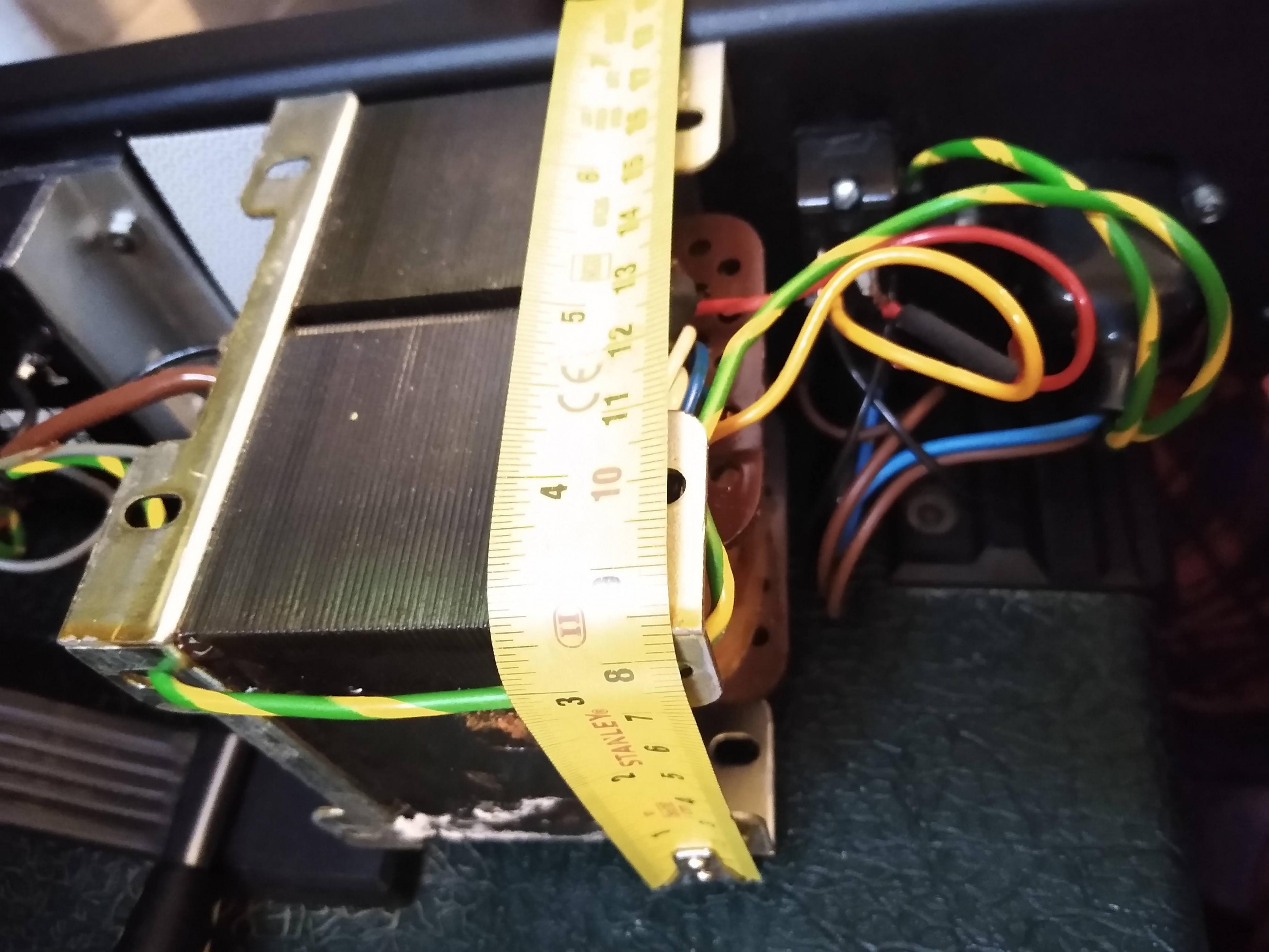

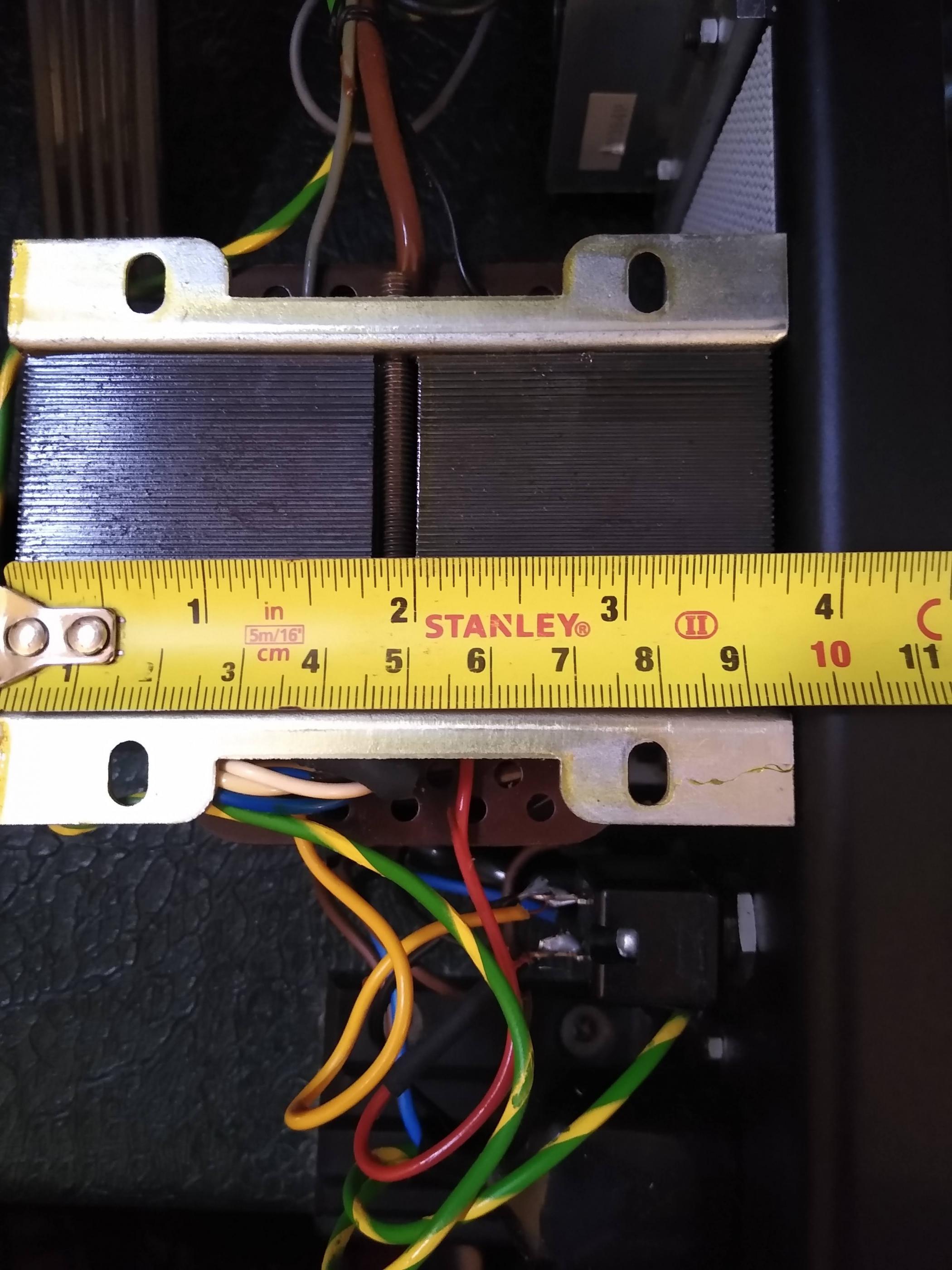

A picture with a measuring scale/tape/pencil or whatever next to it would be nice.
The object next to it would help judge the size of the unit, as 22 amps * 34 Volts is 748 Watts, so the output is quite large.

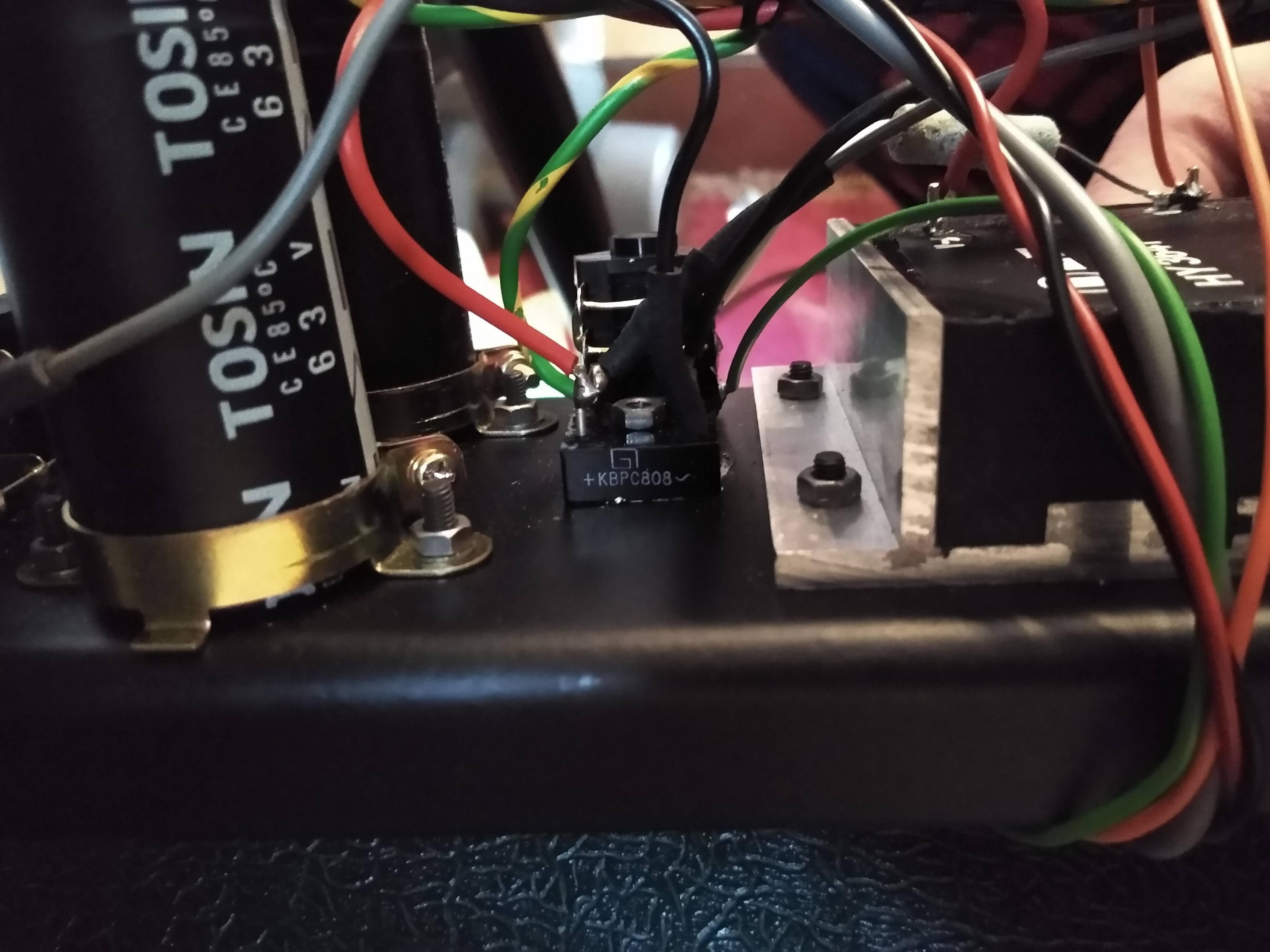

Thank you for all the replies and excellent suggestions. The amp is a British made guitar amp, an Alligator 75, which by all accounts was not all that great to begin with. I, too, was astonished at the huge amount of power it was using... There is no way these amps were exported, they were not successful enough. It was definitely sold for UK use.
I'm concerned that I have measured incorrectly, or made rash assumptions, so I will post pictures of my DMM readings too.
The original poweramp was an hy364p. Which the datasheet lists as +-42v max, and 180w. I'm pretty sure the speaker is 100w max.
Regarding the rectifier, when I was looking last night I couldn't find it because it was tucked away under an output jack. I'll have to remove both to see any markings on it.
Honestly, the whole amp looks like it was thrown together in a rush, by hand.
Something doesn't add up! I'll post pictures tonight as I'm now off to work. Thank you again for taking the time to help me out.

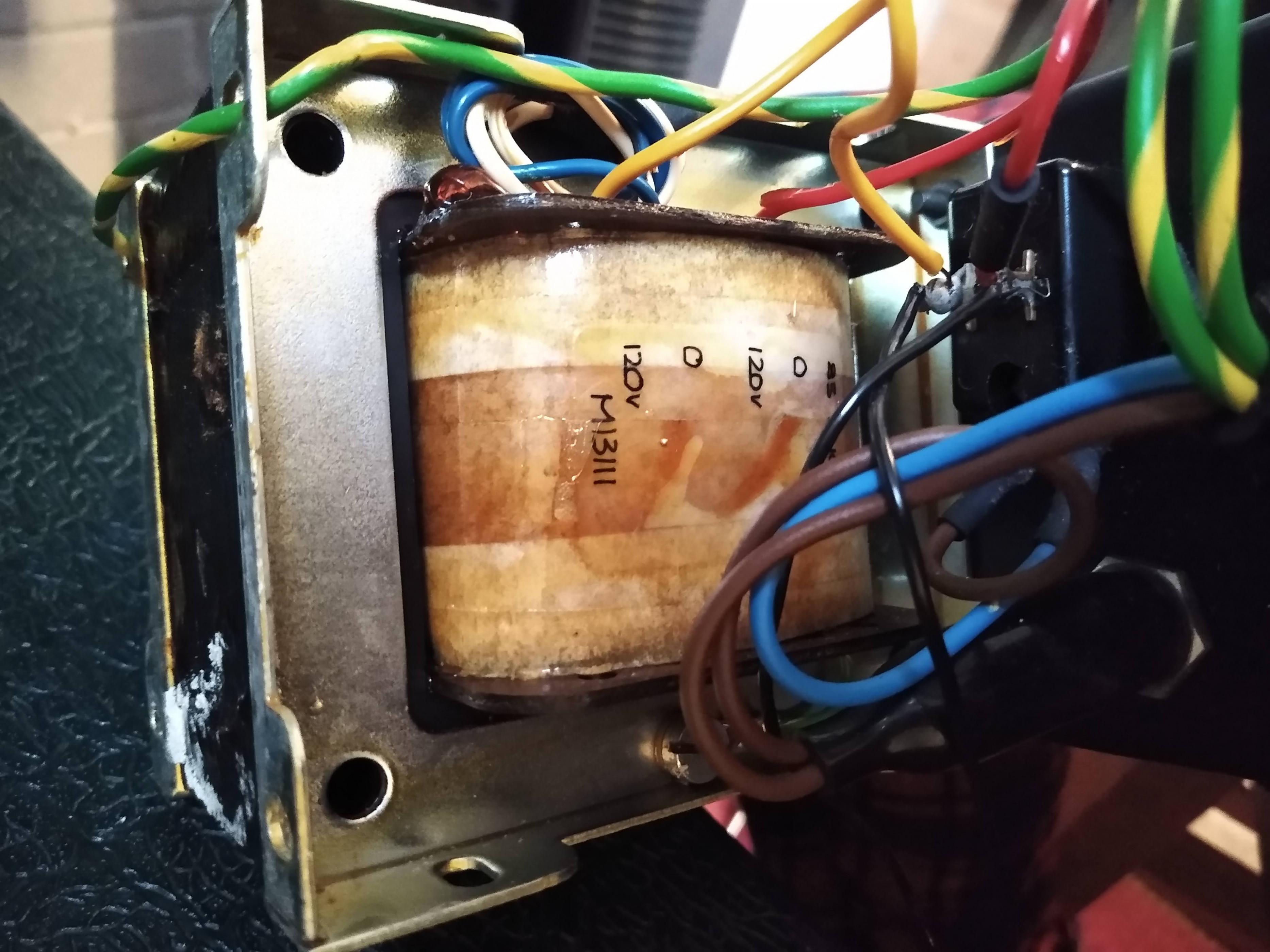

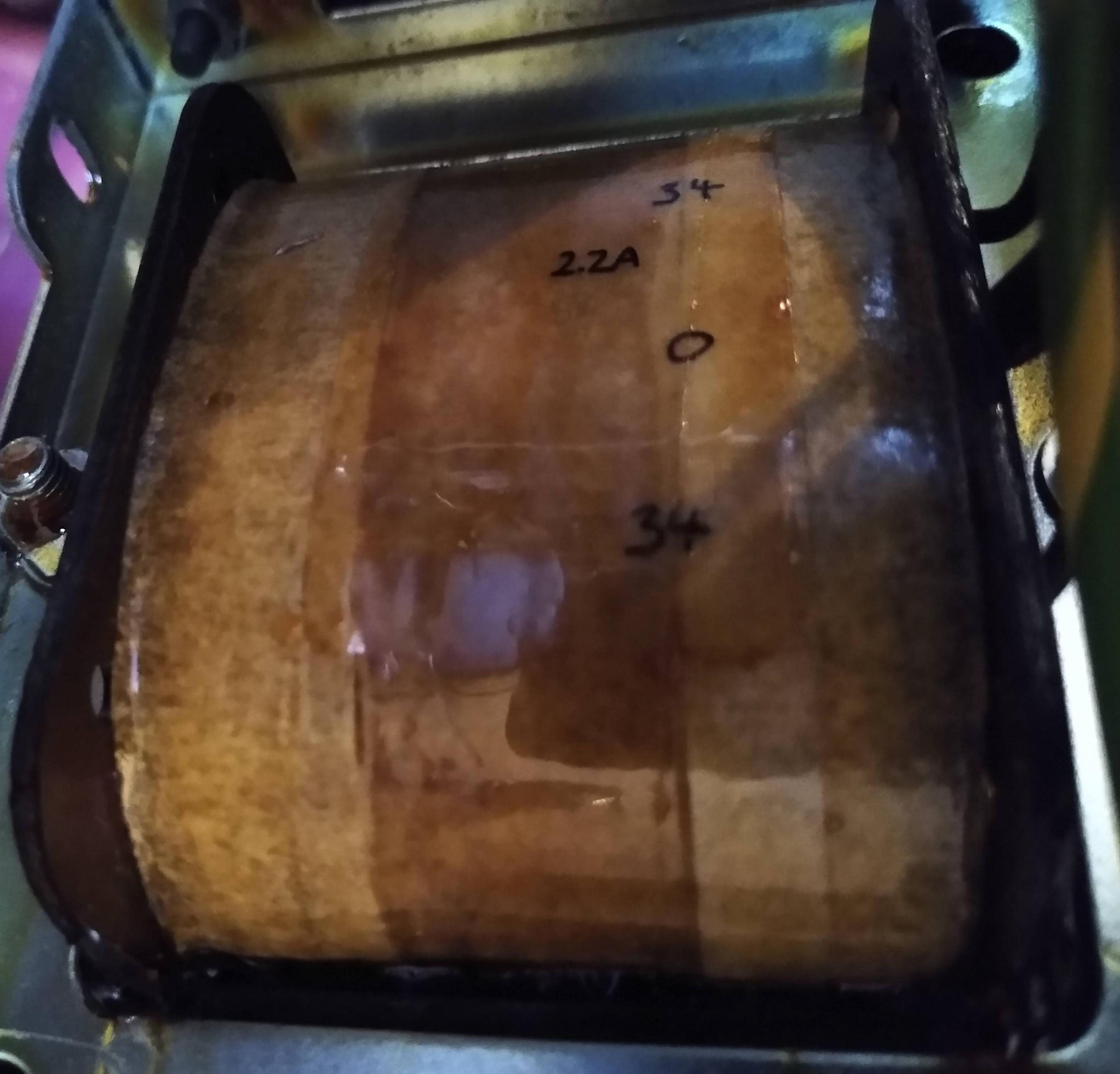

Okay, I have definitely made some poor assumptions and simply not looked at the transformer hard enough.
I really appreciate how patient and kind you have all been here. I was tired and out of my depth when I posted, and this discussion has really helped me slow down and look at things methodically.
The mains side is clearly marked 120 - 0 - 120 - 0
and the other side is marked 34 - 0 - 34 and 2.2a
Besides the rest of my nonsense, I'm most embarrassed about missing the decimal point.
There are two capacitors, both rated 63v 4700uf. They both look healthy. I guess that should have been my first prompt to realise my error - thank you NareshBrd.
The bridge rectifier is labelled KBPC808, which I have Googled and should be 800v 8A.
I'm not going to power it up now as my children are around, and I'll need someone to hold the camera. I'll wait until the kids are asleep and measure voltage again. I expect to find that I've actually got +-35v DC.
Here are some pictures that will hopefully redeem my noob behaviour.

Now you are well within the voltage range for a chip amp, and there are many people on this forum who will guide you how to go ahead.

...because the bridge rectifier multiplies the transformer output by a factor of 1.41, give or take mains variation? I *knew* that, but only because I've read it, and I definitely needed reminding.
I do not understand why the voltage would be lower without the capacitors. If you have time to explain, I'd love to learn!
You will either laugh or groan at this, but I went to test again and noticed that the battery on my DMM is low. It just confidently informed me that a AAA battery is putting out 2.5 volts.
I'm going to have a quiet word with myself while I order a new 9volt - if you want to keep this thread open long enough to indelicately roast me, please feel free.
Lessons learned? Look after your equipment, look at parts closely; if the maths doesn't agree, something is wrong; and that the most suspect component in all of this is me!
Buy a 9 volt alkaline
They last longer. The voltage is stable for a longer time compared to carbon zinc, but less than lithium.
If you want to do something really way out of left field, put 3 lithium batteries in series for 9 volts, use holders from scrap PCs or whatever.
The won't last as long as 9 volt cells, but lithium cells stay at 2.96 till they ae almost dead.
The battery voltage is used as a reference by the chip, but why they cannot put a zener or 7805 I cannot understand.
Beware of cheapo Chinese meters, and if you are an occasional user, buy a simple analog meter, there the battery is used only for resistance. So less issue like this one.
Duracell AAA lasted less than Ray-O-Vac but more than Panasonic.
When the capacitors are connected you get root(2) x V(AC) - the peak value of the AC (- a diode drop). When there are no capacitors, the meter will be reading the rms value of the sine wave from the transformer, or just V(AC).
So with no capacitors connected, the meter reading should be ~71% of the value when the caps are connected. The voltage printed on the transformer is the AC value.

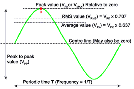

...because the bridge rectifier multiplies the transformer output by a factor of 1.41,...?...
Because AC power from far away is always delivered as "Sine".
If we heat a light bulb or toaster, we want to know the "equivalent in DC", because DC is simpler, and we want to know the Heating Effect. This is "RMS" and how utility AC is specified.
The rectifier-capacitor AC-to-DC converter is a "Peak Catcher". It want to charge-up to the peak of the incoming wave. For a Sine wave, this is 1.414 times the RMS value.
There are also choke-filtered rectifiers, and average-responding meters. The Average of a Sine is 0.9 times the RMS. With an old needle-meter, a "cap input" filter with capacitor left off would read 0.9 times what the marking on the transformer said. Modern clever-meters may come to other answers. But when say 300V of AC makes 273V of DC, we shout "put the cap on!" because that's a likely situation.
Average is less than RMS because heat rises faster than voltage, so the peaks count more.
Hmmmm.... Google tells me that the Peak is 1.000, RMS is 0.707. True, except utility power is not sold by Peak, transformers and lightbulbs are not rated Peak.
Do your math and you can figure the answers RELative to the way juice is sold and used.
