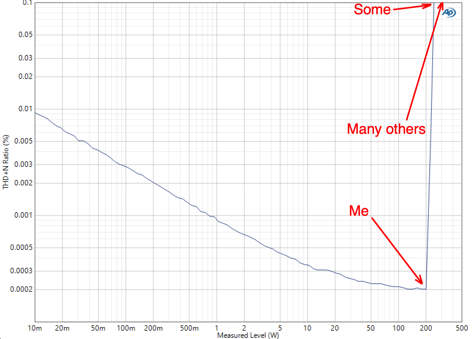

In my view the honest approach is to measure the THD+N vs output power and quote the RMS output power at the onset of clipping as the maximum output power. That's my approach. But some would argue that the output power should be specified at the point where the THD becomes audible. So now we're not just talking the onset of clipping, we're talking audible distortion. How much is audible can be debated. In controlled studies, values from 0.01% to 1% have been noted. So you'll often see amps specified at 1 % or 10 % THD+N. The reason for this is simple. As you can see in the plot below, which I measured on a power amp, there is a significant difference in output power for the onset of clipping, 0.1% THD+N (top of the graph), 1%, and 10% THD+N.
I call this a 200 W amplifier. Some may call it a 250 W amplifier as that's where the THD+N reaches 0.1 %. But in the commercial world you'll find many others who would label this a 300 W amp (1 % THD+N) or maybe even a 350 W amp (10 % THD+N).
The FTC got rid of the amplifier testing standard last year so now we're back to the Wild West. Honest manufacturers will give you the THD+N curve as well as the point where they've defined the maximum output power. You can then make an informed purchasing decision. If the manufacturer won't give you those data I'd just walk away. It's not like there's a shortage of manufacturers in the audio market.

- Pick the largest power number on the front page of the data sheet of the amp chip. This seems to be a common thing on eBay/Amazon/etc. An amp might deliver 400 W into 2 Ω, so it'll be sold as a "400 W amp". Never mind that it'll never deliver anywhere close to that with a more reasonable load (or with the power supply that it's sold with).
- Measure the maximum peak output voltage the amp can deliver in a short burst with a lab power supply, calculate the power from there and call it "peak music power".
- Same as #2 but use the RMS power instead. This one is starting to look like an honest approach.

tomchr - I agree that's the best way, although you have to be a bit careful about those graphs as they sometimes have a flattish section before clipping, how exactly to you define the precise rise-point of clipping? Perhaps something like 50% above the lowest point, or 0.1%, whichever is lower (ie anything worse than 0.1% doesn't count as an amplifier 🙂 That 50% allows for some rippling in the THD at moderate powers.
So for your graph the 0.0003% point would count as the clipping point.

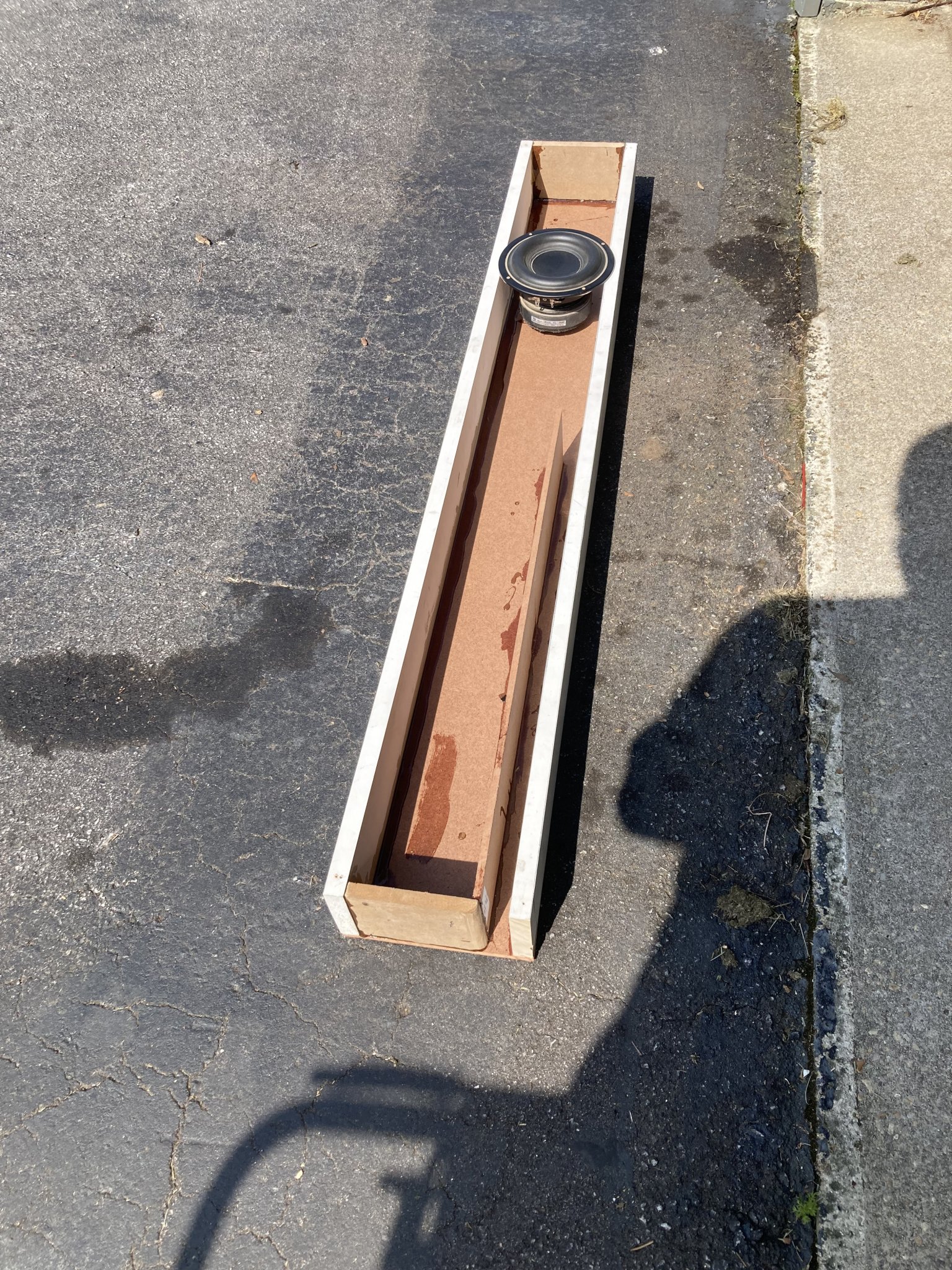

I built this .5cf enclosure tuned to 27hz around a tang band w5 and mounted it under my tv above the bottom shelf. It seems fairly efficient and plays quite low but it interferes with the function of the shelves. Bare in mind that there’s usually not wires sprawling around everywhere…
