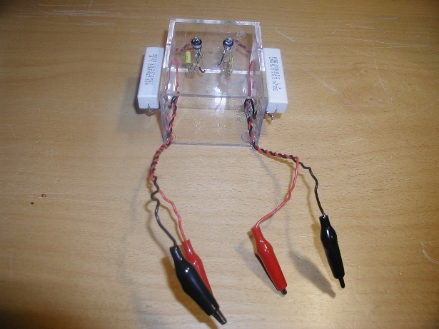

I built a point to point GC with the 9 components per the original. Originally had the input cap removed and works perfectly with my 12B4 preamp. But once I put my passive pre in front of the amp, Oscillates like crazy. Tried my Lightspeed pre and again oscillates like crazy. Tried my Foreplay, and another tubed pre and works great.
I put in the Input caps on the amp, and it still oscillates like nuts with the passive pre, LS, but not with the tubed preamps....
I do not have bypass caps on the 2200uF caps on rails at chip. I basically have it as shown on Mick's url:

One of the cool things that came out of this "problem" is I built an oscillation detector...
I am one of those poor slobs in this hobby without a scope (well I have one - bought it on ebay for $20 - 'nuf said)
Anyway on another thread, Unclejed613 suggested building a cheap and easy oscillation detector with a couple of components...
http://www.diyaudio.com/forums/showthread.php?s=&threadid=112878&perpage=25&pagenumber=3
"you might want to try a "quick and dirty" oscillation detector using an LED. you want to take an LED, put a 100 ohm resistor in series with it, then put a 4.7nf cap in series with the 100 ohm resistor. the "unused" leg of the LED becomes ground (polarity of the LED doesn't matter). the open leg of the cap becomes the input. then put a 1k resistor from the junction of the cap and series resistor to ground. the circuit is connected across the speaker terminals. any oscillation above 1 volt and above 20khz should light the LED, especially if the oscillation is continuous.
LED's are such useful devices......"
Very Cool! Pic attached with my 25W 8.2 load resistors - I just attach to the amp outputs and led light during oscillations. I built it in 25 minutes and will plan on using it on all my amps to spare possible damage to speakers...
Anyway, the detector ights up like a Christmas tree with the passive pre or lightspeed preamp hooked up to the Gainclone...

Only oscillated with passive preamp attached...
There is a zobel at end of the amp - see the url.
100nF and 2.7 ohm.
I actually added a 1K resistor in series with Cin (between Cin and amp input) - no more oscilations, but low volume on passive pre.
It sounds as if your amplifier oscillates when driven from a possibly low impedance source. Most generally, your amplifier chip should have some resistance in series with its input, note that many audio amps like this use something in the area of 1k, and also something between 10K and 100K to ground to bias the amplifier to zero volts DC offset.
I fixed a gainclone for a friend recently which had the input series resistors, but no grounding resistors, and would float around with DC offset notably just pulling right to one rail. This is bad for your speakers! haha.

I have removed the 4.7uF cap and just placed the 1k resistor in series on the inputs. All is well. No more oscillations. My passive pre is a 24 step attenuator that the highest volume setting is 30k ohm attenuation - I forgot that full clockwise is not 0 ohm on this attenuator - just checked with my lightspeed and all works fine.
I do not want to add all the other residual bypass/resistors/components and want to stay minimalistic like the original. I knew something simple was keeping it from working properly. I wonder if a real Gain Card world also oscillate in this setup without that 1k series resistor - I guess I can pay $5000 to purchase one to find out...nah.
