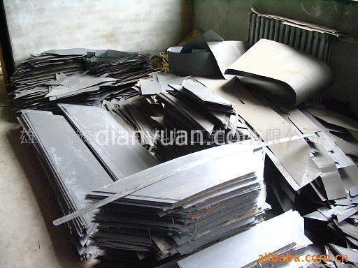

Quite possibly, but if they have published specifications on things such as OPT's then I'd have no qualms other than shipping charges.
tube-lover must be an expert of tube amp business in China.
What I know is that they turely"re-use lamination from large power plant transformers". However, they may not be "low efficiency, high core loss". Also I heard that higher-B lamination may not sound better.

hi vax9000,
I am not say chinese OPT re-used large power plant lamination was not good. But can they know or gurantee the lamination was not overload or over heat.
Although Japan audio transformer was made in china now. But different standard.
pls understand.
pls see the picture/
use large OLD power plant lamination prepare for small size laminations.
I was OEMer of japan OPT.
I will continous post Japan audio grade OPT used material coming!
thx
