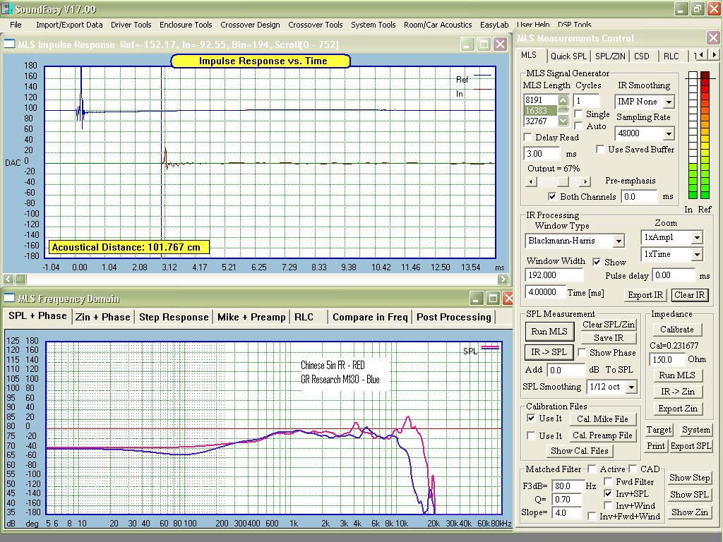

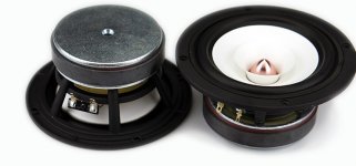

Freq. Response of Chinese 5in Full Ranger
As promised earlier find attached the freq. response of my newly acquired Full Range 5" driver. The images are self explanatory.
The peak at 4Khz maybe a little worrying and comments anyone. Otherwise it seems quite good, the spl is about 89-90db, compared it against GR Research M130 which I know is easy to drive has about 89dB.
Looking forward to use them in a 2way speakers, with a helper woofer.
