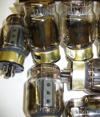

I recently scored a quad of Chinese KT88s marked "Audio Research" off of E-pay. I'm kinda short in the beefy 6L6-type department (just some Sovtek 6550s and some "super" 6BG6GAs), so it was nice to get some inexpensive tubes to play with. The innards look fairly reasonable, though one looks a little crooked on its base. Are these firecrackers with glass envelopes or reasonably decent tubes?

They say "Audio Research" on them, and they are labeled "made in China". They were tested and matched by the E-pay seller. The seller has another quad up at this moment, so you can check out the pictures on "that auction site" if you're curious. Just search for "Audio Researdh KT88"

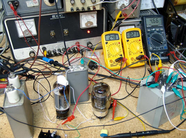

The untested versions do blow up...a lot. 25 to 40% failure rate is about what I get. One of these tubes was one of only two tubes that I have seen blow up so badly that the glass broke! The other was a Russian 6P19 that I wired really wrong.
The construction quality of the tubes is randomly bad, or worse. The alignment is such that most of the plate current occurs in one spot leading to a bright red spot at dissipations of 15 or 20 watts. The good ones will light up one side of the plate at 25 watts. I decided that these tubes are no good for any class A applications with continuous dissipation near 25 watts or more. I was building P-P guitar amps in the 35 to 40 watt range with 375 volts on the plate and the tubes that lived for 15 minutes with the amp head sitting on top of the speaker seemed to last OK. None would work in an amp with 450+ plate volts. Those amps got Sovtek 6550WA's.
The Audio Research pair are decent and well matched, but nowhere near capable of eating 40 watts continuously. I use them for testing experiments before plugging in the good stuff.
One of the untested tubes is shown here:
This suuports my suspicion that these are "banging around tubes" (hopefully not too much of that "bang") and not much more. They may be of a later vintage than George's, as the "Audio Research" is in black. Maybe there was even some time for the manufacturer to get his act in gear. I stole a picture so folks can see what they look like. I guess I'll have to buy some EH KT88s for more serious work.
