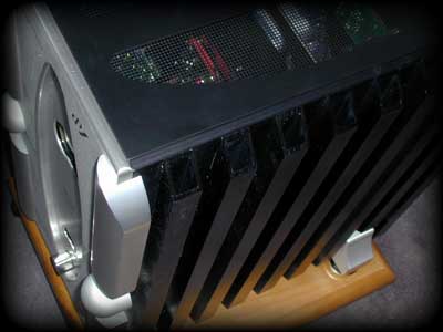

The chimney idea sounds good. I guess the main problem is that most people want an amplifier that looks like what they expect an amplifier to look like.... heat-sinks ... convection ... chimney ...
The heatsinks on Nelson's First Watt chassis always look to me like a waste of perfectly good metal. 😕... heat-sinks ... poor use ... convection ... Nelson Pass

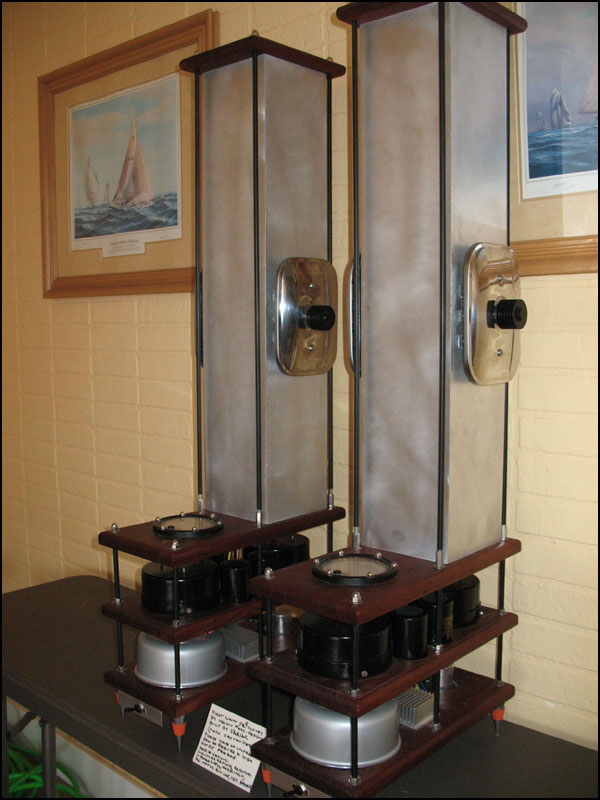

Check out Variac's F4 monoblocks.
i.imgur.com/l9kC7.jpg
what exactly is that giant stack on top of the amps supposed to be/do?

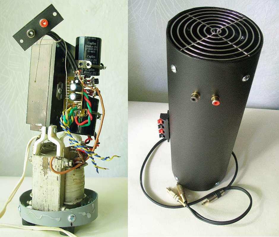

For illustration here is the pic of a "vertical amp" design inside a long tube,
which was produced by a hobbyist.

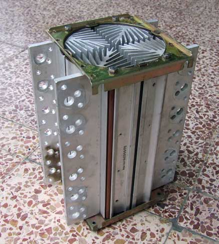

I imagine something between Variac's Steam-Punk chimneys and a chimney extension of Zen Mod's post and pic:
http://www.diyaudio.com/forums/attachments/pass-labs/111614d1215204042-f4-power-amplifier-one3.jpg

It isn't supposed to, it DOES in fact cool the output devices effectively. There is an amp board with 6 MOSFETS under each of those chrome side covers. I used 3/16" thick tube. If I had to do it again I'd use 1/4" to 3/8" because the upper area of the tubes doesn't really get very warm which means the heat isn't spread enough to take full advantage.
Each tower is a 2 ch F-4 amp which I tend to run balanced, which in theory is 100 class A watts! The wood top and bottom plates have a hole the size of the interior of the stack so air can rise through the tube- cooling it. If you add up the sq inches, its quite a bit - even if it doesn't have fins. The air rising up through them does seem to work. One problem with fins is that if the sink is tall they have to be widely spaced. Not a problem with this stack.

Very very interesting, I like a man who thinks. Even the steam-punk appearance will have its fans in contemporary design schools. What's the temp like at different heights, what does your hand feel at the top, how warm or cool does it run and how much air can you feel moving, blowing out the top? Would be interesting to paint with the temp-color-change "thermometer" paints to dramatize the temp change. Do you think it's more imortant to not restrict the flow, or would it help to have some disruption to add turbulance right near the transistors to maximize the heat exchange right there (like insert a stationary fan blade near the midpoint or maybe lower)? Now that you've been there/done that, you endorse thicker aluminum; what about 1/3 the diameter, round section, internal fins, transistors lower nearer the coldest end of the chimney, and the upper half of the chimney made of some much cheaper material like thin plastic pipe or clear acrylic tube? I'm thinking round pipe is an optimum chimney shape, and in standard sizes would mate nicely to clear acrylic tube unless some visiting fool mistakes it for a big bong...jah mahn I put some hashish on those little bumps inside and got a killer hit of smoke, dude... I'd love to build a shortie and experiment with different chimney extensions, and so some experiemental optimization of internal fins/diameter/length etc. I imagine one large chimney per amp will far outperform a bank of smaller chinneys scaled down...much less restriction with the large chimney. Then again, if I have the lower metal section internally-finned, then an unfinned upper plastic pipe might be smaller diameter and get higher velociy of the air, making a better air pump in a given height. I wonder whether at some point it would begin to whistle (only if you spill water inside LOL)? Would definitely be interesting to put a light at the top and blow some smoke into it, just to observe the air flow visually.
