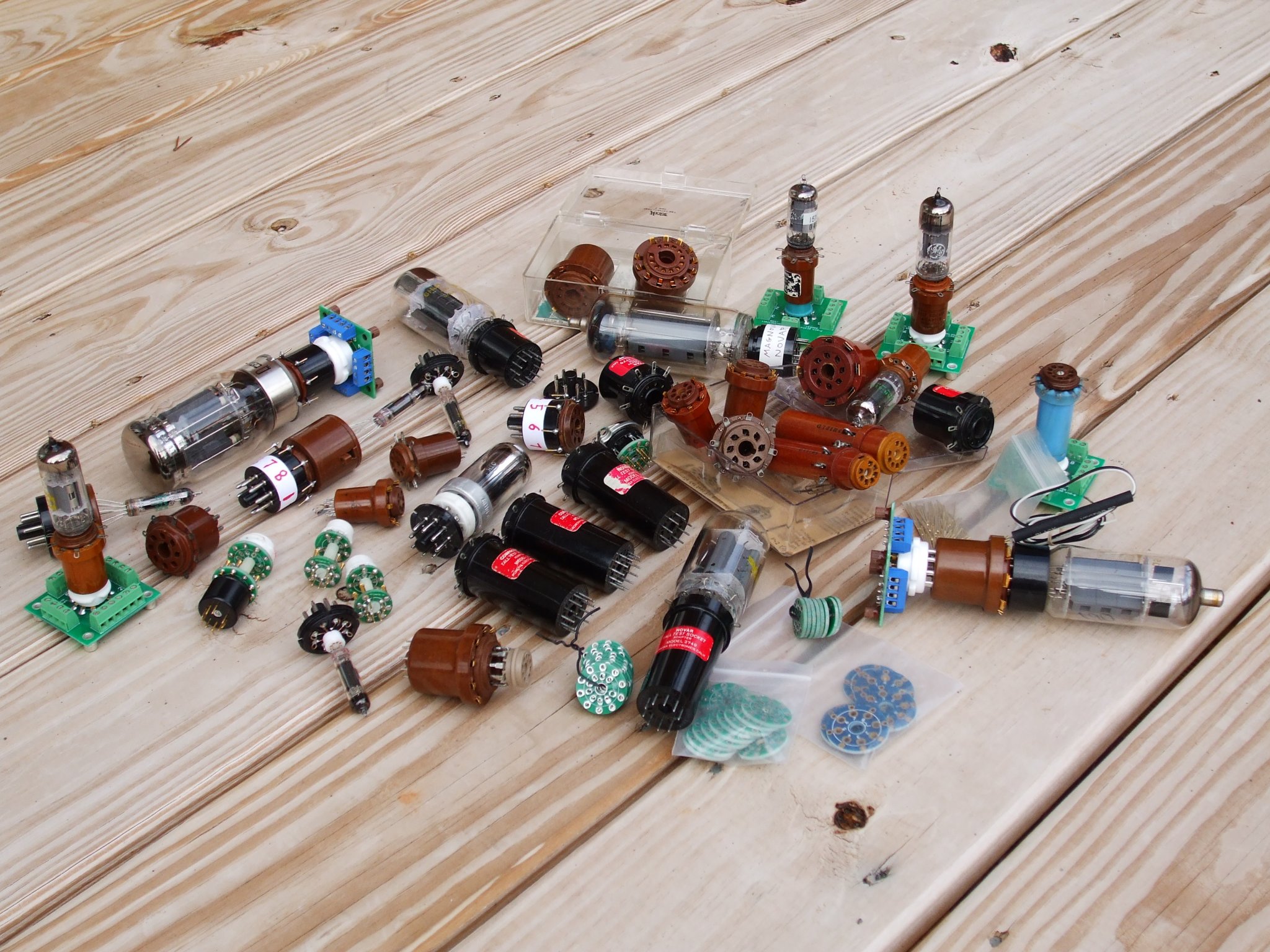

Is removing the tubes and checking each pin for voltages an acceptable practice? If using the the negative speaker terminal as ground is it still necessary to have a load connected during this test? Other than the precaution for high voltages what are other concerns?

Tube amps should always be operated with a load. If you pull a tube, the voltages at the socket pins can change,
because the tube is gone. Here's an example of what you can use instead, if you can't get inside the chassis.
However, sometimes the speaker ground, or 0 ohm, output terminal is not actually ground. And be careful,
use one hand only, the other in your pocket. If no input signal is needed, use a shorting plug instead.

To test voltages and currents from the chassis top without having to open the chassis, it would be fairly easy to design and fabricate testing socket adapters. Simple PCB layout and some mill-max pins would do it. Do them nice and you could probably sell them.

You can buy or build just about any kind of tube test adapter from stuff off Ebay. Unfortunately the classic stuff (Vector, Pomona, ...) has sky-rocketed in price since the pandemic hit. Used to be like $7 for an adapter a couple of years ago. Making your own adapters from Chinese parts is still reasonable. Some test adapters can do pin current tests as well as voltage pin tests. (like the big right side capped tube in the pic below. A Vector T80C with current probe inserted in one pin. Some other Vector 7 pin, 9 pin, Novar, Compactron, and Octal current test adapters in the clear plastic boxes too.) One of these V and I test adapters can replace a big box tube tester easily for gm or mu tests, by the way. (with a signal gen, power supplies like Heath IP-17, and a couple of DVMs) You can also use them to calibrate a tube tester. So much cheaper than a real tube tester, and more accurate.
Thank you all for your responses. I was able to test the voltages at the pins with all tubes removed and found the tube that was not getting the required plate voltages. An open 5 Watt resistor was the reason. But now I know whats available out there for tube testing.
