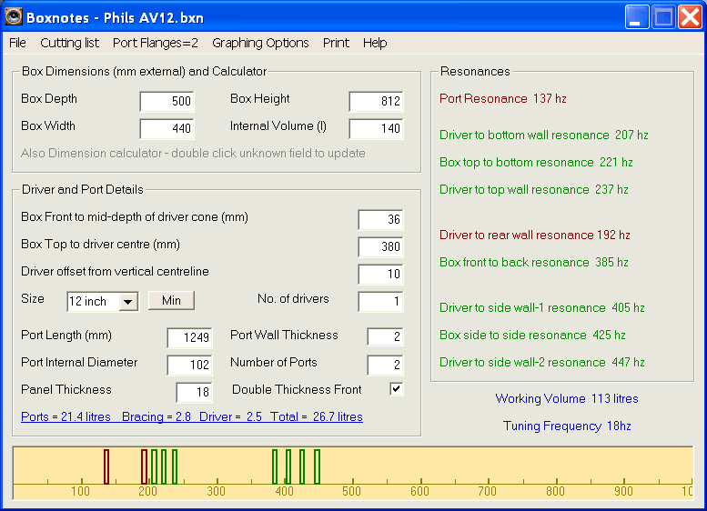

cheers mate I think I will go with two 4inch ports which will have to bend. I will have to draw up a box to see how well they fit.
If i go with 4cf 113L shall I keep all the design for that but make it a few litres more bigger for the volume the ports take up?
To fit ports I will have to make a shape like this which will be two 90 degree bends
Could anyone tell me if this will be a problem?

Three 90 degree bends here .....
http://www.users.bigpond.com/bcolliso/snorky-gal/snorky-4.htm
This might help with the box design:
http://www.users.bigpond.com/bcolliso/freesoft.htm
Here's a screenshot of how things might turn out....

I'm glad you found it useful - I wouldn't build a box without it.
As for working out how to fit the ports in, you should first see what 90 degree elbows are available. ( Take a tape measure and notepad to the hardware store or plumbers supplier). Only then will you be able to juggle your box dimensions.
If you are lucky enough to have a choice of brands, go for the one that has the most gentle bend. Ideally the inner radius of the bend should be no less than 20% of the pipe diameter (ie 20mm in your case), although you can't always get this. Sand off any rough edges on the inside.
Best of luck and remember to post some photos so the rest of us can enjoy it too! 😀
