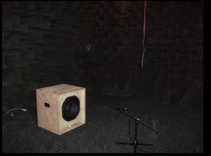

Hi, i just finished my first design, a 18'' Fane Colossus 18XB in a 221L bass reflex box i designed.
Now i had the oportunity to check the response of my speaker in an anechoic chamber, and see the frequency response.
I'm trying different configurations of damping material inside and measuring the frequency response, so i can see and measure wich configuration will be best.
Now i upload the graphics, and when i get home i'll upload some pictures about the mounting and the box.

Here are the freq response with the hole span:
1.- No damping material
2.- Half loaded damping material (BACK AND UP)
3.- Fully loaded with damping material
Thx for your help in advance.
Don't be cruel, its my very first toy i make 🙂
pd: measures done with good microphone (omnidir & flat resp) and Pulse Labshop

Frankly, I don't think you could have screwed it up that badly, I suspect the measurements are way off.
An anechoic chamber good down to below 150 Hz would have to be huge, and have many truckloads of fiberglass.
As far as damping, it seems to only have a slight negative effect in the range where a sub would be used.
Measuring a sub at more than one meter is more representative of the "real world", as large subs measured close appear to be more like 1/4 space than half space. Measuring at 100 watts at 10 meters rather than one watt at one meter is better when using subs that are "bigger than a bread basket".

well... the anechoic chamber is from a university, it's quite big...maybe....10meters x 7meters.
The measures i don't think it's badly done, because i've checked again and again. And they also helped me.
I think the problem is, that maybe i have to do the measure 100W@10meters as you say?
Can it be possible that my design is not good enough and thats why i have so big difference between 50Hz and 250 Hz?
My design is :
638(W)x685(H)x519(D)
then i calculated a port length of 240 but tunning the system....to achieve a Fb of 36 i finally ended up trimming to 130, and achieving a Fb of 39-40. Do you think it is too high?

That is like testing a speaker with a 375 Hz bottom end in a one meter "room".
Your cabinet looks reasonable in size, bracing and porting.
I have 4 inch speakers in sealed cabinets that do better than 20 dB down at 50 Hz from 250 Hz.
Either their test results are wrong, or your speaker is broken.
Get a dB meter, set it down a couple meters (or 10 if you have wide open spaces) from the cabinet and run sine waves through at various frequencies and see and hear for yourself.
While you are at it, confirm the Fb is what you planned, the cone movement will be at minimum at Fb, and will increase rapidly below.

1.- They have a Cesva verification "tester" that emits 94db@1KHz , then i put the microphone inside, and measure with the software/hardware, if it is different from 94dB, due to the Pulse Labshop sensivity, i adjust de sensivity so it gives me 94dB. But as far as i know, this is only needed for the "sensivity response" right? So i have 2.82 V at the amplifier (1W) and the chain of measure is adjusted to 94 db @1kHz.
2.-I haven't got the curve done, because i haven't had time, but i did it without taking all values. Just moving the freq generator frequency knob and checking the minimum voltage between the 2 maximums.I'll try to get some time, and convince them i can go again, and take values one by one and make an excel graph, so you can see.
But for the impedance curve(graph), they told me to wait for the Audio precision so we can measure/draw it exactly.
Thanks again for all your help.

Nothing wrong with the design nor the build quality from what I can see from your pictures. It's much more likely a measuring error somewhere down the line.hmmm

microphone is @ 1 meter from speaker.
But you "need" anechoic chamber to measure freq response, without going to a free space....or using softwares that kill reflection,etc right??
This evening, i'm going back, so i'll measure it again, and try with a sonometer to move around...., and get values one by one with an ACvoltimeter, so you i can plot the impedance curve of the bass reflex box. I'll have it done...in.... 5 or 7 hours from now.... (have to go to visit a friend first 🙂 🙂 )

That leaves a measuring error or a bad speaker to account for the lame LF response of the speaker. Almost looks like a pinched voice coil, like the speaker was dropped and the magnet shifted.
I don't think given the size of the absorption wedges that the room is anechoic down to anywhere near 50 Hz, which is why I suggested taking the speaker outside and testing it.
That said, a semi-anechoic room should not result in such little LF output.
Art
i'll measure the freq response of the driver without box, and see what happends.
Just to check it's not broken.

I'll upload in a few minuts a setup draw.
I went today, but i couldn't measure the impedance curve and freq response. But i found the specification of the anechoic chamber, and says this :
(maybe here its the problem due to the cut frequency of the chamber)
-Volume with out damping material 517m^3
-Volume available 215 m^3
-Resonance Frequency 11Hz
-Cut Frequency 70Hz
-Isolation @1KHz 80dB
Does this mean that i won't be able to get a good response in this chamber below 70Hz????
-Cut Frequency 70Hz
