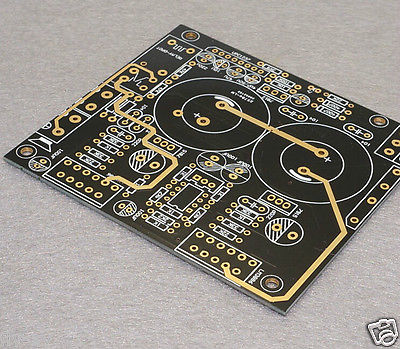

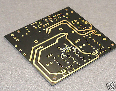

I don't like that there's no powersupply caps by the second 3886.
6 USD for the big caps is okay. But what are the small ones? Input coupling? If so, I'll just drop some film caps in there and let's roll 😀 If filtering for op-amps, then any electrolytic works.
Small caps near chips? Just solder them onto the pins.

That's the easy part. The hard part is finding a very close ground to connect the hf ps bypass caps (100nF, leads as short as possible.) Then when you do find a close gnd, it has to be able to handle the hf without polluting other parts of the circuit.
Same thing for the mid-freq (mf) bypass caps (100-1000uF, leads as short as possible.) Except this time the gnd has to be able to handle the larger mf current spikes without polluting other parts of the circuit.
[Same principles as opamp bypassing ... and digital!]
But this is just trying to up the performance closer to the 3886 spec. The 3886 works with even the most haphazard layouts. It just doesn't work as good as it could. 😉

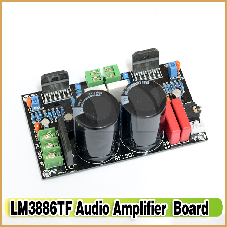

I'm in between these kits:
Audio Power Amplifier LM3886TF Amp Board Kit Rectifier Filter Power DIY Kit | eBay
Looks good with good components. Not going to tell them to assemble it, but I will tell them that I want the high quality components as said in the description. It's also nice that it has an external rectifier board with nice caps.

I think I'll go for the first kit. PCBs look good, everything needed is included, etc... They claim good quality components in the description, and I will make sure to point out to them that I want those good components.
And even if I get fakes, so what? A fake LM chip is going to have inferior performance probably, but that's no big concern, since I won't be using it and my friend is no audiophile. Also his speakers, Beag HOX41 are not the most revealing, so micro details in music, exceptional THD levels, etc... don't matter.
If the caps are fakes, then my local electronics supplier sells high quality Panasonic FM caps for real cheap, and a set of caps for that circuit would cost (excluding power caps) less than a few bucks. Connectors on the boards seem decent also. Not sure if you can fake resistors, so again, no big deal.
This really isn't supposed to be an audiophile amp. What my friend is really looking for is a decent, above mediocre sounding amplifier that has good bass and overall clear sound and enough power to push the Beags. And I also have all the necessary components to finish the amp: enclosure (Yamaha receiver chassis), power transformer (~700VA), connectors (RCA and binding posts), pots, switches, wires (all cost a total of less than 5$)
All I need is the modules and power supply board, which is exactly what this kit contains. So I think I've made my choice 🙂
