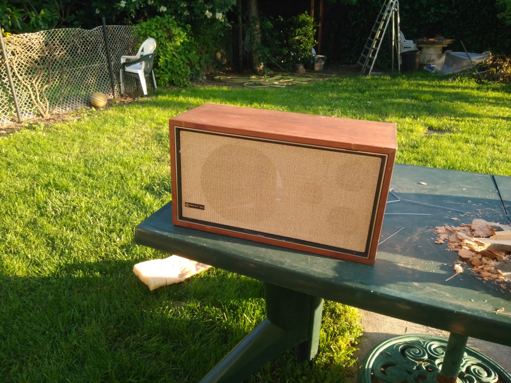

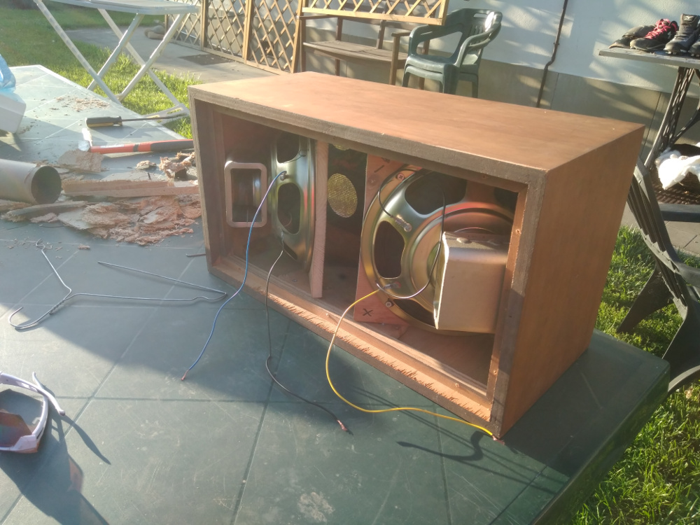

Changing subject of the conversation, I’ve just ripped out of a pair of old Criterion 100b two 10 inch woofers that I’ve read good things about (one guy was even claiming of having used them as replacement speakers in a Fender Champion xd or something like that, don’t remember). To avoid building a cabinet from scratch, I was thinking about using both of them in one of the original cabs and leaving them in free air. Do you think these would be a better bet than the original Wharfedale Dovedale 3 woofers?

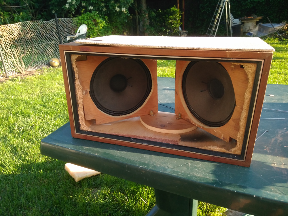

In the meantime I finished my little guitar cab project. Looks very rough but the sound should at least be interesting. I'll post some pics when I can. Bye

As promised, I'm sharing with you my not-so-new 2x10" guitar cab. I've chosen to place the speakers like that for three reasons: it looks cool, even though the woodwork sucks (or maybe THAT is why it looks cool), it was the only way to make them fit in that old speaker cabinet and it gives me a wider horizontal dispersion.
It's something put up in one afternoon, I didn't really care for pretty aesthetics since the speakers will be covered by the grill. I sure enjoyed not having to worry about Hi-Fi stuff for once.
I still obviously haven't really tried it out; but I've watched a video from a guy who was going straight from the Harley Benton AC TrueTone pedal to the DAW and thought that it might approximate what I'm going to hear, and I really liked what I've heard. If my ears don't betray me, these woofers should have a very pronounced spike in the mid frequencies, because they were literally drilling by eardrums. I've connected the cab to a Lafayette 44w (but I think more like 4w) amp which is probably as old as the speakers and distorts just as much. Maybe I'm even going to end up using this one instead of the TDA3116d2, who knows.
Anyways, hope you liked the pics. Wish you all a good weekend
