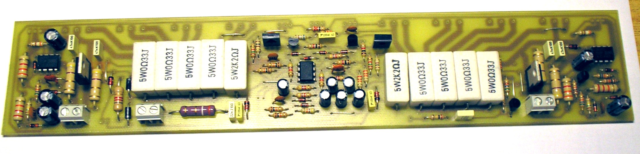

Look in this thread by Apex Audio. His designs sound very good and use similar front ends and drivers with some designs having more and more output stages. The bigger the amp name number, the more stages and more watts. One nice thing with his designs is that they don't require exotic parts, in fact, I source my parts almost exclusively from Aliexpress and they work well.
http://www.diyaudio.com/forums/soli...imate-fidelity-amplifier-768.html#post4732054
You get the idea... as the number of transistors is indicative of more power/complexity.
