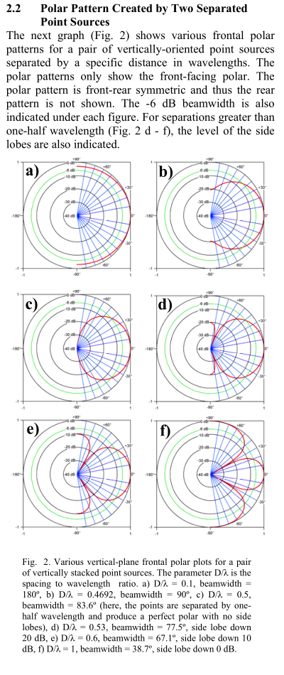

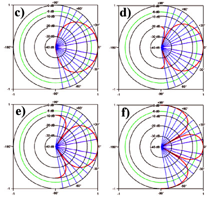

The fundamental idea behind the paper, is that the elements are spaced at 0.757% of a wavelength, and the crossover filters use a specific shape. Each element in the array is underlapped a bit.
In a nutshell, the array uses a specific combination of crossover filter shape, spacing, and xover points to approximate a full range source with controlled directivity. It does this without resorting to the use of a horn or a waveguide or a curved cabinet to control the wavefront shape. The baffle is flat.

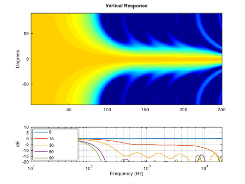

I've found the H-K paper to simultaneously overcomplicate the crossover design, and fail to generalize the concept of nested arrays. Each "nest" in these nested arrays need not be restricted to 2 drivers. Also, if you follow the spacing requirements, you don't need to apply H-K filters. Fourth order linear phase filters work fine, as shown by Kimmosoto and confirmed by me in this thread:
https://www.diyaudio.com/forums/mul...traight-cbt-passive-xos-eq-4.html#post5606349
Additionally, I find 75 degrees to be too wide. Most people have floor and ceiling reflections between 30 and 45 degrees off the vertical axis. To suppress those more significantly, the beamwidth has to be more like 40 degrees. Unfortunately, the narrower the beam, the more difficult it is to achieve consistency.
I also showed that this can be done with passive crossovers, and I have since designed a simplified 3-way that works in a flat-pack cabinet for about $750 a pair (including drivers, crossover parts, and cabinets). Info available here:

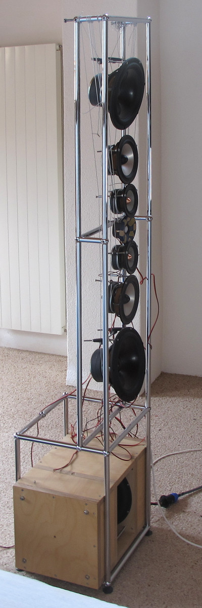

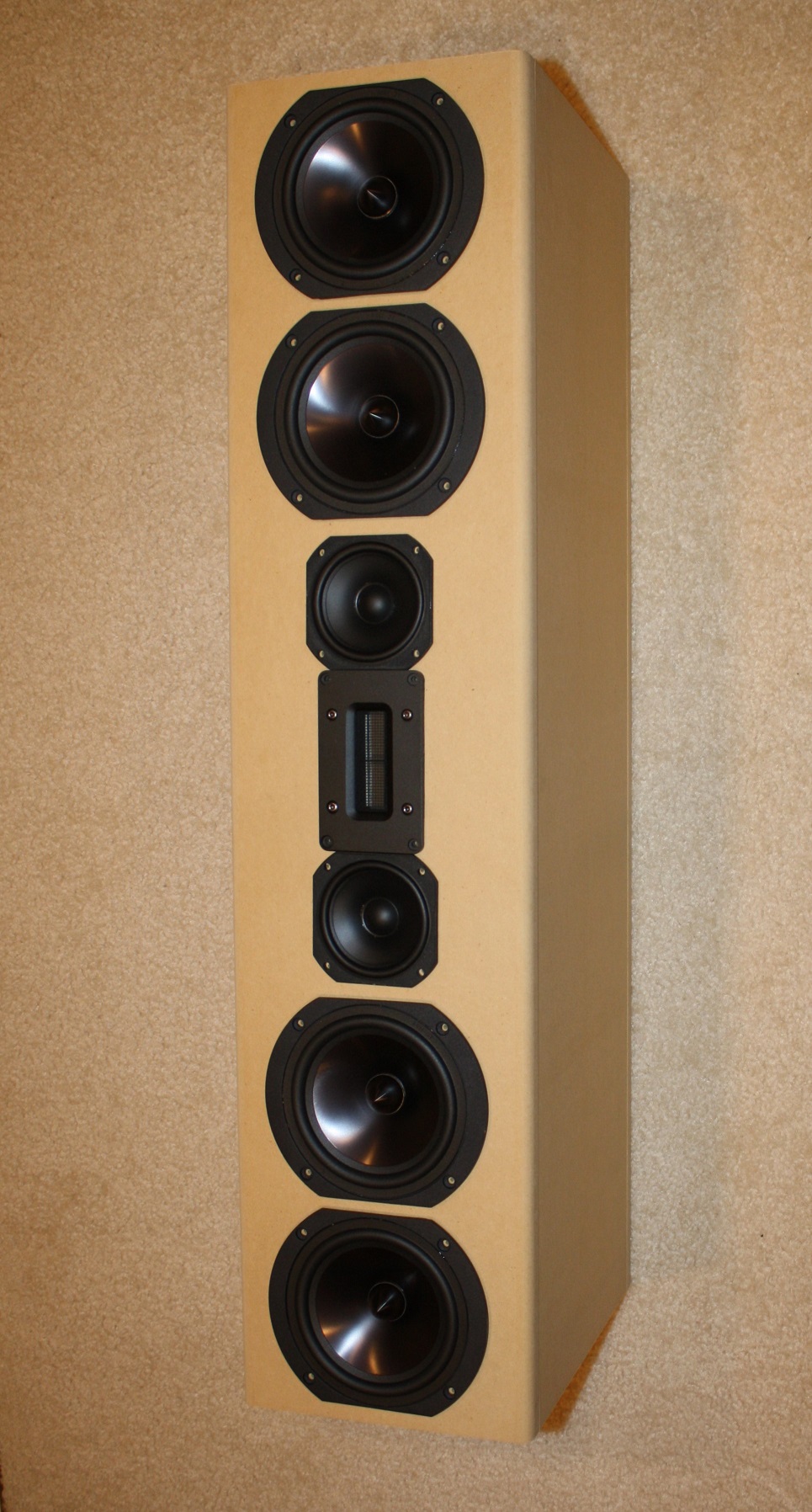

Skylark Flying Towers: Nested Array Speakers in Denovo Cabinet -
Techtalk Speaker Building, Audio, Video Discussion Forum
Those speakers were certainly designed with high output capability for home listening in mind, but aren't for sound reinforcement in large spaces. FWIW, the tweeter is rated at 94 dB and takes 25 watts, for a theoretical 108 dB continuous.

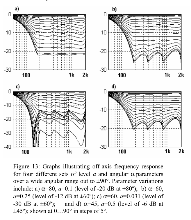

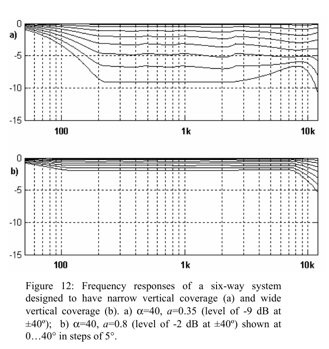

Elegance . you are right. But there is no "magic", fixed ratio in Horbach-Keele at all. 0.757 is as right as any ratio between some <0.5 ... >1.0, which will uniquely influence on the constant vertical polar.... The Horbach Keele design, though criminally overlooked, is simple and elegant.
The fundamental idea behind the paper, is that the elements are spaced at 0.757% of a wavelength ...
To understand Horbach-Keele as a DIY-er it is mandatory to read part 2 of this (!) paper:

This paper was too theoretical for me. I did not understand it fully, but as said, it is not necessary to be successful. Working through the aforementionned part 2 will do.

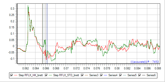

... Additionally, I find 75 degrees to be too wide. Most people have floor and ceiling reflections between 30 and 45 degrees off the vertical axis. To suppress those more significantly, the beamwidth has to be more like 40 degrees. Unfortunately, the narrower the beam, the more difficult it is to achieve consistency.
Again, and as in my prior post: The vertical behavior of the resulting, frequency independent dipole characteristic of Horbach Keele can be tailored to one's needs.
Ceiling/Florr reflection inhibition? Yes, please ... Exactly here is where Horbach-Keele shines: Configure your physical array and your parameters of the Xover such as to decently send the dipole null precisely into the angle of the reflection:
By this trick, the null will be reflected. Null=nothing at all. This holds true for only one hearing distance = one projection angle, but you can adjust the angle of the null from 90° to <30°. This works very well, as shown by a prototype of mine:

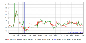

The step response shows the result of the full array (red) and the more traditional bottom half of the array (green). The highlighted area shows where the floor reflection happens. The measurement was made once and at the theoretically expected minimum. Further refinements such as adjusting the measurement distance to even better matching of the null were not performed.
This shows that Horbach-Keele is very well able to inhibit floor reflection and thereby to minimize the ceiling reflection. You are encouraged to try it yourself!

I didn't mean to imply that the response can't be tailored, only to warn people that the target beamwidth identified earlier in this thread wasn't necessarily ideal.
It's not clear to me why you have decided to refer to array beam response patterns as a "dipole" characteristic.

I have discussed the option of turning off the top half of the array with other builders, but never done it (harder to do with passive crossovers since impedance changes). It's cool that you were able to do that. Did you have any listening impressions to go along with that change?
I forgot to mention that one thing I hope to be able to do with the skylark speaker build is to rotate the speakers 90 degrees in the middle of listening; thus switching the dispersion control from vertical to horizontal, to get a sense for how that impacts perception.

As I understand it, when you have a pair of drivers they'll generate an interference pattern. If the spacing is between zero and one third of a wavelength, the two drivers will basically behave as one.
As the spacing approaches one half wavelength, the beamwidth narrows to about sixty degrees.
As the spacing approaches one full wavelength, the on-axis beamwidth narrows, but you also get lobes OFF axis.
Arguably, the strongest and most consistent nulls are at 30 degrees off axis. I think this is part of the reason that the array's beamwidth is in a range between 30 degrees and 75ish degrees.
The nulls are geometric. They're caused by the fact that the pathlength from the top radiator to a point 30 degrees off axis, is about one half wavelength shorter than the path from the BOTTOM radiator.
