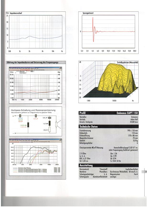

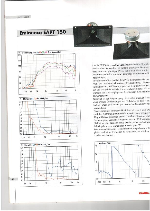

eminence
Tested by K&T low thd was the same quality as others how are 10 times more expensive.
