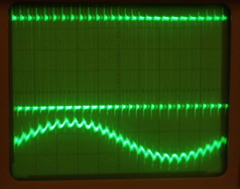

what do you expect?? its like any d-amp...
see (in german, but lokk at the pics 🙂 http://sodfa.so.ohost.de/include.php?path=forum/showthread.php&threadid=146
without signal : about 3vss sine at 250khz out, the carrier
with full signal, a pic:
