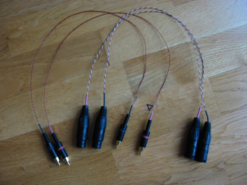

While it didn't seem like a whole lot of of people took me seriosly when I told you about the "GainWire" ( http://diyaudio.com/forums/showthread.php?postid=287921#post287921 ) I'm hoping you will this time.
Here's a cheap, easy to make and very good performing interconnect:
1. Get some 30AWG "Wirewrap wire". The one you want is made of silvered solid core copper with teflon coating. Here's an example http://www.elfa.se/elfa/produkter/no/178479.htm
Price is about 25 cents/meter
This cable you can also use as internal signal and power wiring in all line-level equipment.
2. Get your favourite RCA/XLR connectors (I use Neutrik's -very good and reasonably priced)
Price: RCA $2 a piece, XLR=$7.
3. Cut to length, twist with a hand-drill and solder your plugs (solder with some percentage of silver is recommended). I also use some Polyolefin heatshrink inside the plugs to make the strain relief effective.
So, there you are:
1m pair of RCA cables: ~$10
1m pair of XLR cables: ~$30
For those who are interested; the capacitance is about 20pF/m. If you desire a more rugged cable, you can thread the twisted pairs through some PTFE tube of suitable diameter.

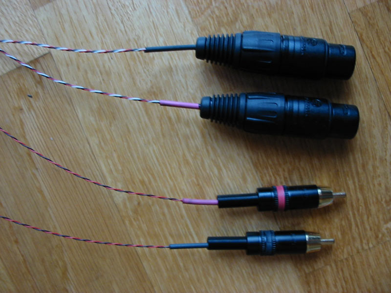

If you require a screened version, you can get some screened heatshrink tubing http://www.elfa.se/elfa/produkter/no/177861.htm
The finished cables:
Maybe you need some glasses 😉
Yes they are thin, but also pretty tough because of the teflon coating. You want thin cables to achieve high bandwith.
I forgot to mention; it took me about 2 hours to make these two sets..

hum, i knew someone who made some just like that, 20awg, silver coated copper, teflon insulated. they sounded so terrible. im not sure what happened.
Terrible you say? The cables I made sounds really nice, and they haven't even burned in yet. They do however sound a tiny little bit brighter than for example my GainWire (made the same way, but with 24AWG magnet wire and PTFE tubing). These are also a little clearer/more revealing. Maybe if you have a overly bright sounding system or equipment that should be masked by some cable-effects this one is not for you
edit: with my el cheapo/xbzls/balanced gainclone I prefered the GainWire-interconnects, but with the pacific/bzls/soz I think this one is much better. Haven't found a catchy name yet though 😉

I've done the same , using the same wire-wrap wire from Elfa,
the resulting cables sound pretty good, very open 😉
I soldered mine directly to the amplifiers, no phono plugs.

-You're welcome. They where measured with a very expensive LCR meter at work, and showed 20-30pF depending on how tight it was twisted.
Glad you like it too; I'm getting a little ****ed when I think about that people feel they need to buy cables for thousands of dollars. (I'm also a little ****ed at myself -I used to be one of those people until I escaped from Audio Hell
