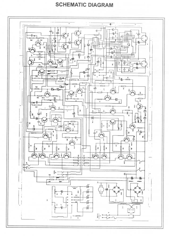

I'm guessing no one is familiar with it. Do you have a manual or schematic. Finding one may get things started for you.
Also, do you have an oscilloscope? Does it run warm / hot? It may be oscillating.

here are some pictures from within the amplifier.... the power supply looks to be extream bottom of the line.
i don't have an osciloscope. But if the amp were oscilating wouldnt the output be weak?... I have an unrepairable marantz 510m, Missing one of the main drive chips, would the preamp or possibly the power supply from it be any use to me? I am going to check the outputs on the power transformer, but if anyone already knows what they are that would be extreamly helpful.
gemsound amp
This thing looks better then I thought it would! Looks to be a true 160 to 200 watts per channel, and probably about 350 to 400 bridged, by the outputs and transformer rateings.
Rewire the thing, get the signal line from the power lines, get read of all that AC line sitting on top of the right amp board ect....
looks like typical cheap construction, look for resistors in the low signal line that are sitting with an extra inch of lead length on the output boards, stuff like that, then look at 1% metal film in critical circuit areas, it a straight forward design no surprises.
