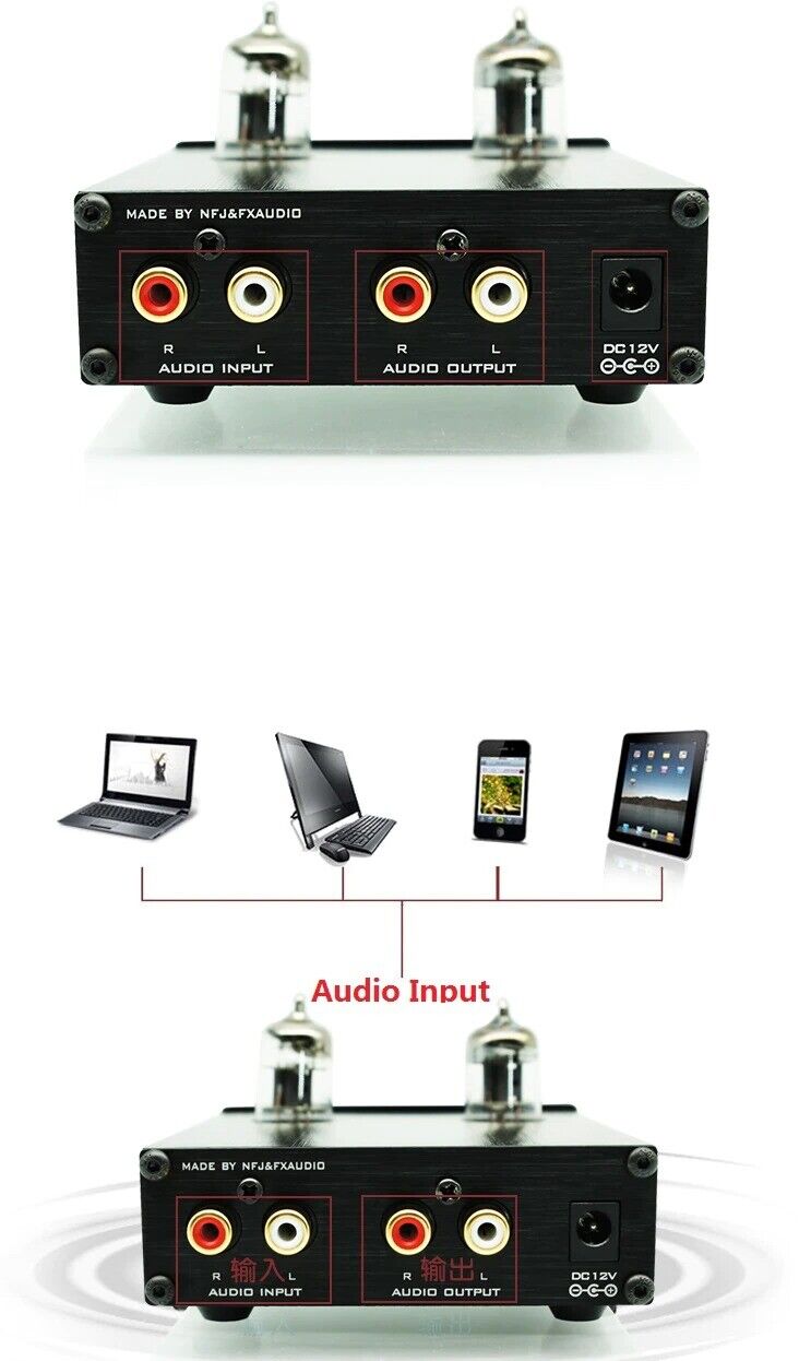

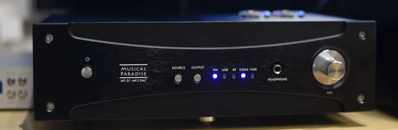

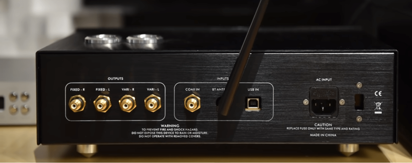

The first one on your list is just tube preamp, disipite it's description, it only accept audio input, while a true (tube) DAC accept coaxial, usb or bluetooth input. Non tube usb DAC preamp is cheaper (and maybe can opt for the DAC chip type you like).

Very, very nice, but the $500 price tag is way too high. I don't necessarily need a DAC as I could use the D/A converter in my DVD/CD player, which isn't too bad for 2-channel audio actually. It has decent Burr-Brown chips in it. So I am torn between just a plain old tube preamp or some sort of DAC. I just need something between my DVD/CD player and my Dynaco ST70 series II because it has no volume control, and I just don't know what direction to take or what might be decent quality. The four links I posted earlier are all I have been able to turn up so far that might be suitable for the job and within budget contraints.

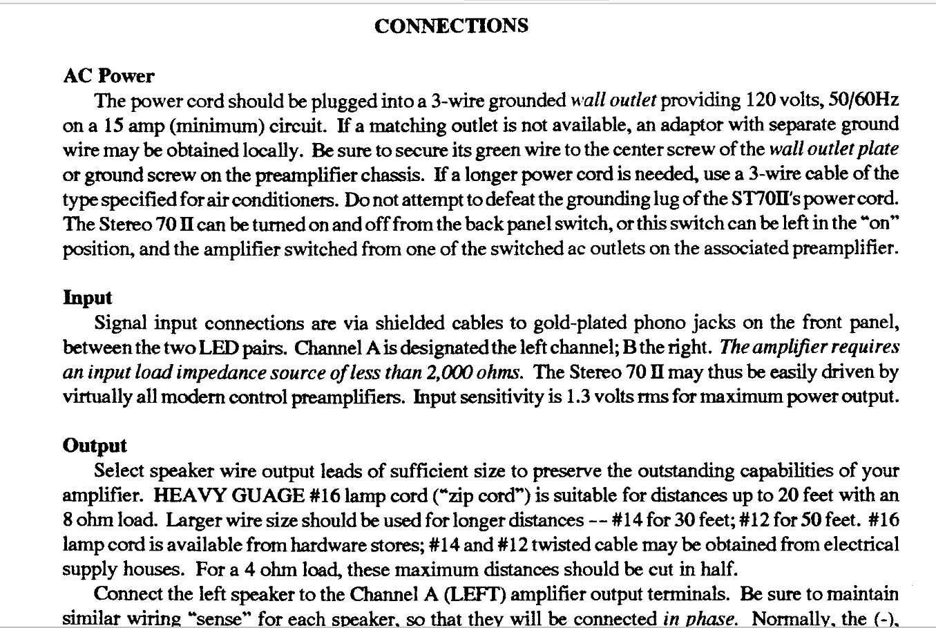

ST70 input is 1.3V rms to full output, that is something to consider, avoid preamp that output more than 3V rms.
And it also said input impedance should be less than 2K?

Even though the factory spec for the input sensitivity of a Dyna ST70 is 1.3V to full power, it measured more like 1V to full power (https://www.audiosciencereview.com/...review-and-measurements-of-dynaco-st-70.7224/).
The input impedance of a Dyna ST70 is way up there at 330k ohms (https://www.stereophile.com/content/dynaco-stereo-70-ii-power-amplifier-measurements#:~:text=The input impedance of the,typical of many tube amplifiers.).
Since the output impedance of your DVD/CD player is probably about 1k ohms (or lower), I think this is a candidate for a 'passive preamp'. The problem to be solved is to keep the source impedance at about 1/10th the load impedance. 1/10th of 330k is 33k.

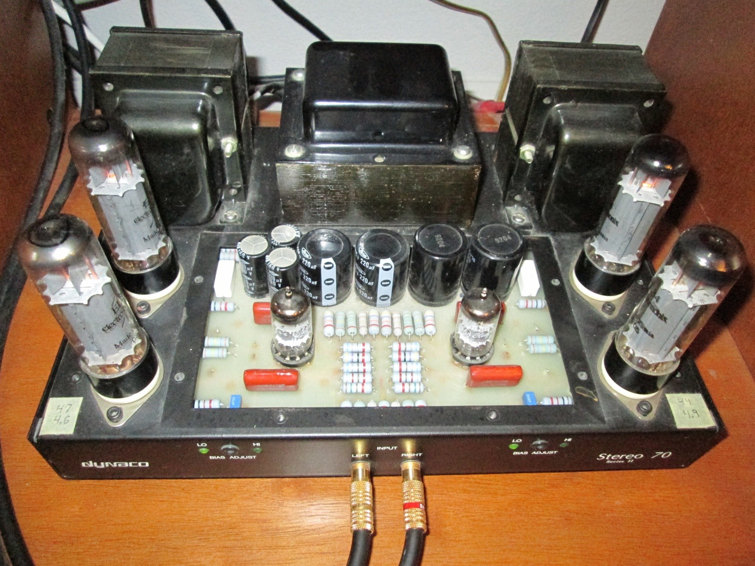

With the ST70 ii inputs on the front, I always end up with about a 3 foot run to get from the shelf next to it or above it to the front of the amplifier. The front inputs always have annoyed me, but there is no room on the back, and the signal flows nicely from front to back the way the amp is laid out. I actually gutted it about a year after I bought it (new) in 1993 and replaced all of the components. The way it came from the factory, every time a tube went bad, it burned up at least one resistor on the board and often others nearby. What a pain in the neck. So, I used a little piece of fiberglass that I had on hand and wired everything point-to-point underneath it. Haven't had a problem since. I put better power supply caps in it and had a machine shop make a new metal cover plate for it because the caps were larger diameter. I think they charged me about $10.

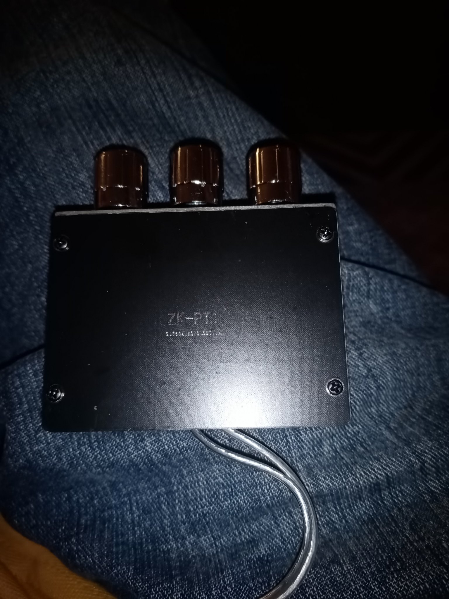

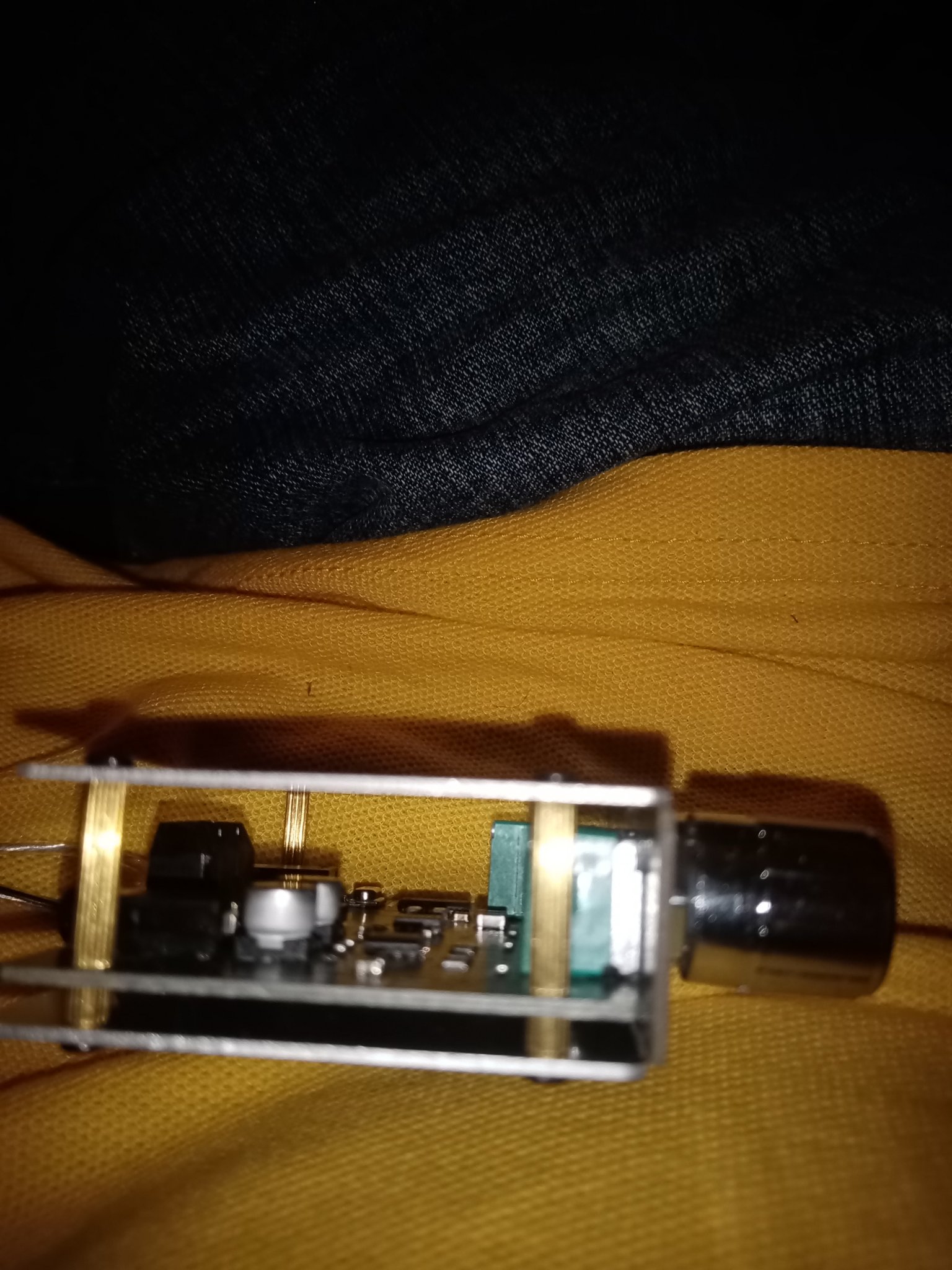

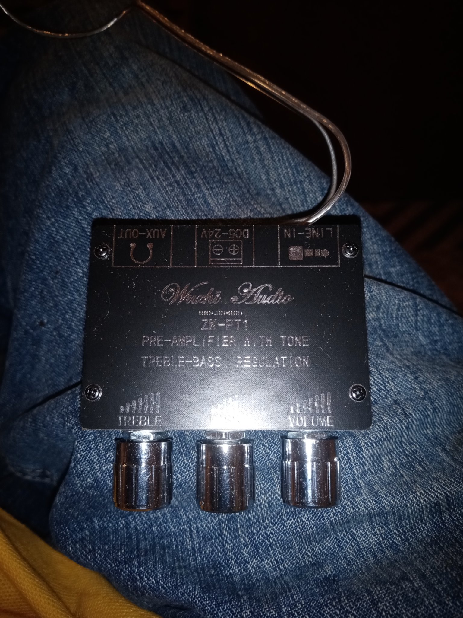

I use whuzi audio zk pt1 for 6 euros it has ne5532 tone control and good Bluetooth. Works perfect with usual 12 or 15v wall wart.
It's dead silent and sounds perfect
Got it from aliexpress
