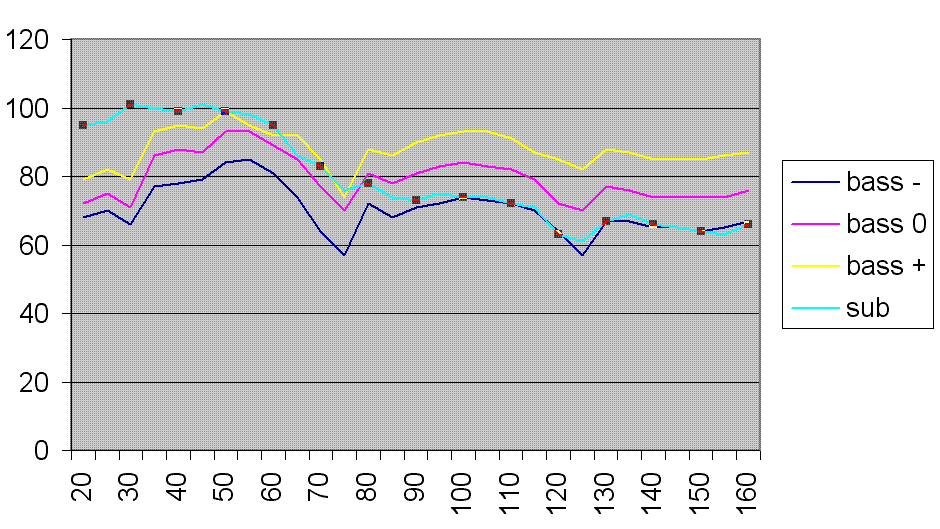

The way I have it set up right now is the bass on the HU is turned down all the way to prevent the speakers from bottoming out. Even at this setting, when turned up ~3/4, the speakers still have to play a lot of bass. The bass adjustment affects frequencies from ~20-160, maybe even higher. So with the sub only playing up to 80 hz, I'm missing the 80-160 hz range. The reason why I want to cross them over is I want to be able to use the bass adjustment on the HU without worrying about the stock speakers bottoming out from trying to reproduce the really low bass.

Actually, I am. The sub amp isnt that great. I have the gain turned up all the way, and had to turn up the bass boost quite a bit to get decent output from the amp. The bass boost is centered around 30 hz, so that screwes up the flatness of the response curve. Attached is the FR curve that I measured once. It shows where the bass boost is, and the cutoff of the LP filter.

I will be building a new LP filter to go with the rest of the system, and possibly a new amp too, so the cutoff will be whatever I will need.

Hmmm, in that case I would go a bit higher than 80Hz since that does seem to be your Fs on the sub driver. Maybe try 300Hz for the HP, 150Hz for the LP? then you can have fun with zobel circuits.
