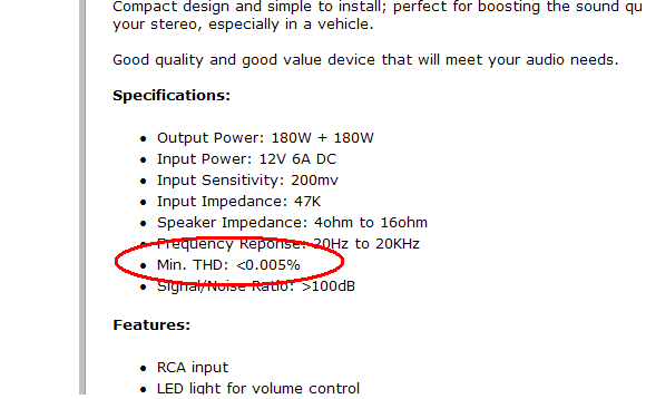

It says 180 W + 180 W , into 4 ohms I guess as the load impedance range is quoted as 4 to 16 ohms.
Power supply requirement is 12 V at 6 Amps. Thats 72 watts power consumption and 360 watts power output ! That means the output power is about 5 times the input power !
That explains all I guess.

Ashok summed it up with the magical power output.
I like the specs, minimum THD - is that with the unit turned off?

They are probably chip based (and cheap) amps.
12V, without dc/dc PS, bridged output, about 20W RMS, and a lot of THD. A great piece of blue junk.
