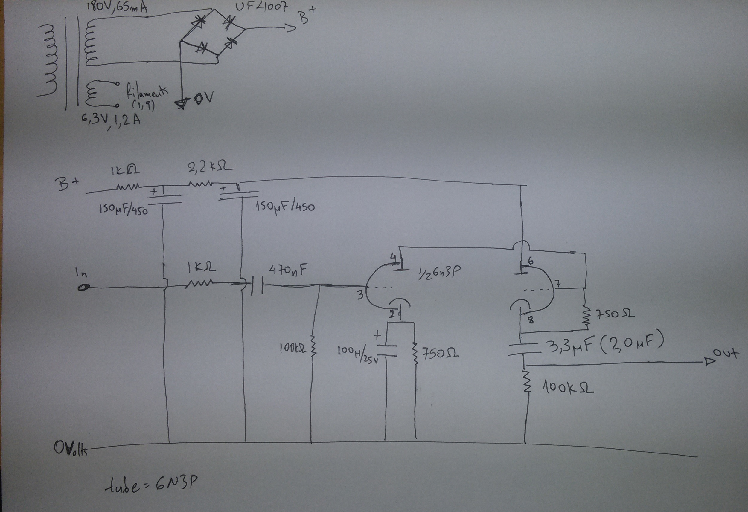

Hi, I recently decided to enter into the tube amp field having assembled lots of chip amps, and for start I purchased a cheap Chinese preamp based on the 6n3-j Chinese tube ( equivalent 2C51/ 5670/ 6n3p), to assemble troubleshoot and of course start learning.
The link for the purchase/model is the following:
Aiyima Updated Tube Amp Preamp 6N3 Vacuum Tube PreAmplifier SRPP Board Diy Kits Fit for 5670-in Amplifier from Consumer Electronics on Aliexpress.com | Alibaba Group
Since the kit does not come with the schematic I tried to reverse engineer it.
I came up with the following attached file.
However it doesn't look very solid.
What are your opinions?
Is the 470nF on the signal input going to affect much the lower frequencies?
Also the recommend transformer is one with a secondary of 180V, 65mA which following rectification will go to about 250v. Isn't it to high for this kind of Tube?
Does anyone got any recommendation on the schematic and/or the power supply?
Cheers!

The schematic contain a number of tracing documentation mistakes. I could only guess the first stage design is a common cathode and the second stage is a cathode follower. ie. Rplate of 1st stage is missing. 1K grid stopper and input coupling cap reversed. Output coupling cap connected wrong and etc.....
Given the high input impedance, the 470nf, if anything, is on the high side. It should not effect low frequency.
250V B+ is about right for the 5670 tube

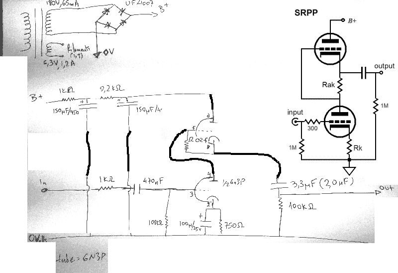

The plan *appears* to be a form of SRPP.
There are billions of variants (and boo-boos); John does not begin to get to them all in his excellent essays.
Your plan is apparently correct. I have re-drawn it in the usual way but this is equivalent to your drawing.
The 250V splits half to each triode. Each feels only about 110V. (In general, tubes never get the full supply voltage.)

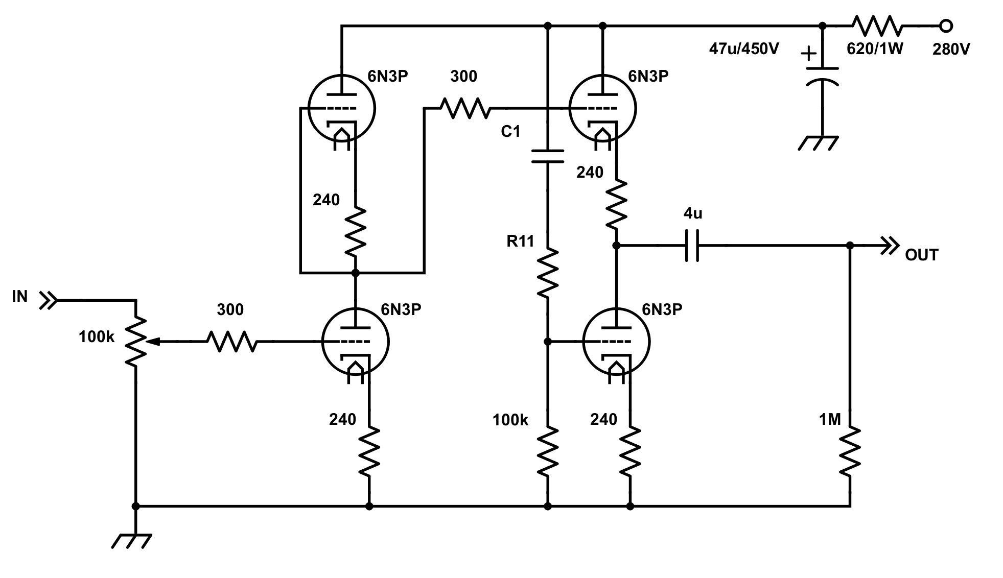

Thank you all for all the replies, I sure have a lot of reading to do about the SRPP topology and in general about valves. Broskie has defenetely a good writing style and approach.
Do you think that I should go for a higher voltage for the secondary, since 6n3p are recommended for 150V?
Cheers.
Cheers.
I'd start with the recommended voltage and see how it goes. Measure the power dissipated by each triode and compare to tube's specs. If it's a very small fraction (say less than 20%) of the total dissipation the unit probably won't sound very good. The tubes just won't have enough current flow to wake them up.
If at this point you want to increase the B+ be aware that it shouldn't be more than the voltage ratings of the lowest rated capacitors. The PS filter caps look to be 400 volts so you're probably OK there. The output caps look to be rated at 250 volts so the B+ shouldn't be any higher (best if it's slightly less than) 250 volts.
Good luck, Steve
Good luck, Steve
The max heater-cathode voltage for the 6N3P is around 90V. I wasn't sure how to implement DC heater elevation in this topology.
Yes, it's rated at 90V, but I've been running 150V for years with no issues. The tubes are about $1 each, too. See the schematic I posted. I never elevate the heater.
