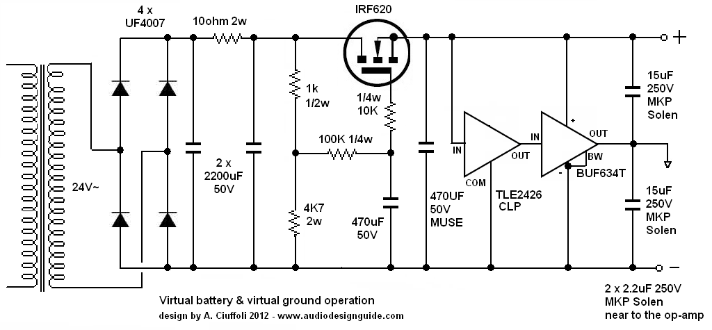

The use of these op-amp with very low value resistors and the virtual battery operation allow zero noise.
It is easy: create negative noise, add it to positive noise, they cancel and voilá: you get zero noise
Well, the low level in the measuers are -80dB, very good for a phono preamp but no 'zero noise'. Yes, really very low noise.
But, for me, the most interesting part are the power supply... that lacks the values of the components.
Have you the complete values of the power supply? Please, can you post here?
