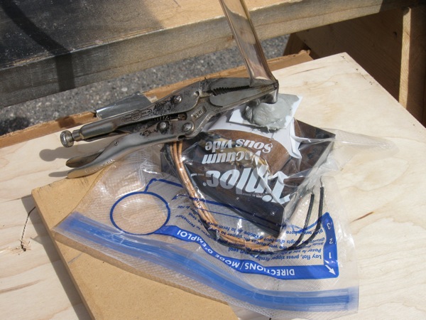

Everything is sealed up with flexible butyl caulk that my engineer friend refers to as "dum dum". You can get it at the hardware store, though I don't remember the exact name as I bought it years ago to use for speaker gasketing. The bag is 1qt. The most difficult thing is getting a good seal to the tube. In addition to the caulk, I used a homemade plastic washer.
The pitcher was chosen for it's stiffness, sealed lid, and lid hole size (more about that later). I drilled a hole in the bottom and sealed the PVC tube in with more butyl caulk.
The tube (IIRC) is 3/8" id. I needle nose vicegrips for a valve.

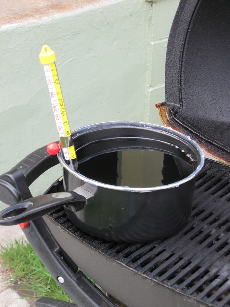

I used a regular natural varnish. I didn't think that the UV protectors in Spar would do anything good. And urethane varnishes aren't as good for heat and vibration. I heated it on the grill (see the silicon remnants of a failed vacuum experiment on the pan's rim). At around 150 degrees F, it was smoking and I decided to stop there. I don't think it was actually smoke, but rather some plasticizers evaporating/boiling off. Still, I didn't want to mess a potential fire, so I took it off the heat.

When I had everything warm (I warmed the transformer in a toaster oven), I bagged the transformer, clamped my valve, and pulled the vacuum. (Then took the pic below). I dumped the varnish into the jug. To get it started down the tube, I loosened the vice grips a bit and let the vacuum pull some down. I clamped the vice grips again just before the varnish passed. Then I held the pitcher up and managed to get all the air out of the tube. I then evacuated the bag again.

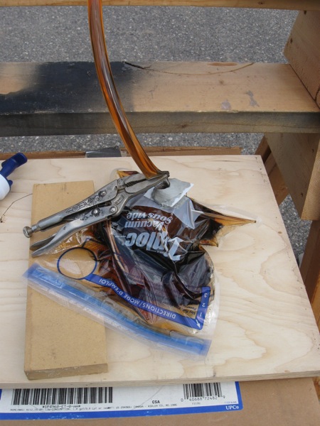

(I actually took that last pic after the next step.) No matter what I did (I practiced with a junk transformer and water to perfect my technique), I still had a few air bubbles. So, once I introduced the varnish, I toss the lid on the jug. I had one of the bag valves sealed into the lid (over the hole) with caulk. So, once I had varnish in the bag, I vac'd a bit on the jug. That pulled (most) of the bubbles out of the bag. Then I clamped the 'valve' and took the above pic. I admired it for a couple of minutes.
I then picked the bag up higher than the jug, and unclamped the valve. I inverted the jug over the pan and dumped most of the varnish. Gravity sucks most of the varnish out of the bag. Eventually a buggle crawls up the tube and you loose vacuum.
It is still curing, so I can't tell you whether or not it worked. I wanted to post this prior to potentially discovering it was for naught. I think the method is pretty solid, especially for a total investment of $10 or so. If it doesn't work, I'll probably give it another shot, as I've got nothing to lose. The transformer had quite a buzz, so I think it is possible that nothing will work.

I was grateful for the light breeze while the varnish was on the gas grill.

Well, it kind of worked! The transformer is now quieter, but not silent. It is now no louder than the big choke. The two of them together are still obnoxious. I thought of trying to vac impregnate the choke, but there really aren't holes for varnish to enter. Overall, I achieved a decent amount of success. The amp sounds really nice.
