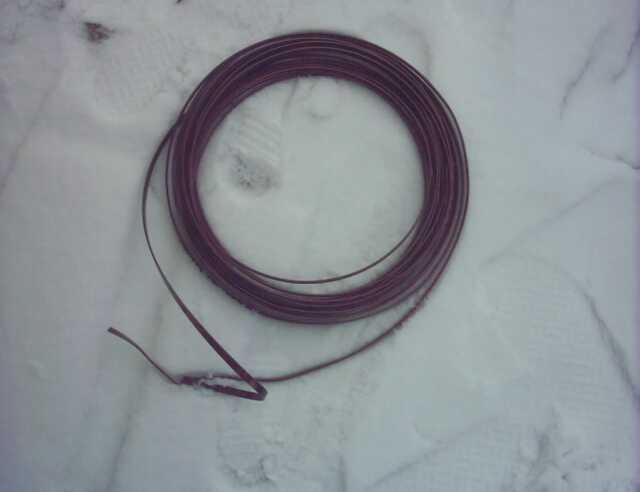

it look a little like a toroidal trafo only smaller... this was from a shop that collect junked pcbs and recovers the parts so that is why it is so cheap...
Hi Till
I wouldn't see any problems with this coil if it was used for a >20kW amplifier.
But you will need two of them for a H-bridge.......
I don't like the idea of using coils as large as the subwoofer's driver.
Apart from that you would run into serious EMC problems with air cored coils that large !!!!🙁
A solution i haven't tried yet would be an air-cored toroidal coil but this would require more windings than a cylindrical coil but have less stray-field.
BTW: The maximum current in an inductor isn't determined solely by the wire diameter, the dominant part is played by the core saturation.
A feasible workaround is to use a core with an airgap.

Hey two would be no prob, i have more than 20Kg of this material here at the moment.... EMC - yes, i hope nobody aroung knows what i do with this - i try to make a little induction - melting - ofen with these. What about metal enclosure? I build one out of 4mm steel for toroids. Should help.
