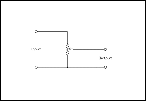

I might buy one of these: https://www.ebay.com/itm/115857687208?var=415953468368 to boost line level to use with a Leslie speaker. Any idea of how to hack in a gain pot? I'm kind of a novice compared to everyone on here, so please be kind!

It's a Leslie 147, designed for use with Hammond B3/C3, but I'd like to build something that lets me use it with portable keyboards. A Hammond preamp is sending the Leslie signal up to ~6VAC RMS (https://www.dairiki.org/HammondWiki/PreampOutputLevel?version=2), so I think it is amplification I need, not buffer right? Would a buffer be like a step-up transformer to match impedance?
I already have built a simple AC power and tremelo relay control (pins 2-5), but my understanding is that the input signal (pins 1 & 6) needs to be boosted. Other forums recommend using an Art MP Tube Preamp (https://organforum.com/forums/forum...s-accessories/39480-signal-pre-amp-for-leslie), so I thought utilizing a simple 12ax7 would do the trick, but wanted to add a pot to make it adjustable. Thank you all so much for your attention and expertise!
