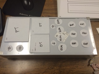

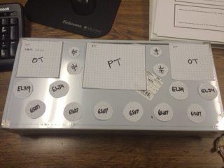

J jjmenking Member Joined 2015 2015-11-13 5:25 am #1 2015-11-13 5:25 am #1 Anyone have thoughts on the attached chassis layouts for EL34 PP? I think both are visually appealing and should make easy grounding scheme. Thanks Attachments IMG_0838.JPG 43.2 KB · Views: 191 IMG_0839.JPG 42.9 KB · Views: 189 JonSnell Electronic Member Joined 2012 jonsnell.co.uk 2015-11-13 10:06 am #2 2015-11-13 10:06 am #2 Make sure your power transformer is not the same way round as your output transformers, otherwise you may get inherent mains hum from induction. D DF96 R.I.P. Joined 2007 myweb.tiscali.co.uk/g8hqp/ 2015-11-13 10:07 am #3 2015-11-13 10:07 am #3 The first one seems to place the input stage rather too close to the PSU. Status Not open for further replies. Share: Facebook X (Twitter) LinkedIn Reddit Pinterest Tumblr WhatsApp Email Link
