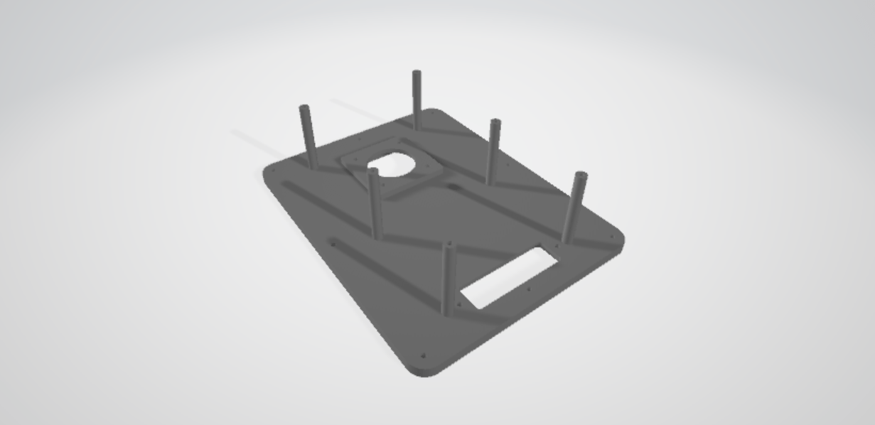

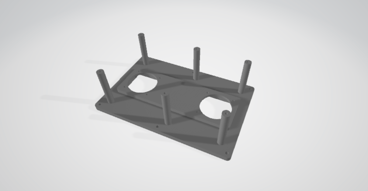

First up is a mounting plate for the FFA001 module. This one is designed to be 3D printed and can be fitted inside a chassis or into active speakers, including instrument amps
Single fan
Dual opposed fans
Fasteners are M3 with the thread printed into the mounting holes. For instrument amps, M3 threaded rods are needed or long bolts if you can find them. The module is fitted inverted with the PCB side up. A 5mm standoff should be placed over the holes, and this will hold the module down and provide a receptacle for a matching metal sheet as screening cover. This isolates the heatsink which is elec active and protects the module entirely
Still double minded about the standoffs. I might do a version without them and instead use 50mm metal ones. This one is for tomorrow to solve
The back of the mounting plate inlays the fans and has allocation for air filters. Mounted inside a narrow chassis, the dual fan version is optimised for air flow around the module components
Nice one Randy! 🙂 Is it crazy of me to think i could print then invert your orientation and have the board upright and fans on top as a kindof cooling shroud over the heatsinks, and then use short metal standoffs as normal to bolt/secure the board through the case floor?
That should work but I’ll need to check for airflow when I get home later today. The plate relies on the gap under a chassis created by equipment feet height and the resistance of two different temp airflow to mix. The non printed standoffs version can mount the module either way but screening over would be more work. Maybe try the way you described and see? Can always snap the standoffs off if that doesn’t work

Single fan version, block the rectangular intake slot. Set fan phase to exhaust, firing out and up through the chassis top panel slot. Or, print a matchbox duct from fan output to a cutout on the rear panel. Will need side panel vents in the case for this to flow right
Dual fan version, set both fans to exhaust and port same as above
These are tiny wafer fans and the purpose is to assist flow, not forced spot cooling. The module doesn't need anymore cooling than that during Qld summers when fitted into a small active cab within a dedicated compartment
The dual fan one will setup a weak twin cyclone inside a compartment (not too big a case) and help cool other stuff in the case too by removing the air already getting heated up and injecting fresh air. Spotlight sells a fabric that will allow good flow but trap lint. This is my biggest enemy in my local humid conditions. The filter fabric just needs replacing whenever and costs I think $16 metre meter length and 25cm is the minimum purchase. The material is organza

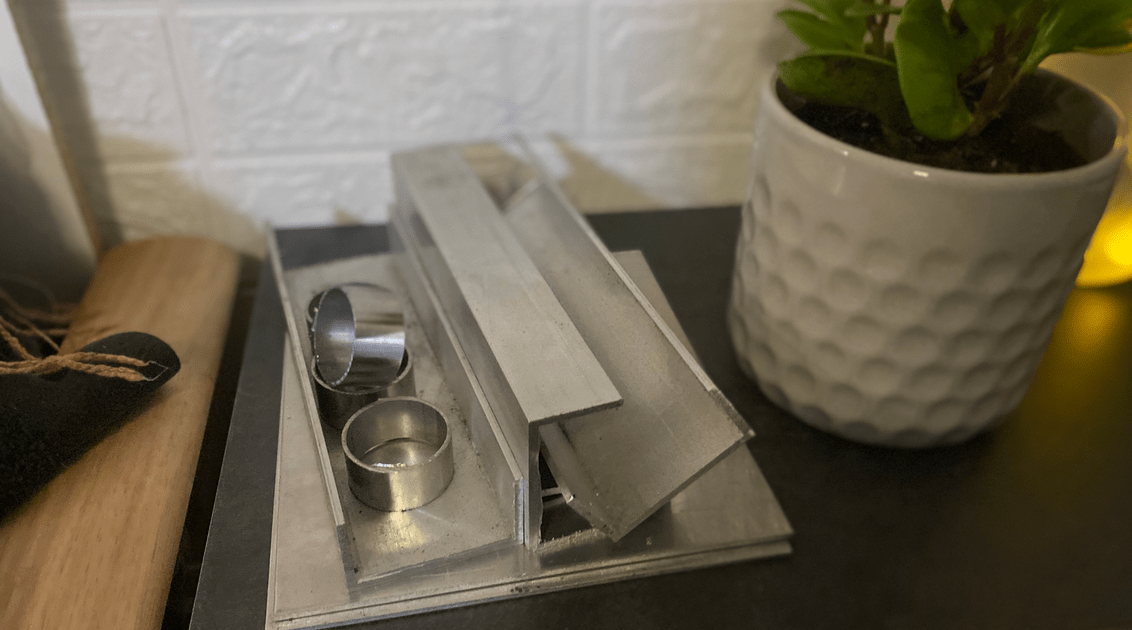

The previous update had some typos. This meant to say highly modular! Sorted out the approach to the basic chassis today. Keeping the 200mm x 180mm x 60mm and maybe around 26mm feet height added to that
Today's loot! These are the main chassis components. The wall thickness for the plate is 2.5mm and the channels are 3mm. The stainless rings are 1.6mm wall. This will be on the strong end of audio cases, and we will focus on a showroom level finish while keeping to very basic systems

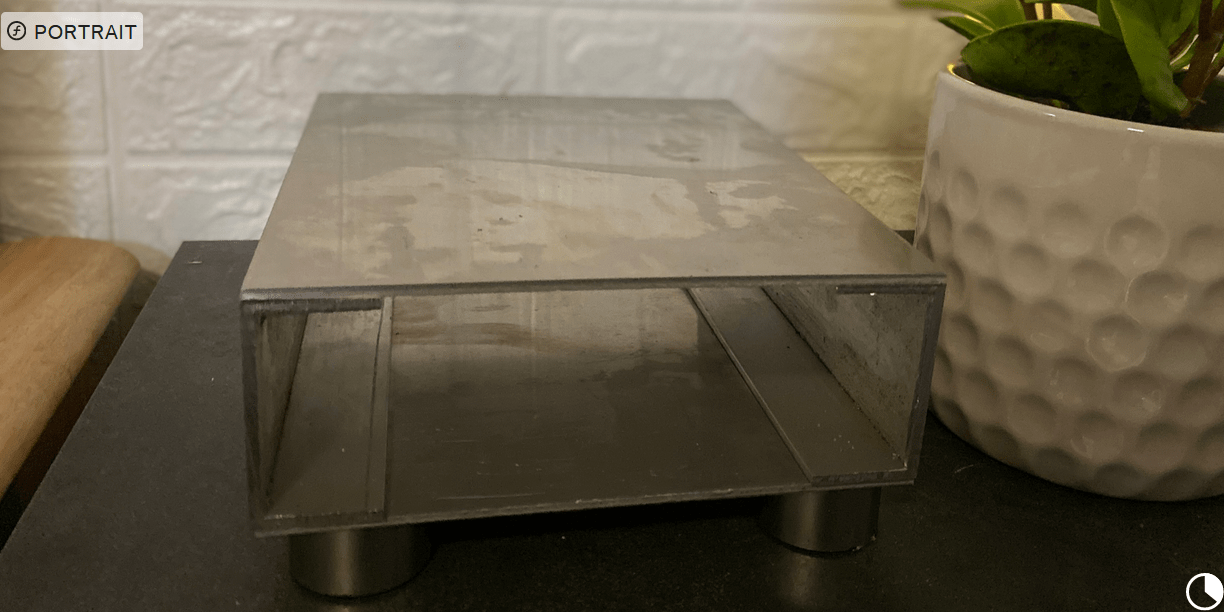

Looks like the shop gave me 3mm plate. I don't mind the extra 0.5mm as 3mm is good thread depth. This is still very much just trying ideas. Haven't drawn a line on paper or CAD yet. I feel the whole case can be completed without any digital studio involvement to a very high level of fit and finish, but let's model it and see if anyone has any ideas to try out in a virtual environment

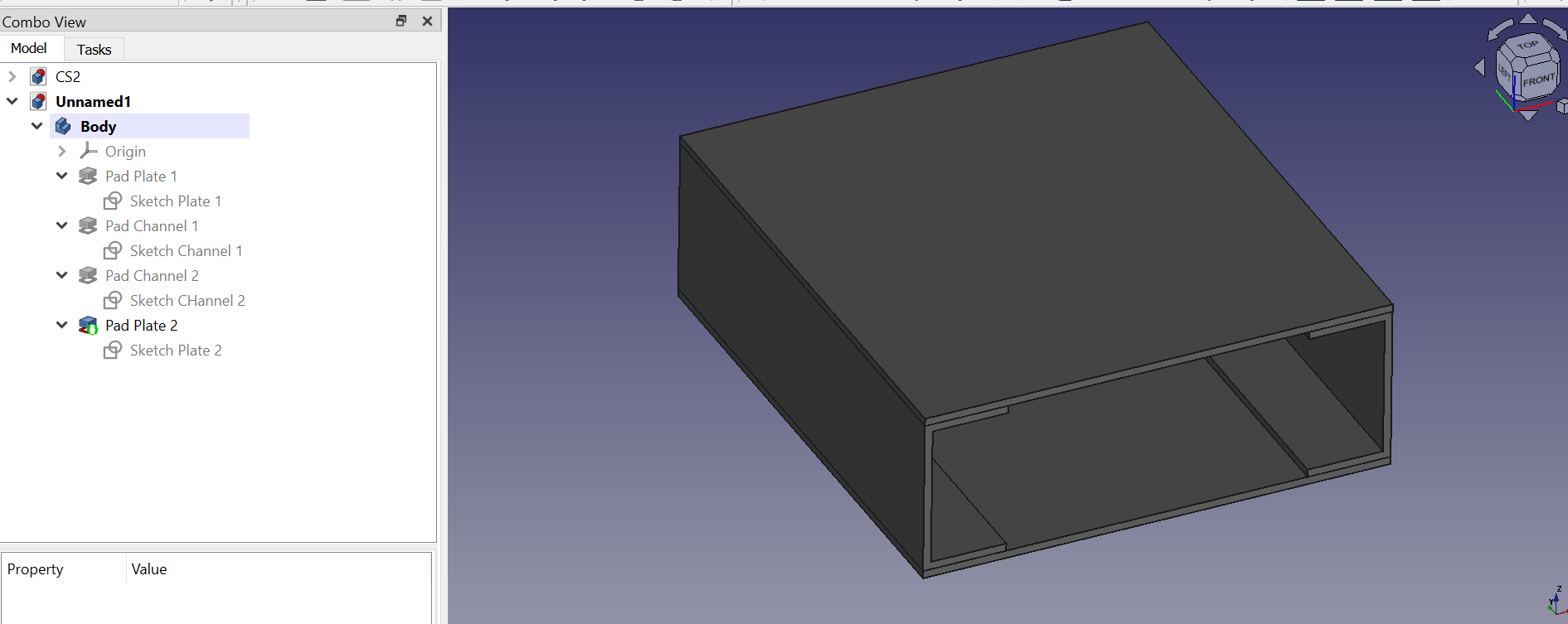

Here is the spirit of the Silver Lady chassis concept, named after a beloved offshore plate alloy workboat operating in Hervey Bay back in the day. This can be resized to desired channel sizes and plate thickness. My CNC allows 300mm x 180mm, so I am able to make a longer version for some of my other projects too. For FFA001 standalone poweramp project, the model is set to 200mm x 180mm x 66mm not including feet
FFA001 Studio desktop amp basic chassis build - Bassinga 300 Home Stage
I see the openings as the front and back panel locations and the channel sides decorated with wooden trims. The fore and aft panels would cap the body and trims. Master volume and main switch inlaid into the front panel and Erica.C's input module connectors plus my custom copper banana sockets inlaid into the rear panel

The finished chassis will have to look the part next to the music instruments but carry its own looks. A build that doesn't look like colour thrown on depends on balancing and terminating colour effects. The planned scheme is purple cut with gold and terminated with silver for the front. Wood grain under glass look for the sides, terminated by the silver and gold of the front. Glass black with popping red cut with gold and terminated with silver for the back. The top, first, will try gold pearl cut with purple and silver. Under chassis might end up being silver. Inside chassis, gold cut with silver and terminated with gloss black
For the FFA001 users, your thoughts on locating the module inside? Offset to allow some space for any front ends? Symmetrical? How has your experience been? The air flow for this chassis will be base panel inlets and rear panel outlets with dual 40mm x 40mm x 5mm fans with cross chasiss flow, for now
Today, I will get a chance to grab some fasteners for this. As a personal challenge, I am thinking of doing the first iteration as a continuation of by the eye and with a drawing in MAD 😀 (mental assisted design). Let's explore what results can be had by some basic dimensions in held in mind, a trip to Steelrite, Spotlight and Bunnings. Let's call this stage 1
We will do a quick and easy type build with off the shelf parts first as stage 1, get the amplifier operational and in use. It's being kept totally modular, so any and all bits can be replaced at any time. The chassis so far also meets what I need from the paisley design, so this will the path to its evolution. This "Silver Lady" chassis will be built as a case for the FFA001 first. Then as a case for Erica.C's other modules. I am considering an "andu" HT system with multiple channels of 120w for 8R full range drivers and multiple channels of 300w for 4 or 8R subs. This would use multiple FFA001 H/B modules stacked on their sides. Another upcoming build will be the EL34 amp kit that I recently picked up
