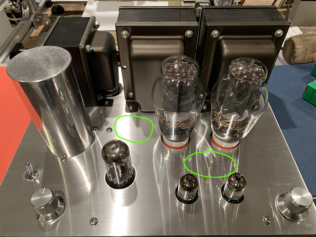

Looking at the top plate of your amp on other thread, it may help to drill some vent holes at two locations I circled in green if still feasible. Even better if there are holes at the bottom plate as well. Those two locations do generate a lot of heat besides the tubes.

Thanks. I have contemplated that. I may end up doing it at some point. For now, I've talked myself of it for a few reasons.
1) It's major surgery. I'd have to desolder, disassemble, etc., and then risk something going wrong on the CNC (then having to start over!).
2) The top plate is 3/16" thick and it does get very warm. So it's acting as a heatsink to some degree.
3) The underside is perforated (60% open, if I recall) so air is definitely able to come up through the bottom and vent around the tube openings (albeit not optimally - hoping the fan will help that). And,
4) I'm still relying on the smallish board-mounted sinks at the MOSFETs. I am contemplating adding a piece of aluminum bar with some relief cuts to the fet heatsinks - in between the two sinks essentially bolting them together back to back. That should help with heat dissipation a bit.
The sink at D1 and U1 is BIG, so I have less of a concern there.
My plan to add the fan is more preventive now that I have the amp semi-apart for the fet replacement.
