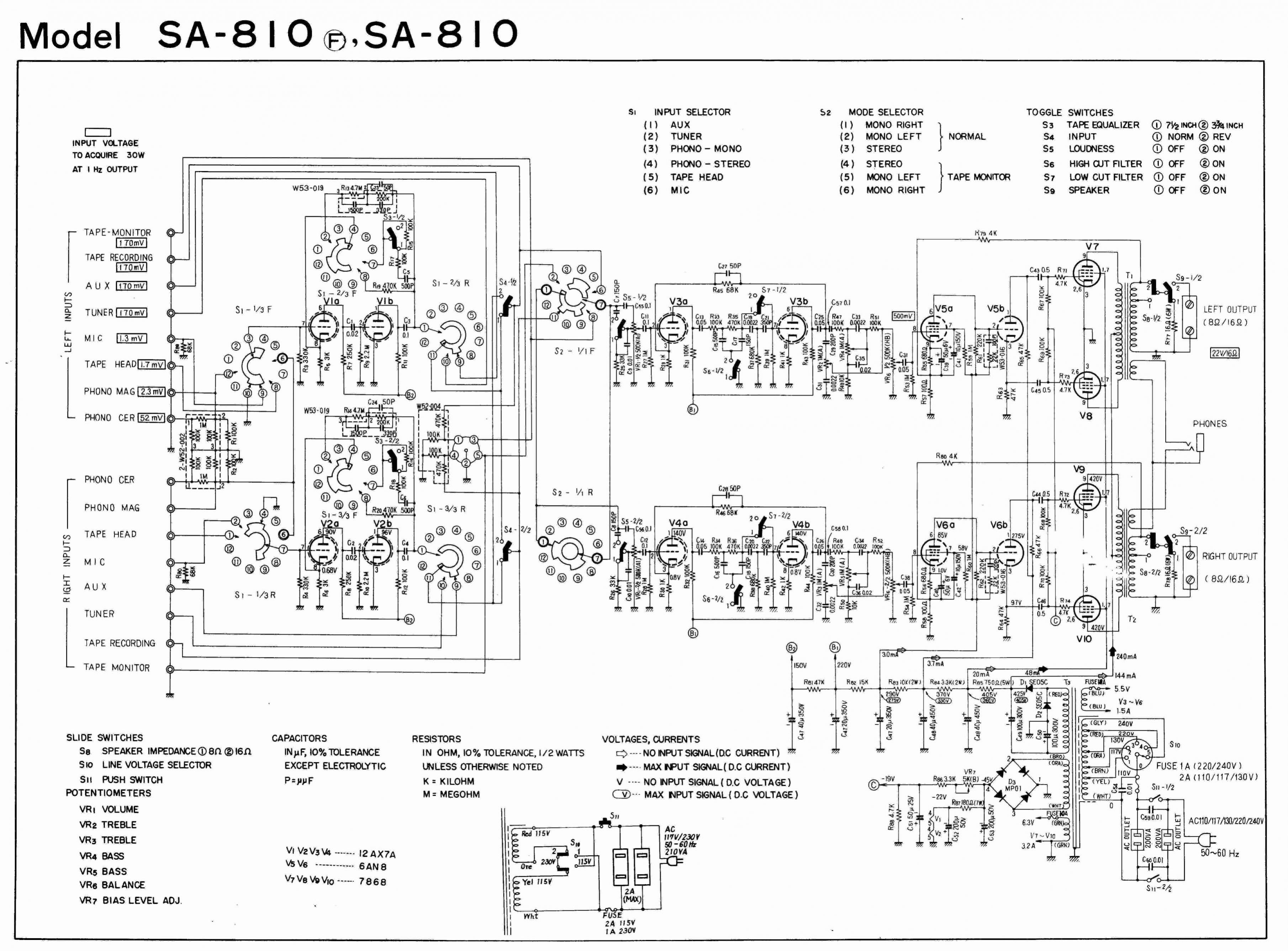

I agree there would be an r/c network added between the each cathode and ground, like the schematic below I just built. Not sure how to calculate those values. Seems from reading here, there are programs like LT spice that can do it. Wondering if a formula exists that could be used? A lot of info here.
Jim

Provided this schematic is for a monoblock amp and there isn't a second channel that's fed, you could use a 440 ohm resistor and bypass cap on each 7868 cathode for biasing. If you have trouble finding a 440 ohm 5W resistor, you can put a 6.8K 1W resistor across a 470R/5W resistor and that will get you a 440R 5W resistor.
Yes,
Build 2 channels off shared power supply using PIO SA-810 design for reference only... not keen about voltage doubler for B+.
Ok,
What would be your opinion on cap to gnd value? Is it needed?
I think the -15 volts at the 220 ohm resistor is right, and the -30v should also read -15v.
The data sheet gives various g1 volts between -12.5 to -21 volts.
Makes sense per the data sheet.
Something else w/ this design seems odd- feedback loop is very aggressive... 270 into 820/10 split on the pentode. For reference, diagram below has very different values. I know overall design dictates individual values, but this seems a bit out of the norm.
The schematic of TS (including the "-30V" mistake) comes from a RCA Receiving Tube Manual.
I think for GNFB it's the ratio of the two resistors that sets the amount of feedback (provided there's enough gain in the amplifier to start with). So the ratio in the RCA amplifier is 270/10 while the ratio in the Pioneer amp is 4K/100 (or 400/10). So the difference is not that big.
