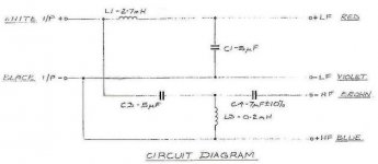

Hi all and thanks.
I took time out to call at WA today I obtained a copy of the crossover drawing/spec sheet.
They assure me that I won't hear any effect other than a sound level increase at the tweeter stage, they say they have supplied others succesfully and have demoed it in shop.
I must admit It's what I heard before and will approach it with some scepticism. A certain other major drive unit supplier doesn't share their view but won't comment further for obvious resons.
They do assure me that at 21 years old it will have poly caps fitted .
On the basis of no crossover schematic being available to me or any idea what the polarity should be, I think you should just wire up the new ones like the old ones and hope for the best!
They will likely sound brighter and a bit fuller at crossover. 1.5dB increase is audible. That's why Allen suggested a resistor or attenuator change. I don't suppose the impedance will go dangerously low, but it will be lower.

Mate, we do it for nothing here! Given enough info. A 1.5dB level adjustment isn't rocket science. Trickier might be giving the tweeter a bit more slope at crossover, because it's flatter and lower impedance. Not too hard though.

Thanks, given that 1 think crossover is somewhere around 3khz, and that I have a sloping hearing response loss from 1.2k to 6k of a considerable magnitude, "a but brighter" is what I'm chasing.
To explain I have an audible threshold of 90 dB at 6k, can recall the values in the speech band.

Hmmm, opportunities. First let me say that if you have hearing loss, a 'correct' speaker response should let you hear things similarly to the way you hear them ordinarily. Still, why not change this if it's what you want.
The 9300 is similar to the 9500. If you want to try something simple, connect the tweeter to the other side of the 5.6 ohm resistor (same as connecting a wire across this resistor). If that doesn't give you what you want, try removing the 2.35 ohm resistor by connecting a wire over it, ie: running the amp straight to the capacitor. Let us know how it goes.
I'd like to say I fully understand which components you mean but even at this level I struggle with that drawing. Why are inductors shown the same as resistors schematically?

Anyone with hearing loss might get some mileage
out of shorting / bypassing the 0.3mH (and 5R6).

Good idea sreten, wish I'd thought of that 😉
Maybe what you want to do is get yourself two jumper cables, just wires with a crocodile clip on each end. One per speaker would be all you need to begin with.

This one is actually quite interesting. The Volt BM220-8 0hm is a modern recreation of your classic plastic polycone in the KEF B200 tradition.
Volt Loudspeakers | BM220.8 (8″)
It's quite well-behaved, as evidenced by the 1.8mH/4.7uf bass crossover with no shunt resistance. What's wrong with it is the awful choice of a soft-dome tweeter. Frankly these things stink. Er, IMO. 😀

That Wilmslow design is rather good IMO, except for the choice of tweeter.

The problem is that a threshold of 85dba at 5-6K is also quite "simply inaccurate"
What I'm trying to do is get the best out of what I have and given the crossover is quite high, below the area I have real issues then a slight boost and a smoother teeter will hopefully help.
Let me put this into perspective from my hearing point of view, I disconnected the tweeter on 1 then both channels and listened, I can hardly tell. Hopefully that may help you understand my issues, theory is fine in a more perfect world, I'm afraid I don't live there anymore.
But thanks to all, I have a few ideas I will float after I've just tried a straight swap

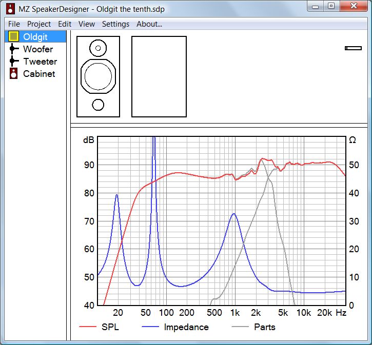

Given the circumstances I assume you need to run the tweeter at full level. Attached my proposal for a new tweeter filter. Just a try, of course. 🙂
Cheers and thank you, all of these very helpful options are being collated and will be offered to the guy I know.
It's obvious this isn't my area of expertise, I'll put up a couple of photos tomorrow that shows where I fit in to DIY audio
