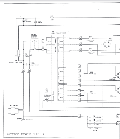

If I had a heavy duty (HC3200) RCF amp that is rated to 110v, would there be an economically viable way to change it for 240v input? Assuming there isnt a switch on the unit ive missed! I read somewhere its a transformer based amp, whether thats the same transformer, in any case it sounds like it might not be so simple...
According to the schematic, you can rewire the power transformer primary windings from paralleled to series.
