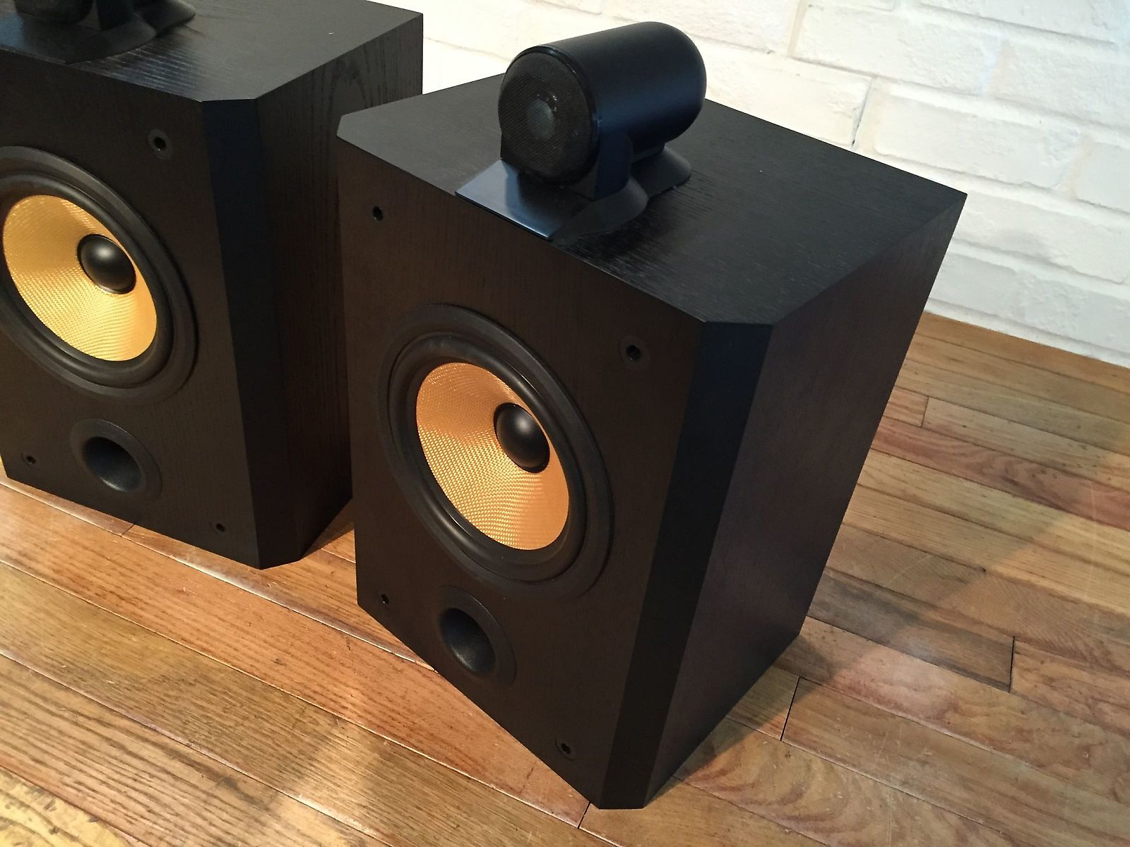

' Need to consider changing the exterior of my B&W Matrix 805 (yes, due to strong WAF headwinds). These are the original model from the '90s and AFAIK it should be real wood veneer (black ash) that is on. Options may be different veneer as well as good high-gloss paint job. Inquiring around I got confused if it may be possible to be done without ruining its appearance and function ultimately. Any experiences, advice, pointers ... are welcome. Tnx!

Seriously I don't think the character of the outer skin will affect the sound (duck!), so they could be filled, sanded and painted. I would only do this with the drivers and stuffing out of the box, though.

I changed to all white cabinets in my listening room and my Overture 3 speakers are black veneer. I used white contact paper (good quality vinyl shelf liner) and it works perfectly. Pretty easy to do and easy to remove without any issues at all. Its just sticky enough to stay in place and leaves no residue if you want to change colors. I just have to change the grill cloth to match...
Tnx. The reason I asked is that few builders suggested removing the veneer still leaves traces of glue in the wood, and thus good makeover results are less probable. Initially, I thought of high gloss white, but ... My latest thoughts were to use some quality vinyl (3M or so) and ask an experience car makeover master to wrap it!I changed to all white cabinets in my listening room and my Overture 3 speakers are black veneer. I used white contact paper (good quality vinyl shelf liner) and it works perfectly. Pretty easy to do and easy to remove without any issues at all. Its just sticky enough to stay in place and leaves no residue if you want to change colors. I just have to change the grill cloth to match...

In the old days, when I was young, think 50 years ago, I saw furniture/cabinet makers (callingb them "carpenters" would have been a mild insut) routinely replace worn/damaged/loose veneer by blowing steam at it , softening hide glue which was the classic adhesive used, repairing surface as needed (sanding/filling) and re-covering with new veneer.

Anyway, back on topic. The existing veneers can/could easily be steamed off and removed with a palette knife. Remaining glue can then be removed using a cabinet scraper - much better than sandpaper. Then maybe a new veneer, or a custom paint job. In the right hands, the speakers will be transformed. What you want is entirely reasonable and doable.

Is this the speaker in question?

Yes, that is the speaker type in subject. And the black exterior is the problem (e.g. white would be accepted).

A paint job would offer a myriad of WAF possibilities.

I asked some speaker builders here, and the mesaage was that with wood veneer on it could be quite probable to run into trouble (due to glue infiltration into the wood) - hence the question and if someone can shed more clarity.
Is it real wood or vinyl though?
If spraying there is probably no need to remove the covering, unless an oil finish has been applied. Any grain can be easily covered by several different filling methods.

B&W’s data sheets stated real wood veneer. I do not know the type of glue used, though.
