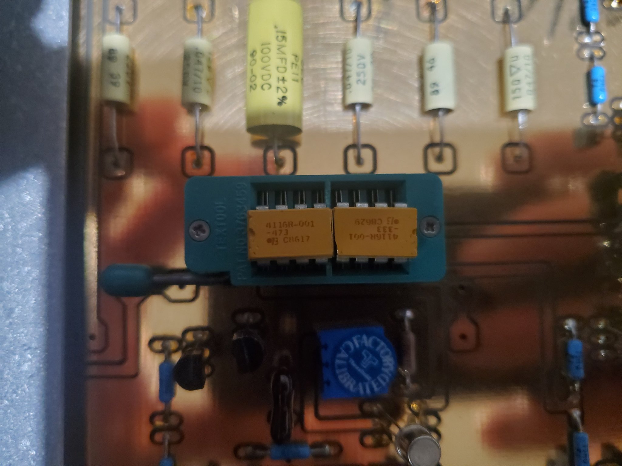

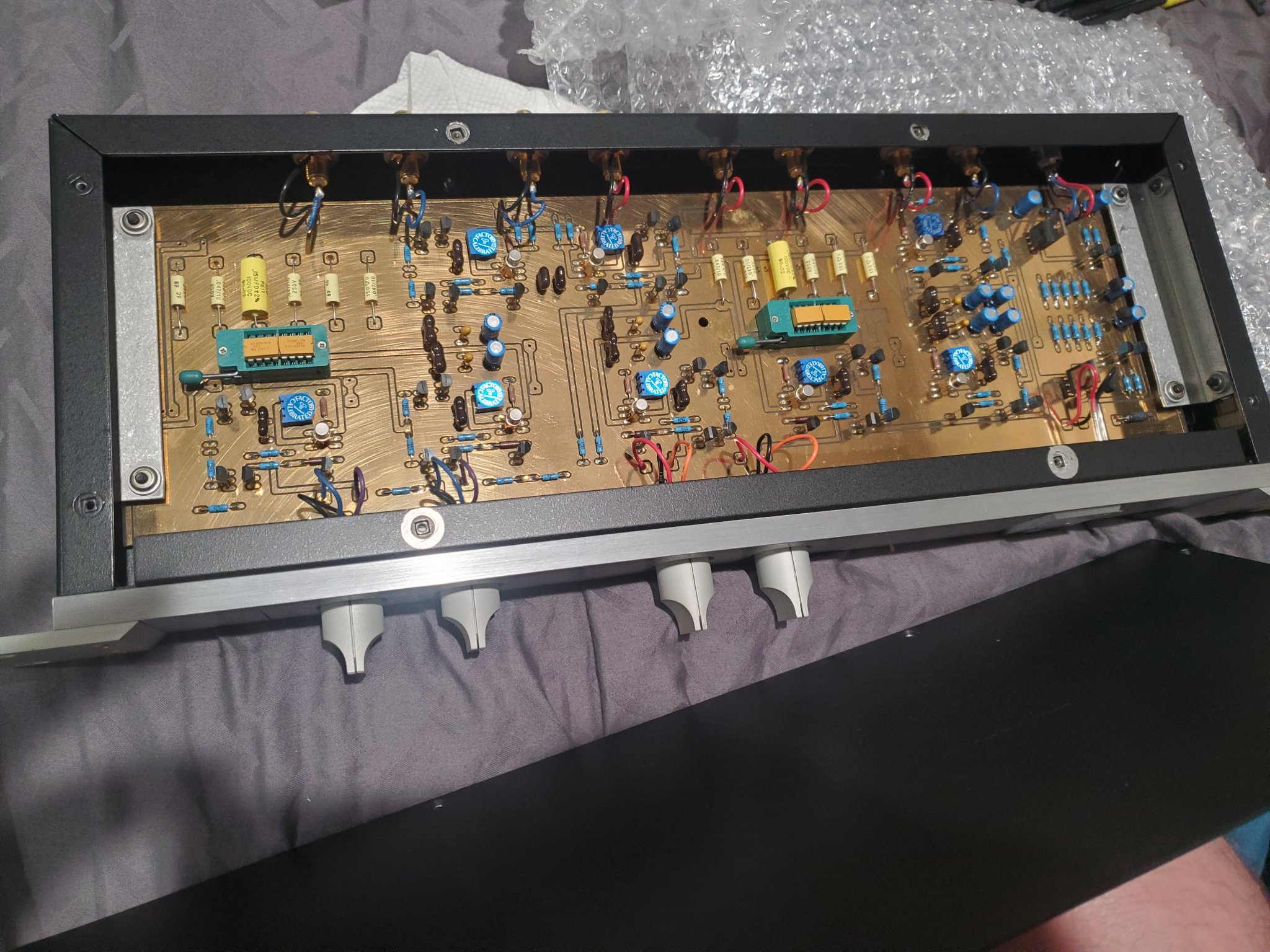

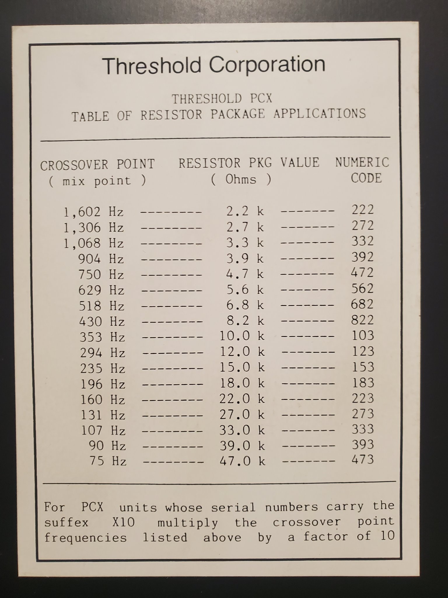

I picked up this pretty little crossover but I'm a little confused about the 16 pin resistor packages. It's marked on the back as being x'ed over at 7000Hz but inside are two 8-pin resistors with the suffixes of 333 (33 KOhms) and 473 (47 KOhms). I can't figure how that adds up to 7KHz using the chart. The resistors on the other side are not labelled at all
My question is: What resistor(s) should I use to crossover at 2000Hz?
I think the chart indicates a 18.0 KOhm resistor for 1960Hz
Would this 16 pin do the trick?
https://www.digikey.com/en/products...f77ol127A7ayZrFG9HJHknW2TLyVidzwaAl0KEALw_wcB
I would also like the option of crossing over at 2,500Hz which I believe would take 14KOhm resistor package. Can I accomplish this with two 6.8KOhm 8 pin resistor arrays?
