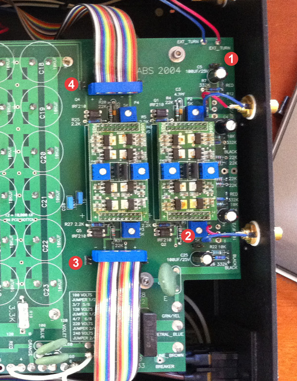

I am in a similar situation, I am currently building a pair of Linkwitz Orions V3.5 and thus require identical unbalanced gain on all amps used.
Thus far I have:
DIY Aleph 2’s 26db
X150.5 26db with jumpers answered above. (which are the jumpers that you are referring to?)
X150 (until I can afford another two .5’s, going to be a long time as we are expecting our first child after Christmas), however I am unable to find any literature apart from it being 30db. Is this balanced or unbalanced and hopefully there is a way of changing it to 26db unbalanced as the Orion ASP does not have an option for a balanced connection to the amps.
Thank you kindly for all of your help and dedication, may we all fill our homes with Papas projects 🙂
Happy Thanksgiving
Cheers, Greg

The gain is not jumper adjustable on that PCB version.
The pins by the headers are bias test points. We test with a connector.
If shorted by an errant probe it can be very bad.
The other pins with no jumpers on them are for DC operation.
Putting four jumpers here bypasses input caps.
Thanks for the info, all makes sence. It seems that the jumpers next to the input caps are closed thus bypassing the caps already.

You are correct the 2004 version had no gain jumpers. I also spelled Neutral wrong on that revision on the silk screen (Nuetral).
