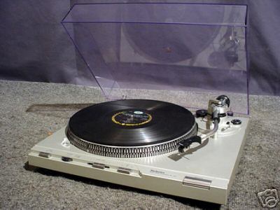

I want to change my old Turntable Stylus and Cartridges. I have a Technics DIRECT DRIVE AUTOMATIC SL-D32; but I don´t know if I can to buy any Stylus and Cartridges, because I lost the manual of this Turntable.
Can I help me, please?
Which are the best Stylus and Cartridges for this Technics Turntable, please?

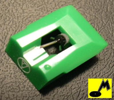

I can't find any reference to your turntable.
And I don't know what cartridges are available in Spain
or their relative cost.
Prices of brands vary quite a lot due to the importer.
I'd generically recommend an Audio Technica AT95E for the
standard typical Japanese S-shaped arm, the cartridge
usually costs barely more than the stylus alone.
(Only applicable to Europe cartridge model I believe)
£16 (16GBP) in the UK.
🙂 sreten.

http://www.musonic.co.uk/stylitechnics.htm
has the technics stylus for £28, I'd say a AT95E is far better.
🙂 sreten.
🙂 sreten.
http://www.mantra-audio.co.uk/mantraonline.htm
Prices for the AT95E are very good compared to elsewhere,
(£16 vs. £28.50) the cartridge is only £1 more than the stylus.
🙂 sreten.
🙂 sreten.

What don't you understand ?
The arm does not take P-mounts, standard 1/2" mounting.
Also note if you change the cartridge you need to know how
to align it correctly in the headshell - a web search will help
with this if you want to achieve accurate two point alignment.
🙂 sreten.

In my system optimised for CD, I found the Grado Black a trifle
dull. The AT's can be peaky at the top end, I think its caused by
too much capacitive loading, shortening the arm lead can help.
I like the Black, but TBH at £40 compared to £16 for the AT95E,
with little overall difference in sound quality (the technics tonearm
is a major leveller here) but differences in sonic tonal presentation
you have to go for the far cheaper option.
Technically speaking the cartridges stylus tips are near identical,
bushed 0.4x0.7 elliptical tip, manafacturing costs are near identical.
However the AT95E has a compliance (6.5cu vs 20cu) far more
suited to chunky Japanese S-shaped arms with brass arm tubes.
The Black can be a godsend to a bright system, conversely a
AT can transform a dull one - though loading is more difficult.
In the States its the other way round - a Black is $36 and a stylus $20,
whilst an imported AT95E is $80 (can be had for less) and a stylus $40.
🙂 sreten.

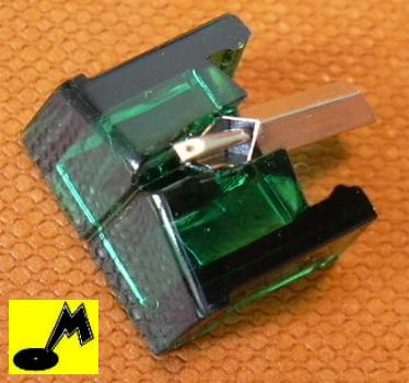

Technics SL-D3 Direct Drive Automatic Turntable
I have the manual, I printed it from a site on line and it says that the stylus for the TechnicsSL-D3 is EPC-P30. Ours was damaged in shipping and now I need to find a new one, do you have a source? You can get the manual at The Vinyle Engine,
http://www.vinylengine.com/library_model.php?make=Technics&selected_model=SL-D3
Let me know if you have a line on a needle cartridge. 😕 😕

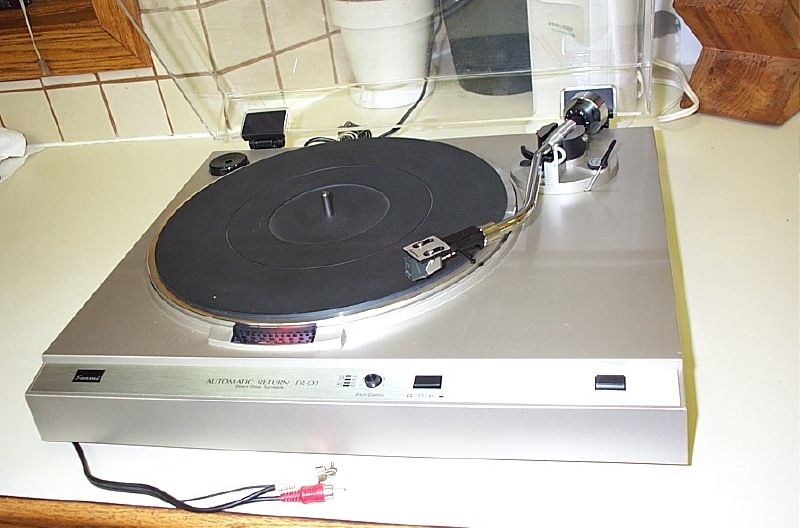

After killing my cartdrige last night, the only replacement I can seem to source localy is the AT91... would that be much worse than the AT95 recommended here?
The turnatable is a Sansui FR-D3 like this one
I think the AT91 is AT's dirt cheap special, its awful compared to the AT95E.
I think that is the model with the black plastic (carbon loaded)
cantilever, so it would be easy to tell by visual inspection.
If I'm mistaken and it has an aluminium cantilever, may be ok.
🙂/sreten.
