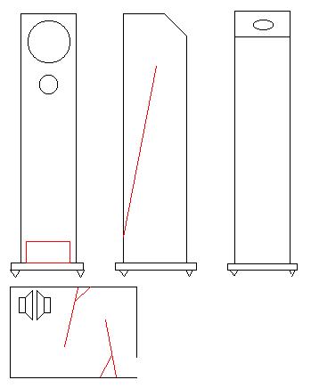

Thought I'd better put in my own thoughts...
The 170 and M0 in a TL or TP speaker...About 1m internally and 21cm deep and 16.5 internally (As found in one of Weems books)
A tweeter in the back (Maybe angled firing 45degs up)
Finally an isobaric TL sub to make a coffee table sized sub using the two 210s. This would require the other board though. On the plus side, no speakers would be visible on the sub (the way I like it).
Xover ought to be easy enough. Although tweaking and measuring would be needed
Gaz
I forgot to upload my graphical representation...
So hear (!) it is...
Gaz

nice drawings. the reason i suggested what i did was...
1. maybe I was mistaken but i thought u wanted to use only 1 board and keep construction simple.
2. bandpass sub is not such a good idea
3. your system will be 3db less sensitive than a 2.5 way system as there is no difraction compensation
4. my initial recomendation was bass reflex. i might give the sme F3 with a slower slope than band pass (I am not sure but you can use any software to see if it is true). Besides F3 is not the only criteria quality of bass and roll off is.
5. you need about 2 cu. ft. total to work a 170 mm in a sealed box and 210mm in a bass relfex box.
yes you see 3 of 4 drivers (the port can be rear firing) but you see only 2 boxes. I have used similar woofers in bandpass and had a lot of trouble.

I see what you're saying...It seems like a nice setup...I'll have to plot it up on Autocad...My quick drawings are just in Paint so I have no idea if their OK or not!

well a 2.5 way is nice.
i have spent some time working with difraction compensatio using passive components and found that something is lost (of course my expriments are with SS 8546 which are quite revelaing).
a 2.5 way seems simpler but does not offer the cylindircal radiation pattern of a MTM. since your drivers are not identical I eliminated MTM anyway.
Also given the T/S specs of the 210 it looked like a bass reflex design. I have built a few bandpass subs in the past and the only one that partly satisfied me was a 3 chamber 4th order bandpass using 2 Peerless 831727 (per channel) XOed active at 60hz to a Dynaudio Gemini.
I feel that was because the bandpass was working in a very small range Fs-60Hz. Hardly an octave.
Bandpass as well as aperodic loading are great alternatives in certain enviroments (the car or a disco are 2 i can think of).
I am not trying to disuade you but just trying to give you my experiences.
the rear tweeter works to create a sense of space. Thiel used to use this to good effect in the Type C. I find cone tweeters work well for this application.
